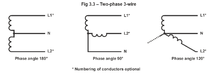

Glad to see I'm not the only one to call it 2 phase.
You should already know you're not the only one - as well as myself, you also have BS7671 as company :) ...
