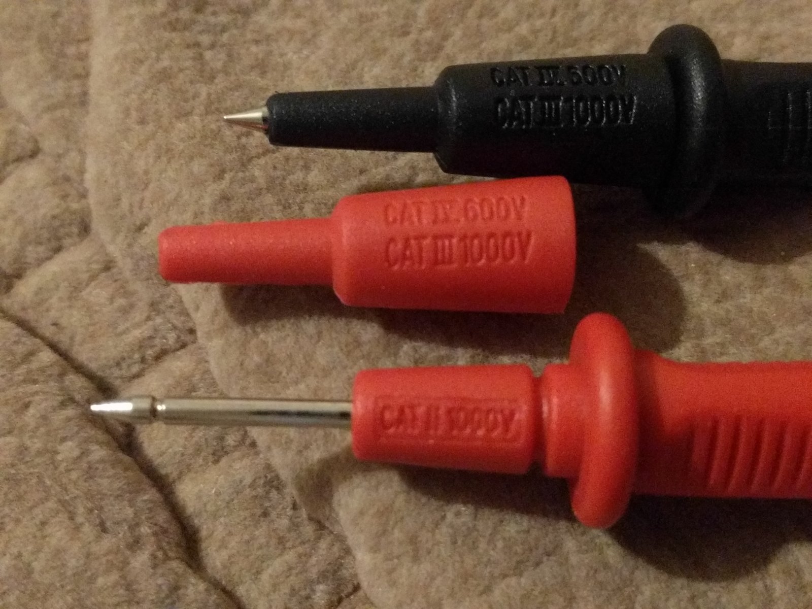

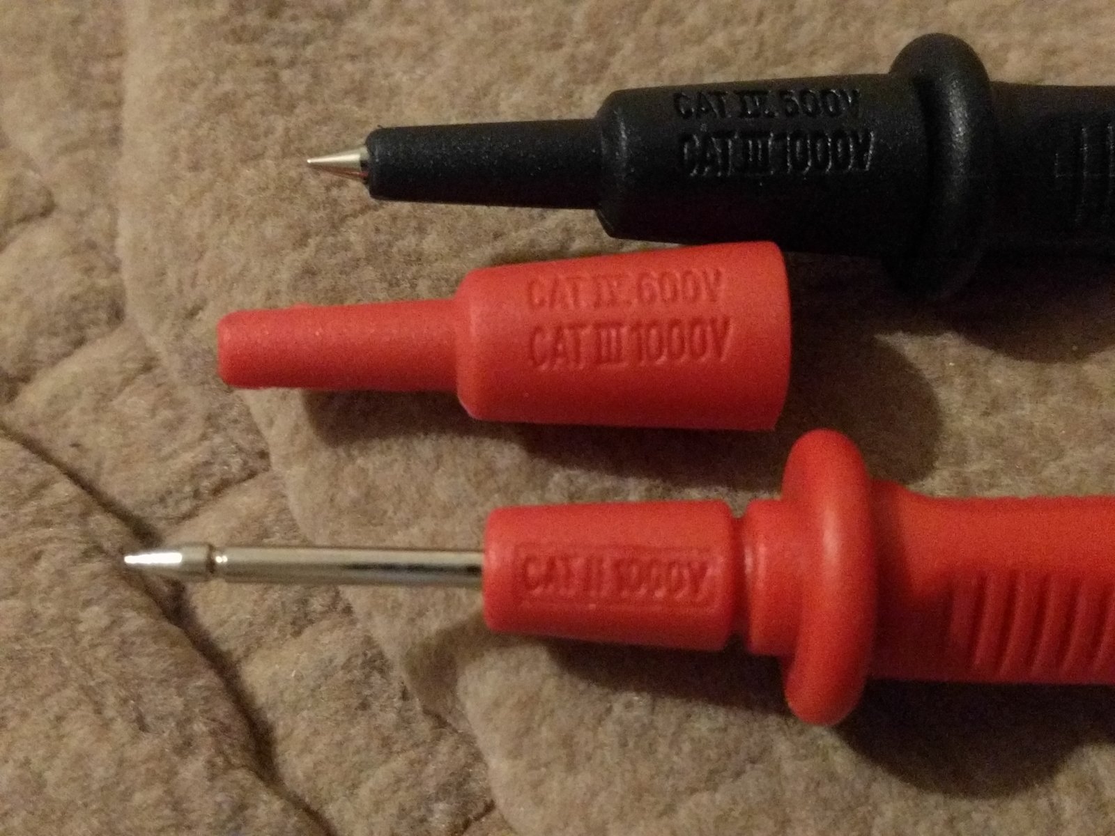

My leads can measure 600V cat IV with a tiny bit of exposed probe, but with the boot off the end they are 1kv CAT II.
That suggests that the lead is good for 1kv but there's something about covering the exposed metal that makes it safer to use on the dno equipment.
See the photo for one on and one off

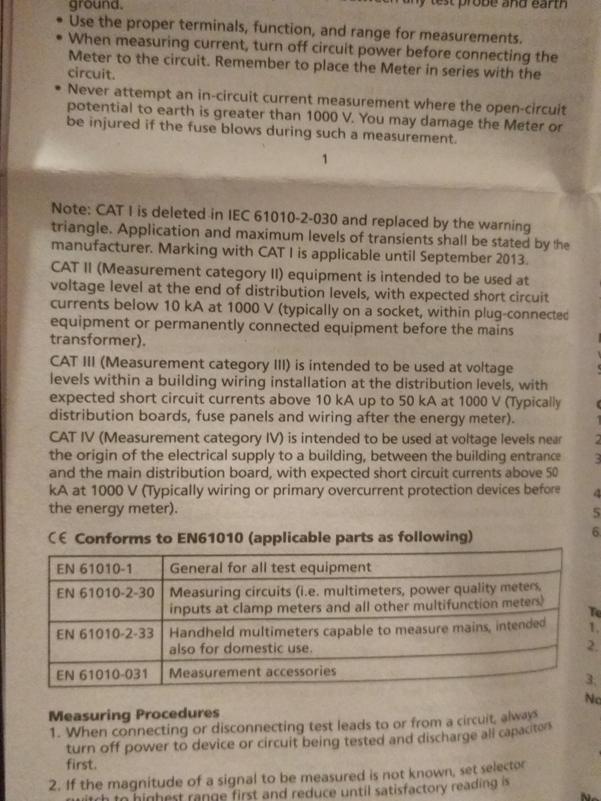

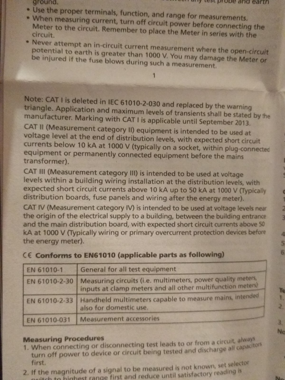

Interestingly in the instructions it says cat II is good for PFC up to 10kA, so maybe they are not worried on normal domestic installations after all
Well, daft though one may regard it, it appears that one has to regard the PFV of a domestic installation as being potentially 16kA.
If one has a type tested fuse CU and a cutout fuse 100A, it is allowable for the devices in the CU to be rated at only 10kA, but that's because the let-through of the cutout fuse deals with some of the 16kA - but it's still "16kA"!

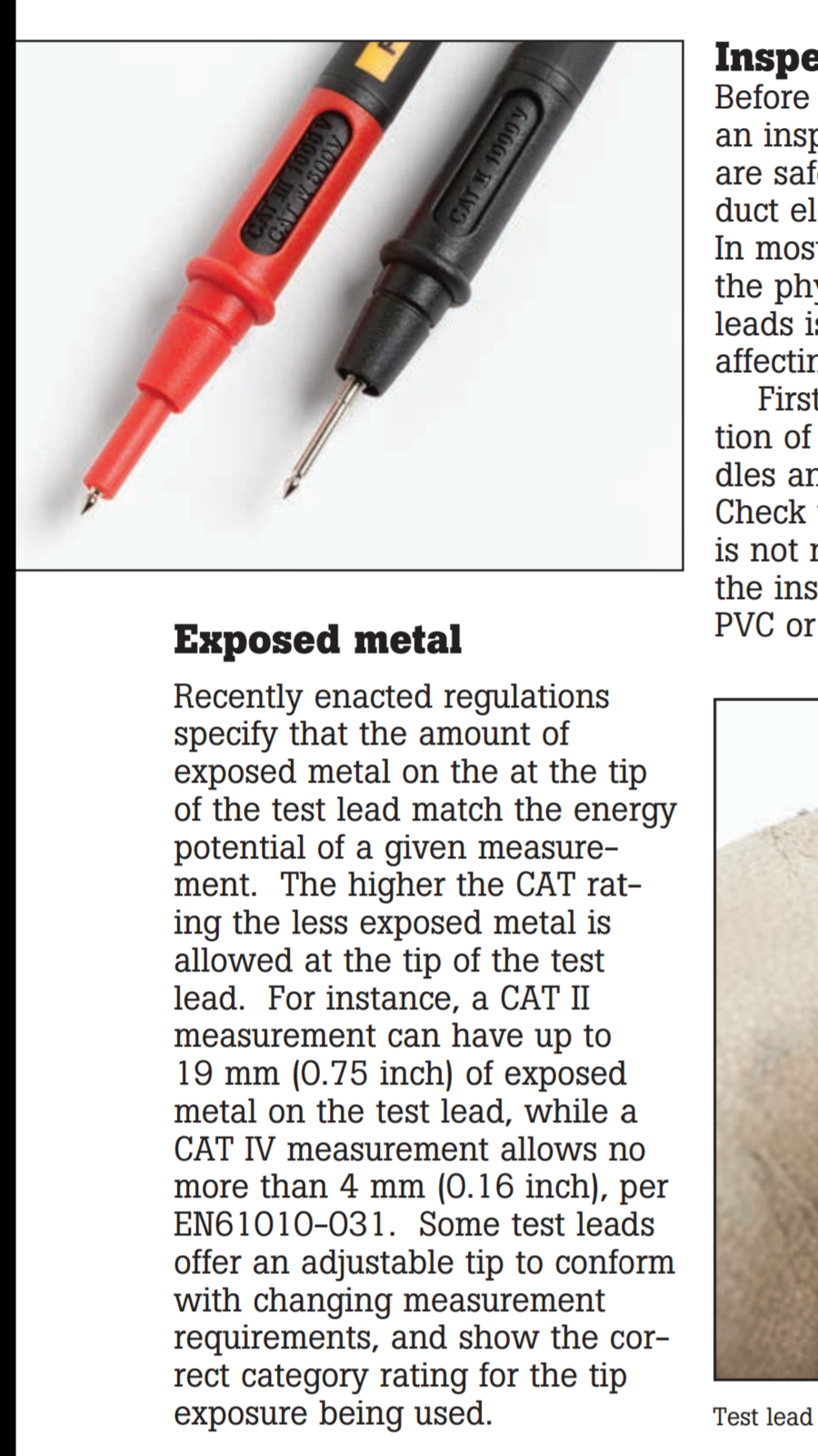

Seems a fair bit of information, this one has a lot and seems comprehensive, although not necessarily definitive
http://www.ecmweb.com/content/does-your-meter-safety-measure
This PDF from flue is quite helpful regarding leads (couldn't get the direct link on my phone, sorry)
https://www.google.co.uk/url?sa=t&s...FjAOegQIERAB&usg=AOvVaw1R4z_6VnG8ncrU7MPi-mgW
Interestingly they explain the whole removable tip thing without specifically saying why
This pdf explains the why very clearly
https://www.google.co.uk/url?sa=t&s...FjADegQICRAB&usg=AOvVaw01f6ZxFj_-x2SzHk1RyTO3
.... This pdf explains the why very clearly ....
Many thanks. I'll have a proper read. At a glance it is mainly about voltage transients. It also looks as if nothing in single phase domestic installations would ever be higher than CAT II, whereas parts of 3-phase ones (like mine and possibly the OP's) could perhaps be CAT III (even if that would not make a lot of logical sense to me). I'll try to remember to report back after I've had a read!
Kind Regards, John
... to add. If they are suggesting that there could be multi-kV transients at the origin of a domestic installation, large enough to kill the input circuitry of a digital meter, exactly how far into the installation do they think those transients can propagate - since I'm sure that most domestic premises contain plenty of electronic equipment at least as susceptible to transient-induced-death as are digital meters!
Kind Regards, John
I don't think they're worried about meter damage, I think they're trying to protect the person using the meter. See page marked 4 in the final PDF I linked. They are worried about things like arcs forming between exposed terminals but started by the meter.
