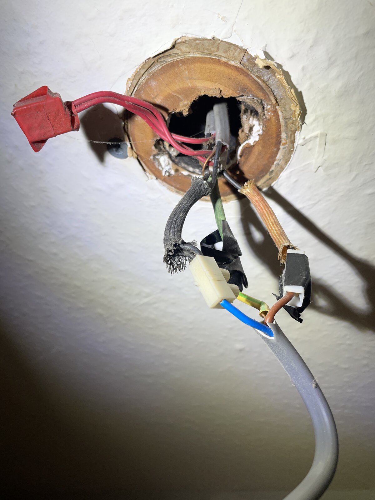

Hi dropping my hall ceiling height and changing from rose to downlighters. At the moment I have just used some connector strip to temporarily connect everything up. Now looking to finish it and close it up so I understand that I need a maintenance free jb rather than just a standard, if this is correct any links to Screwfix/toolstation or online please, this was at the start I redid it all with fresh joints and connectors?
I would say yes you do need a MF junction.
However it seams to be a very expensive game to get into.
having to buy a large expensive bag of the MF joints and then a box for them to fit into.
I haven't come across a starter kit yet, do just do one junction!
Won't this do the job? https://www.tlc-direct.co.uk/Products/ASJ501.html
Costs all of £1.82 plus the dreaded. Screw to joist and also has cable clamps.
