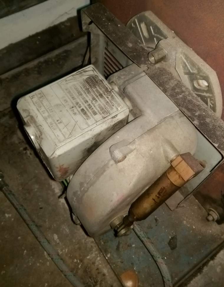

The Riello burner you have is still in production. It has barely changed in 30 years.
Which boiler is it attached to??

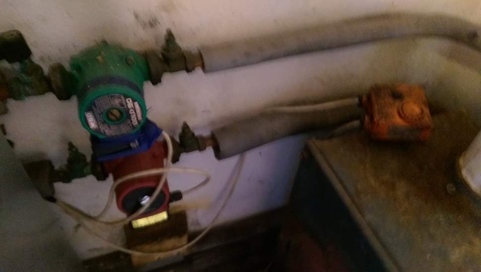

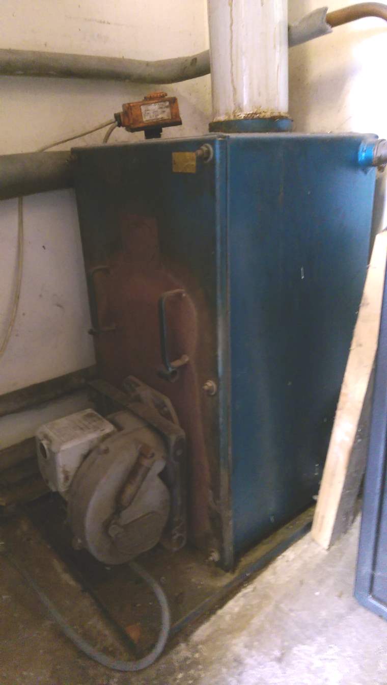

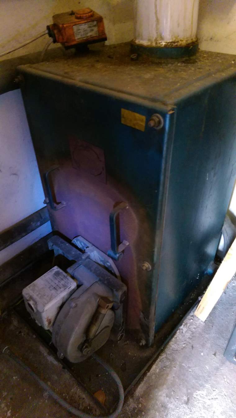

OK… sorry, was out and about there. I’ve taken a few pics with my phone, but its camera isn't great. There’s the remains of a yellow label on the big square thing (I assume that’s the boiler), but no trace of writing or logo left.
All I know is it looks ancient to me… thing is, here in N Ireland, there’s a decent grant (like £600 or maybe a bit more) available to replace boilers over 15 years old :love:
I’ll be ringing the plumber first thing in the morning, don’t know how long it’ll take him to become available to look at it – my instinct is to get it replaced if it’s old enough to qualify, but you guys may tell me different…
PS it does smell quite strongly of oil when running (not when off), but there isn't a pool on the garage floor or anything :confused:

So where are the photo's ??
Sorry mate, I'm absolutely exhausted. Here they are:
