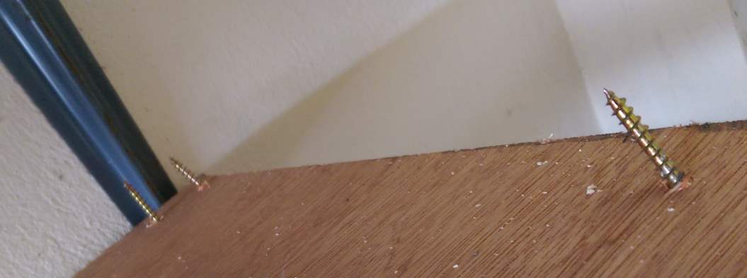

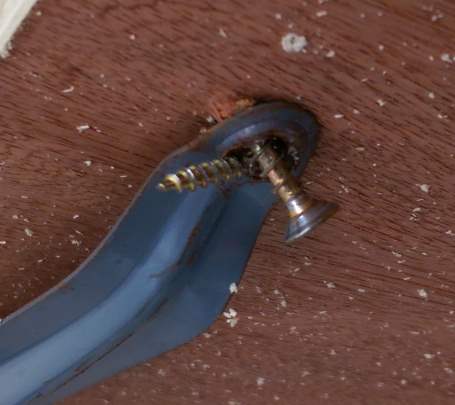

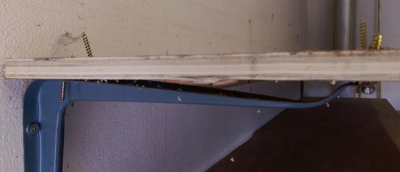

I've posted elsewhere here, but here's some shelves I removed today... gives you an idea of the mentality of the people who lived here before...
