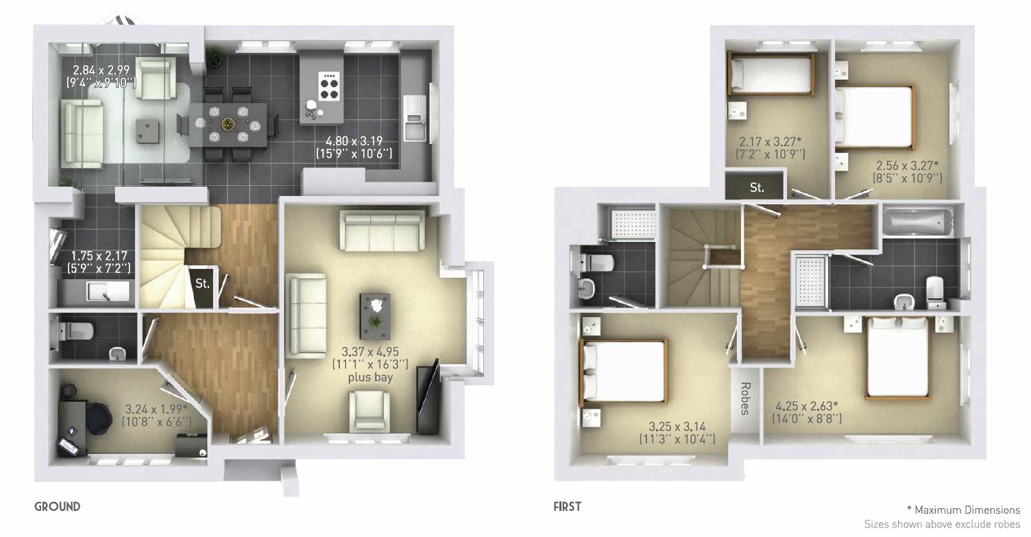

My original scenario is Energenie MiHome thermostat (TRV) is put on radiator in hall near to the front door, the wall thermostat is more central between the doors to other rooms, in the winter the wall thermostat never turns off, except when there is a reduction in temperature, so at 10 pm when both TRV and wall turn down to 17°C over night the wall thermostat will turn off the boiler. Most nights it will stay off, as the house rarely cools that much, so really the same as having a programmer, in the morning TRV turns to 19°C and wall thermostat turns to 20°C and the wall thermostat in winter will never turn off, so all control done by the TRV, and the boiler will modulate, keeping all rooms not just hall at the temperatures set, as you say the wall thermostat does nothing more than a programmer except on very cold nights when it will reactive the boiler.

I've attached a floor plan to (hopefully) help illustrate. The thermostat is on the diagonally oriented section of wall between the study and WC. The radiator is on the wall adjacent to the WC's door.
So it seems I have a few options:
1) Try reducing the LSV (or buy a programmable TRV) and rely on the programming of the thermostat to turn the boiler off.
2) Get a wall mounted air source heat pump (A/C) fitted on the external wall of the conservatory to reduce the temperature differential. I considered this during the summer but was put off by prices - maybe A/C engineers will be more eager (and competitively priced) for work in the winter...
3) Upsize the radiators in the kitchen/diner.
4) Put up with it (continue cranking the thermostat to 24C to get something approaching 20C in the dining area).
Thanks again.
