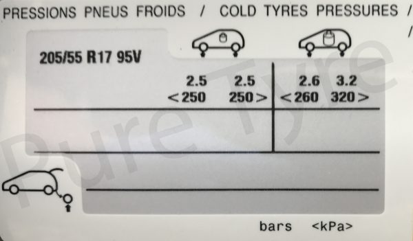

Tyre pressures, are dependent on load on the tyre, manufacturers list pressures in the handbook, for differing loads, and types of roads you will be driving upon.....
I am never sure how to interpret Citroen's loading pressure.
Normal loading is fine, but I find their "full load" hard to interpret.
Ford often stipulate 3+ and luggage etc.
But I'm never sure if this implies being closer to the max carrying weight of the car, rather then "3+ in the back and luggage" as that rear pressure is 46 psi, which is crazy high.
The "full load" figures are really just that. They're the recommended pressure for that tyre size, when the car is laden as heavy as it is legally allowed to be. They don't change as much on the front, because there's limited scope for changing the weight on the front tyres by loading the vehicle up. Most of the weight goes on the back tyres as you add people and luggage.
Iirc, my ev6 is 36 all round, going up to 40 all round when fully loaded.
That's an interesting thing with EVs, of course. As they're heavier, the percentage weight change between laden and unladen is generally less than with an ICE car.
