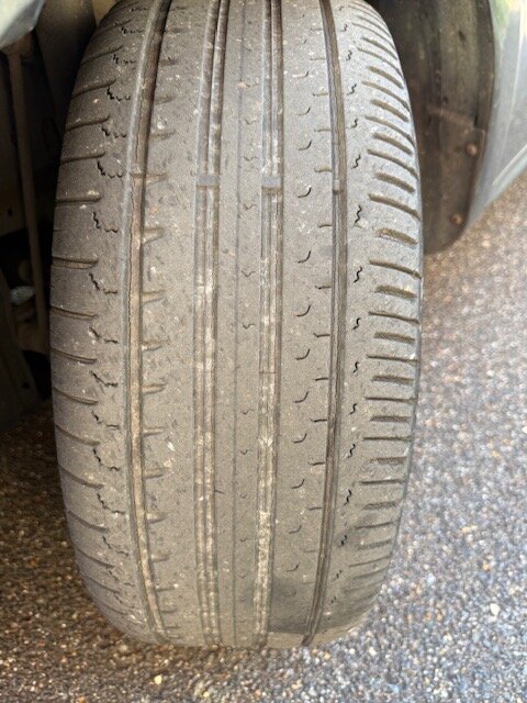

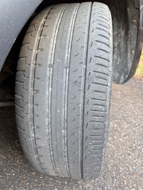

Please look at the pictures do the tyres need to be replaced? Would it fail MOT?

Impossible to tell with only a small part of tyre in view? Are tyre walls bulging anywhere? Any wall damage?
Last year MOT was in July, had advisory that tyres had cracks. Same as told in Dec when I had service.
Other parts of the tyres look OK, no wall damage.
One mechanic said reason for car vibrating around 65mph could be because of uneven tyres.
They are very close to the legal limit, looking at the wear indicator blocks.
I’d replace them rather than have the balancing cost to consider.
They are legal, but expect an advisory note....why wait?

If a new tyre is going to cost you £80 and you change them now instead of waiting until they are down to the minimum limit (not advised), you're only going to be chucking away a fivers worth of tread wear. Still, to answer your question, as long as the rest of the tyre is okay, there will be no problem with those tyres passing the mot.
If they are showing signs of cracking they need to be replaced or do you want to risk a blowout at speed?
The mid section seems to have worn more than the outer; are your tyre pressures correct?

If anyone asks that then the answer is yes, they should have been replaced already.
If they are cracked, they are old, and if they are old, they should have been replaced.
Would it fail MOT?
An MOT is the absolute bare minimum of standards which will just about be suitable for use in ideal dry conditions.
By the time a tyre 'fails' an MOT, it's long past it's replacement date.
