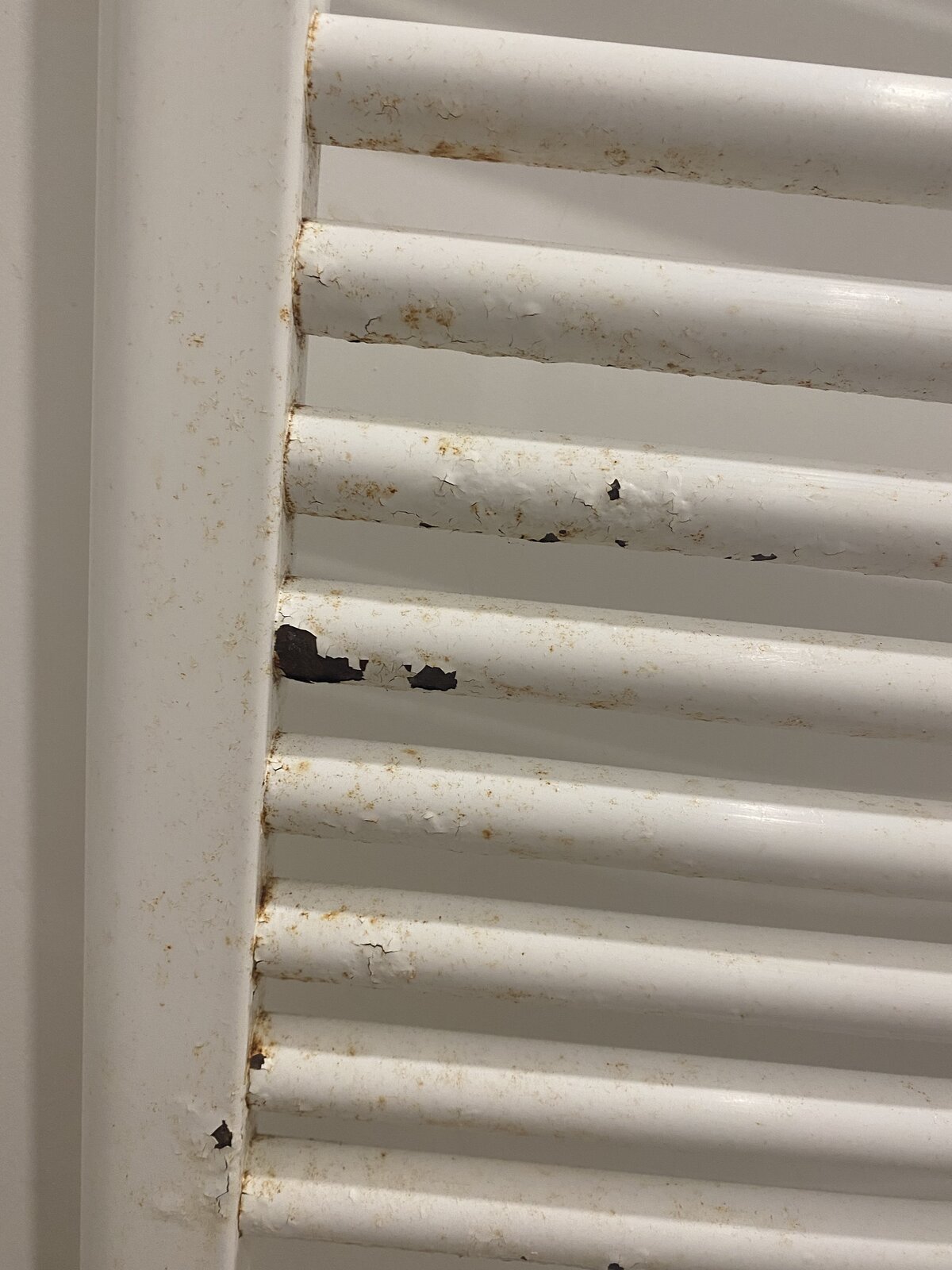

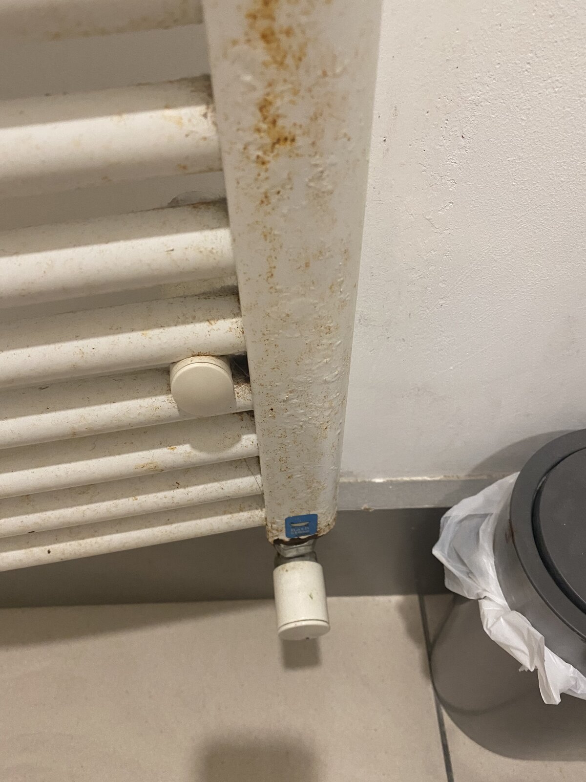

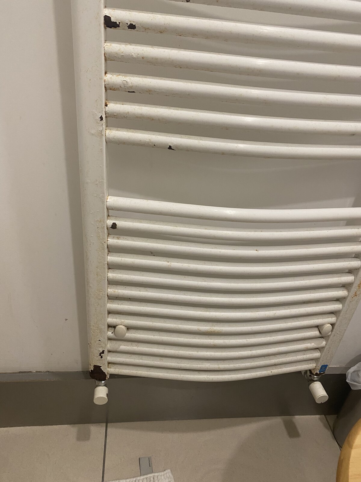

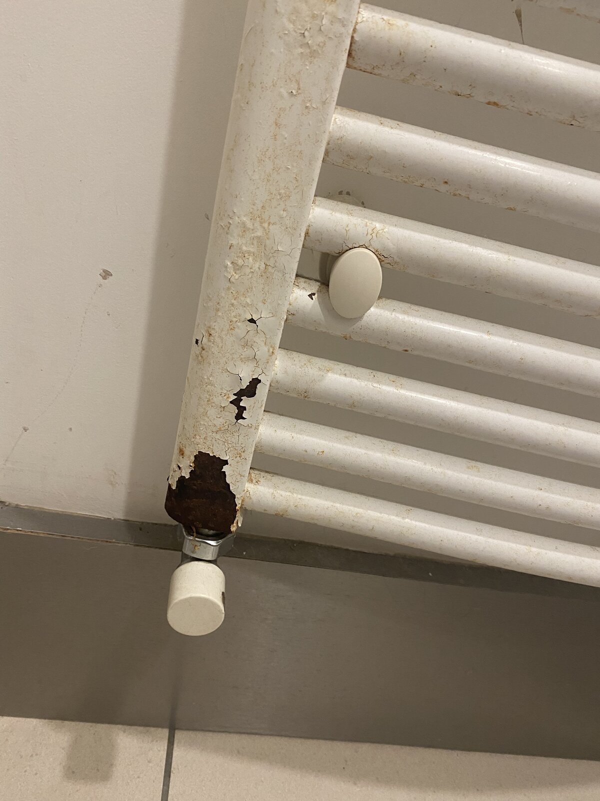

Moved into property and the bathroom radiator has what looks like a fair bit of rust on it. Is it salvageable or do I need a new one?

Dont waste your time or effort new one from screw fix less than 100 quid

As long as the inhibitor is up to scratch so it should be OK on the inside, it wouldn't be a big job to clean up the rusty bits and give it coat of Hammerite. Like new!
Does this kind of corrosion cause a leak eventually? I have a radiator (same type) that is in pretty much the same state. We're waiting for a bathroom upgrade but it will be after next winter.
In theory yes, but it would take a long time, appearance is more of a problem. If you clean off loose paint and rust and repaint it will be OK. I haven't used Hammerite for years but it used to claim you could apply it firm rust. Probably does. Worked OK on cars!
Check on the inhibitor, internal corrosion more of an issue.
