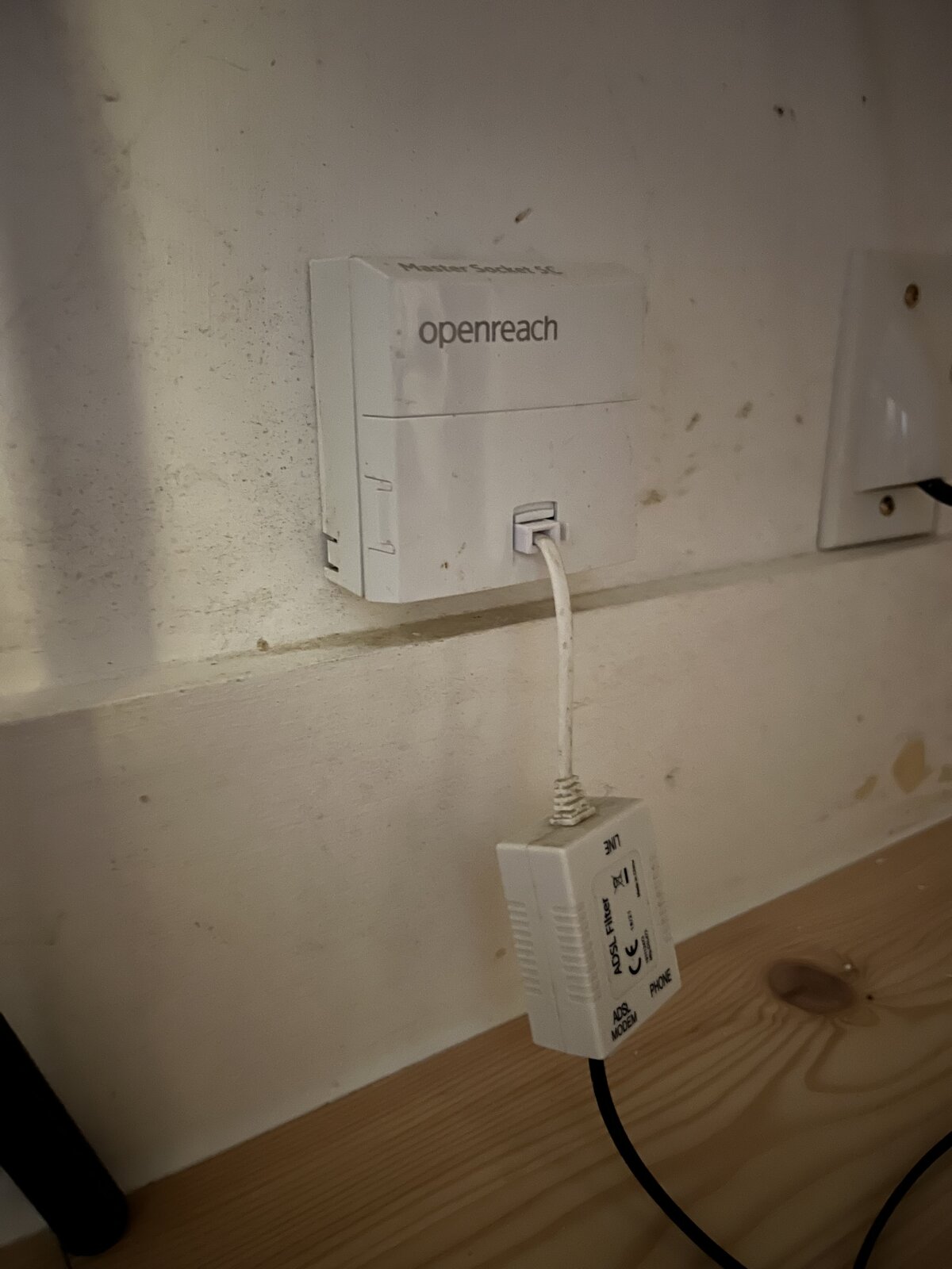

As image shows, I don’t have a landline phone so I’d like to plug my router straight into my master socket without using a micro filter. Does anyone know if this is possible and how?

What's the problem with what yiou have - just 'appearance'?
Yes, it's possible, you just need a cable with the correct ends, or replace the faceplate.
Difficult to get a cable. If it only has 2 cores
With only 2 Center pins on router end, you maybe in luck

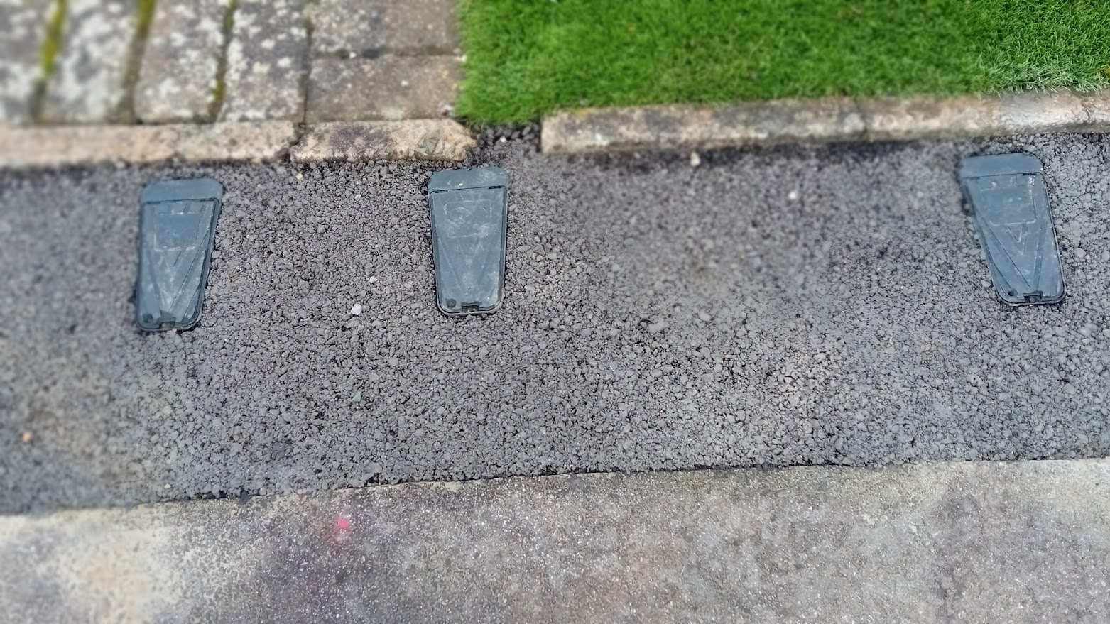

If it's just a cosmetic issue, I would not worry too much about it, because the suggestion is that this year - it will have to be replaced entirely by fibre....
That means that your incoming copper cable, and copper modem, will all need to be replaced entirely, by a new fibre cable. It's better to consider making the move early, and voluntarily, than wait and have to be moved to fibre. You can then take your time, and choose your provider - the cheapest, or best one to suit you as a customer.
I switched to fibre, just a few weeks ago.....
The cost of my copper 40Mbs ISP package was set to increase, so as always do, I looked around at what my options were, and found a fibre package deal, at 150Mbs at a cheaper cost. The installation, took less than a couple of hours. I was expecting lots of disruption, but it was all much smoother than expected. Depending on the area, the fibre can come across from the pole, or underground - the chosen ISP will tell you which way it comes in, as part of the booking.
https://checker.ofcom.org.uk/en-gb/broadband-coverage - will tell you which ISP's have a service to your postcode, and the speeds. I opted for Netomnia which is YouFibre, which is one of the cheapest, broadband only packages.

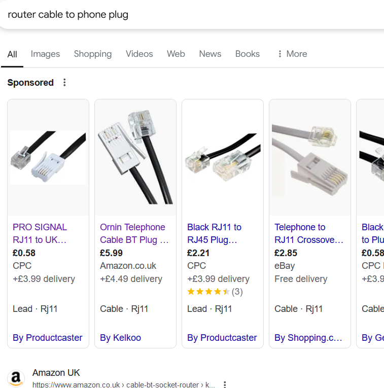

I would think the Ormin / Amazon would likely work. Others are a gamble
The shame is; they always used to provide such a lead with routers and I had a number 'in the drawer'. I'm only down to one now as I tend to repurpose such things.
What supplier routers ?
I've never seen one supplied. They are always RJ11 to RJ11. They discourage them as they can bypass using microfilters.
And when a phone is used on the line it will cause the BB to drop out
