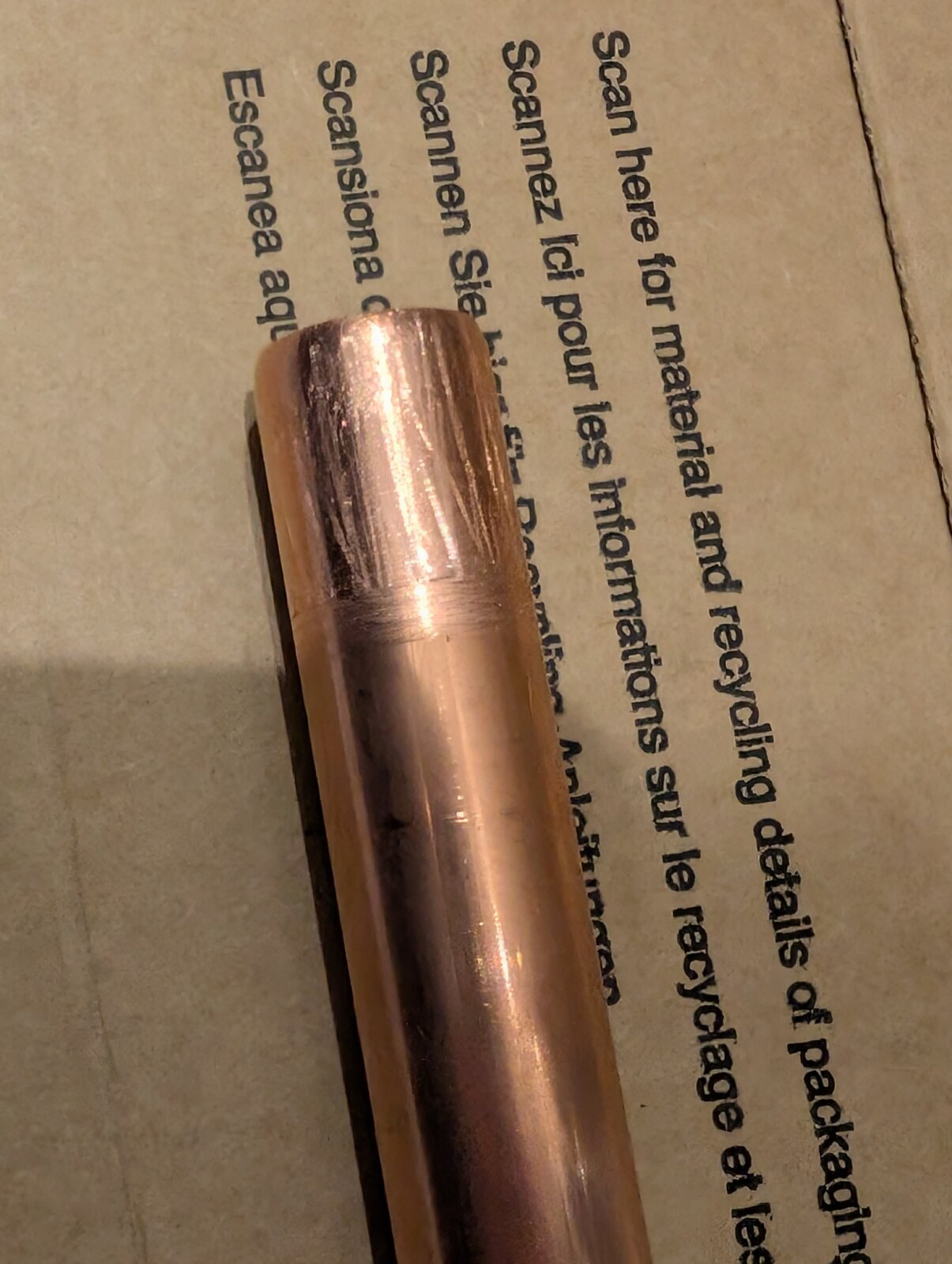

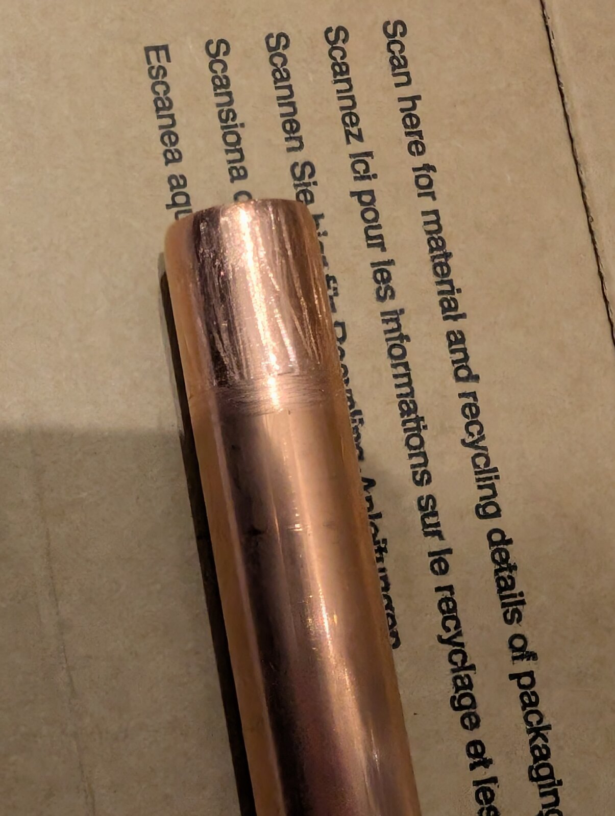

Hi just going to adjust a bit of copper that had a speedfit on. I have removed the speedfit.
Looking at the pipe its a little scratched from where the speedfit was pinching on and doesn't feel as smooth.
Can I reuse this section of copper and reuse the speedfit over it ? or should I cut it out so there is a fresh section of copper for it to grab to? Thanks
