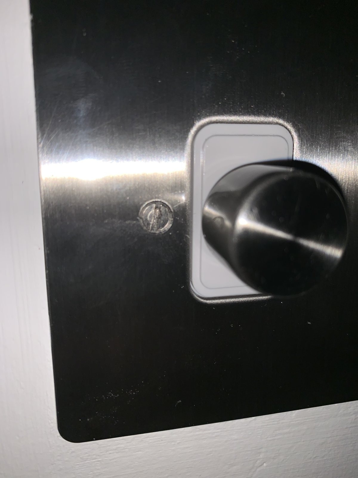

Hi, need some advice on what I think is a faulty lightswitch/wiring.
In our dining room, there is a 3 gang dimmer switch on the wall. Each switch controls the following:
1. A few downlights. This works fine.
2. Another 2 downlights PLUS lighting built into some wall-mounted shelving. The lights coming on and going off is unpredictable. Sometimes they come on and sometimes they won’t go off.
3. 3 x ceiling regular bayonet type lights. As we’ve only recently moved in I hadn’t got around using these yet but yesterday I tried a bulb and it seems to work fine.
I’m not an electrician but I suspect that the lighting in the shelving doesn’t like being connected to a dimmer switch. It doesn’t dim and it flashes when being turned on an off.
Is there any reason why I couldn’t just replace the dimmer switch with a normal off/on switch?
Many thanks

No, that's no good.
First of all have a look at your existing switch.
If the dimmers are separate switches (I think they will be) then take out the faulty one and buy one that looks the same but is just a switch - either a push on/off or rotary on/off.
Yes they are all independent - 3 separate modules. They all look like this one in the pic.
So you mean that I should try to find one made by Deta UK?
Not necessarily. pull off the knob.
Buy one that will fit in the space. A lot of them are kept in place by a nut under the knob.

Trouble is the white plastic behind the knob is designed to show through the cut out in the faceplate - see pic.
Yes I have tried the lights on another module and had the same results. I’m sure it’s that the shelf lights don’t want to be on a dimmer.
Ah. Sorry. That makes it difficult.
Only ordinary switches by Deta seem to be available.
