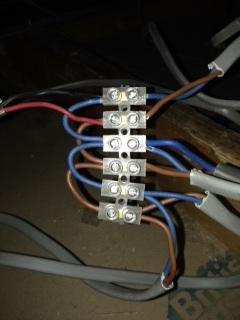

In the process of refitting our bathroom and decided to replace the existing downlights as they're looking tired. There are three 240v units, with a fourth 240v unit above the current shower that also has a 12v fan unit enclosed. I got a bit of a shock (pardon the pun) when inspecting the 'wiring' in the loft. I've put some pictures below:
This second picture shows in detail what was underneath the blue tape.
So it certainly doesn't look at all good, and most probably does not conform to any regulations. At the moment the main feed from the switch comes into the 'choc block' and the lights are daisy chained from that. To that end I've decided to replace the lot. However I'm confused on the best way forward?
Is it best to go for low voltage? I'm assuming I'll need the correct rated unit with a fan to use above the new bath that will have an overhead shower? With regard to the low voltage units is it better to have one transformer per unit, or one transformer rated to provide enough power for the four units?
I'm happy working with electricity as I do so at work often (HV and LV) however I'm not sure about domestic regs (I'm in Scotland) so if someone is able to advise on the best way forward in terms of units to purchase, and what wiring configuration to use I'd really appreciate it.
It's a surprisingly common (although it wouldn't know a regulation one got up and bit it on the arse) method. Probably the easiest way is to reterminate it in a Hager junction box. I'd also be inclined to clip the cables in place so they look neat and tidy. If you're really anal like me, you can use a rule to equally space the cable clips and then it looks like it was installed by an olde skool BT engineer.

My thoughts are to go with low voltage units and use a junction box to supply a feed to individual transformers (one for each Low voltage unit) However not sure if this complies with regs or not?
Well I've had another look up in the loft this afternoon and have disconnected three of the downlights and left just the one. Basically all I have now is a single live and neutral feed coming up from a one-way switch. I'm assuming this was to supply the original pendent type lamp that was in the bathroom before the previous owners installed the downlights.
What's the best way of moving forward with this now?

To answer a few unanswered questions. If you want to keep halogen lights, rather than LED, 12 volt types give a better colour rendition and have a longer life. You do need a transformer though, or more common these days a switch mode power supply. You only need one however, no point in having a separate one for each light.
If you want to go LED best to use 240 volt types. There is no advantage to 12 volt ones and you will have to get a special LED driver.
