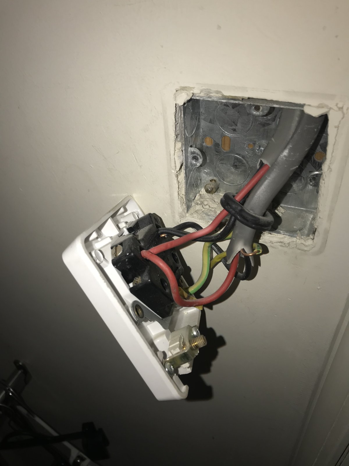

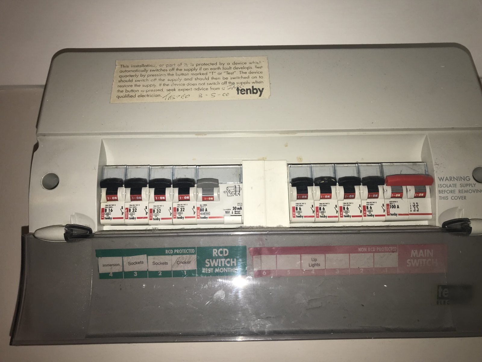

Just moved into a ‘new’ (18yrs old) house, and am decorating one room at a time. Went to change a socket tonight, turned off the 32A upstairs sockets MCB, as per the labelling on the consumer unit (photo attached). Unscrewed socket, went to disconnect the live and *ouch* - got a hell of a kick (screwdriver hit the wall on the opposite side of room).
Before anyone says it, my fault entirely - should have tested the socket was off before proceeding.
So after I’d thanked my lucky stars, and my heart rate had returned to normal, I did a bit of investigating and it turns out that half the upstairs sockets are actually on the 16A “Immersion” MCB.
The other thing worrying me is that the RCD did not trip when I got the shock - should it have?

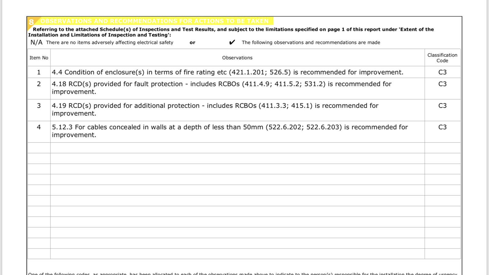

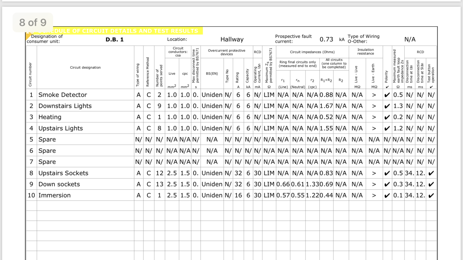

We had an EICR done before moving in, which came back as satisfactory, with a few recommendations (see photos).
1B5ACBCA-2AC2-46B3-875D-6920AA3633BB.png F3F6070D-2916-415A-9F3B-DB9A9A7EF2F0.png FC0D5A40-DD3C-4F85-8124-0F4490BAFDCD.png
So...is this normal, and should anomalies like this have been picked up in the EICR?

As with another thread in which the householder was unhappy with the arrangements, all that was wrong was the labels on the consumer unit.
Check what goes off with each MCB and make the labels accurate for the future.
Items 1,3 and 4 on the the list of 4 reccomendations seem to just be stuff about newer versions of the regs, I wouldn't be unduly worried about them. Item 2 strikes me as very strange, on a TN install there should be no need to rely on RCDs for "fault protection".

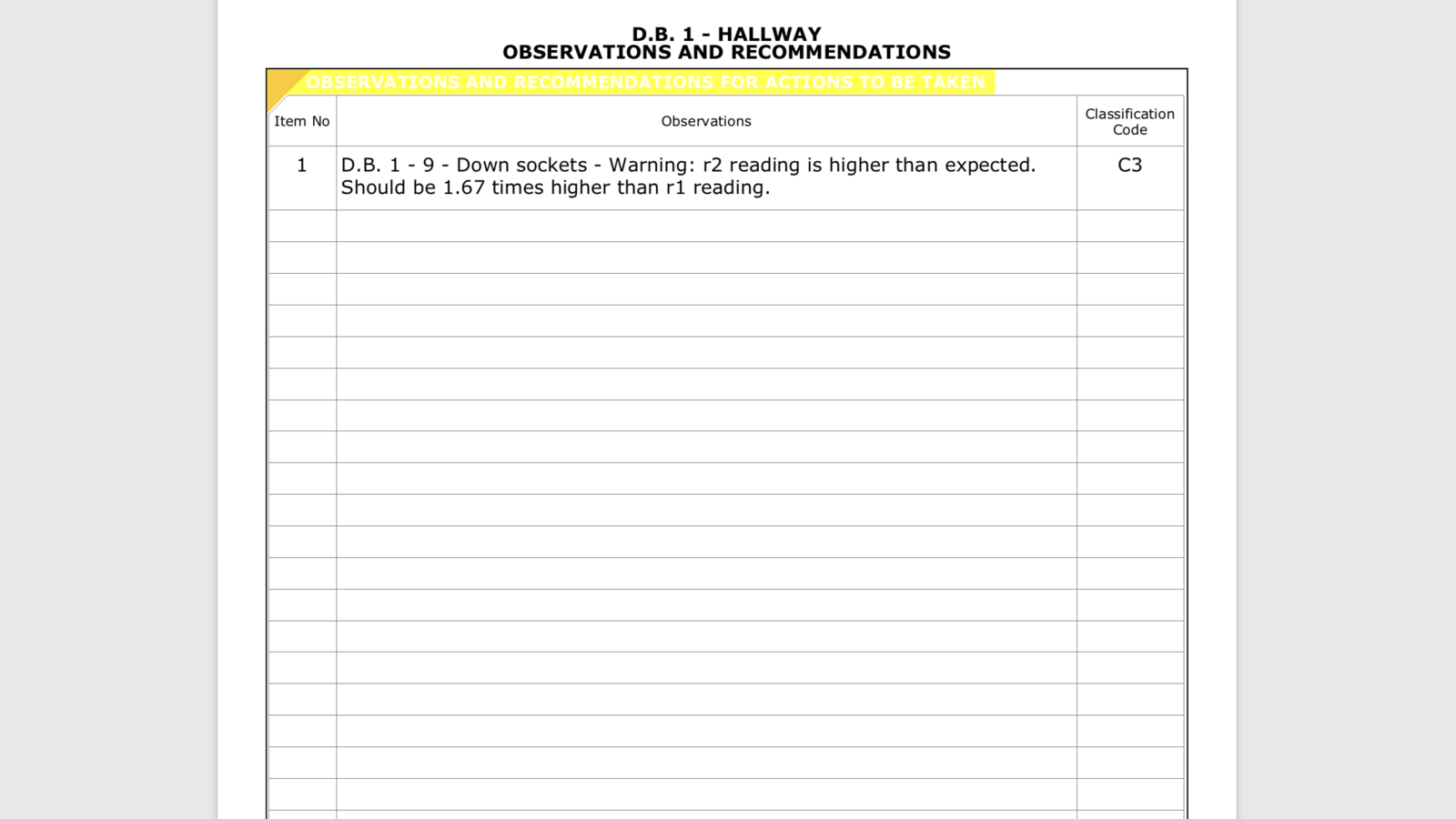

As for the item on it's own reccomendation list that could just be the type of cable used. 1.67 is the expected ratio for modern 2.5mm² T&E but other cable types can be different.
There seems to be a mistake in the circuit schedule, fields that only make sense for rings are filled in for the "immersion" circuit but not for the downstairs ring.

Perhaps I have missed this flicking through, but the EICR states there is only one point on the immersion circuit.
Surely this is wrong and puts into question the rest of the report?
This is my concern. Hmmm

Ok so did a bit more digging, and it turns out that, with everything switched off, switching on EITHER the 32A upstairs sockets mcb OR the 16A Immersion mcb will energise all upstairs sockets (as well as the old immersion switch in the airing cupboard).
The term WTF comes to mind!
Obviously there’s something connected somewhere that shouldn’t be - but where would that likely be, inside the CU?

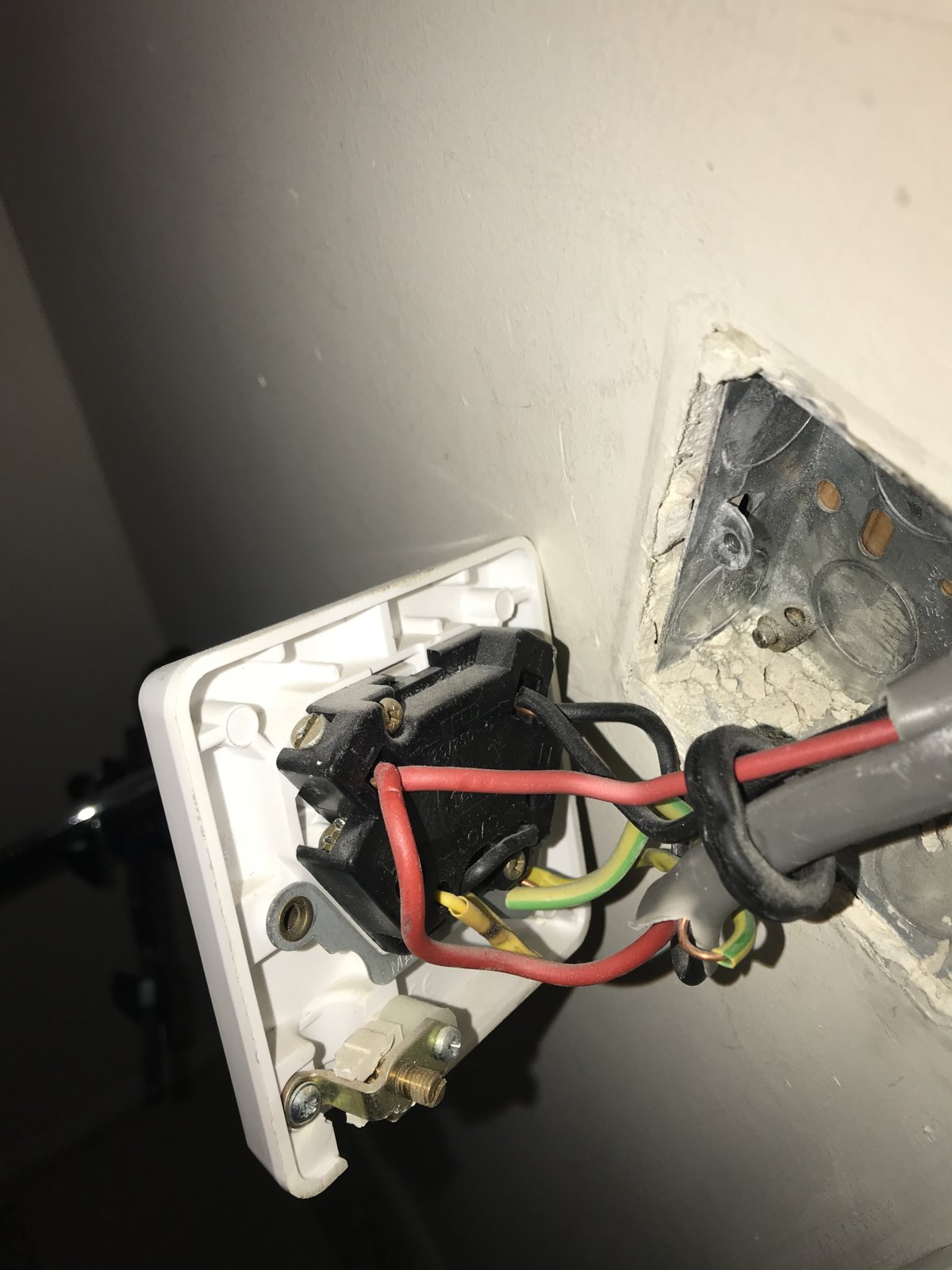

Behind the old immersion switch there are two 2.5mm t&e’s, both connected to the “feed” side, nothing attached to “load”. With either breaker on, one of the live wires is at 230v and the other at zero. Wouldn’t the immersion circuit have been a radial? Is yes, where does this other cable go to/come from?
0FF4C265-6EB7-4E56-A0C5-FBC763298CC6.jpeg FAB100A5-C45B-4DEA-8042-6331B0C911E7.jpeg
Oops. Good odds someone at some stage (possibly when doing the EICR) has mistakenly swapped 1 leg of the RFC onto the old immersion heater MCB in the consumer unit. V poor.
Bit of cable tracing is going to be required- power off, lid off consumer unit, identify actual T & E pairs, determine by low voltage metering which bit of T & E goes where (easiest to ID initially will probably be the immersion heater pair)
EDIT Good odds there's a socket (maybe in the loft) hung on the old immersion heater circuit
