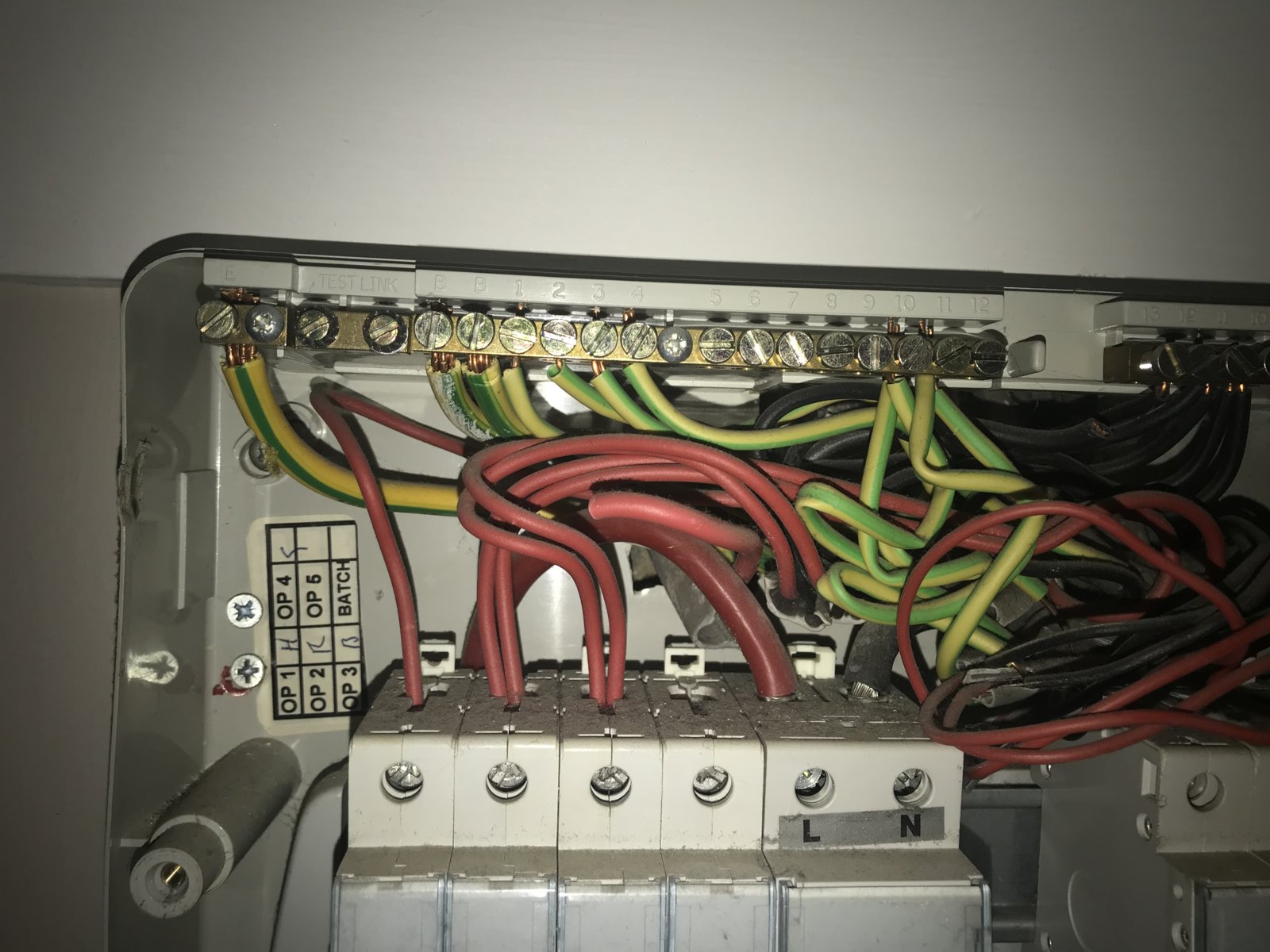

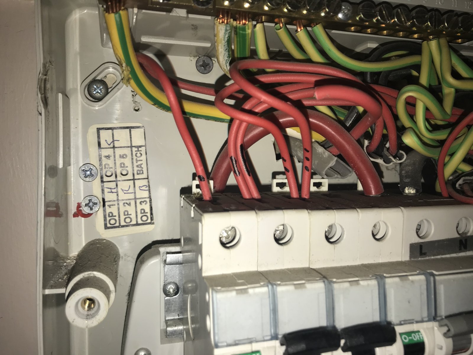

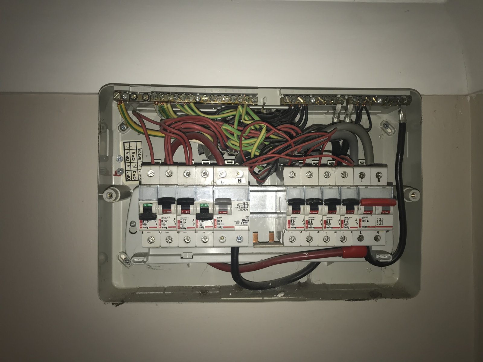

Yikes. It may be well worth going over the whole install to see if there is anything else......
Indeed, it is clear that the person filling out the report did not realise that the sockets were on the immersion circuit.Perhaps I have missed this flicking through, but the EICR states there is only one point on the immersion circuit.
Surely this is wrong and puts into question the rest of the report?
I have to leave those who do EICRs to answer that question but, as a general observation, 'assuming' anything is always ill-advised, and I would of thought that assuming that CU labelling (quite commonly wrong!) is correct would be particularly ill-advised!Is testing every point to determine what is actually on each circuit a normal part of an EICR or is it normal to assume as this guy clearly did that the existing labelling is correct?
Bit of cable tracing is going to be required- power off, lid off consumer unit, identify actual T & E pairs, determine by low voltage metering which bit of T & E goes where (easiest to ID initially will probably be the immersion heater pair)
EDIT Good odds there's a socket (maybe in the loft) hung on the old immersion heater circuit
The evolution is working.and I would of thought that...
The socket in the loft off the old immersion heater feed is a guess- when the hot water cylinder was binned off someone probably thought 'there's a handy 16A supply there all run in- I need power in the loft for the Sky box/train set/hydroponic setup, that'll save me spurring off a socket & having to do a load of chasing'. I did similar when I put a combi in the old house- put a socket on the landing (on the outside wall of the airing cupboard)- made hoovering a lot easier. EICR picked up that it wasn't on an RCD (bad lad) so rectified that).What makes you say that mate? (About the socket in the loft) and why would that mean the circuits are joined somehow?

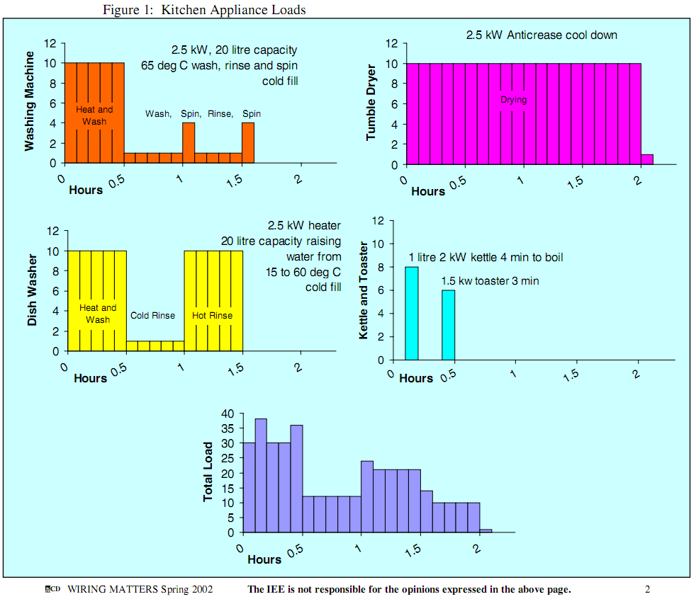

Just to me a 3kw oven on the same ring as a washing machine, tumble dryer, dishwasher and kettle seems a little excessive?
