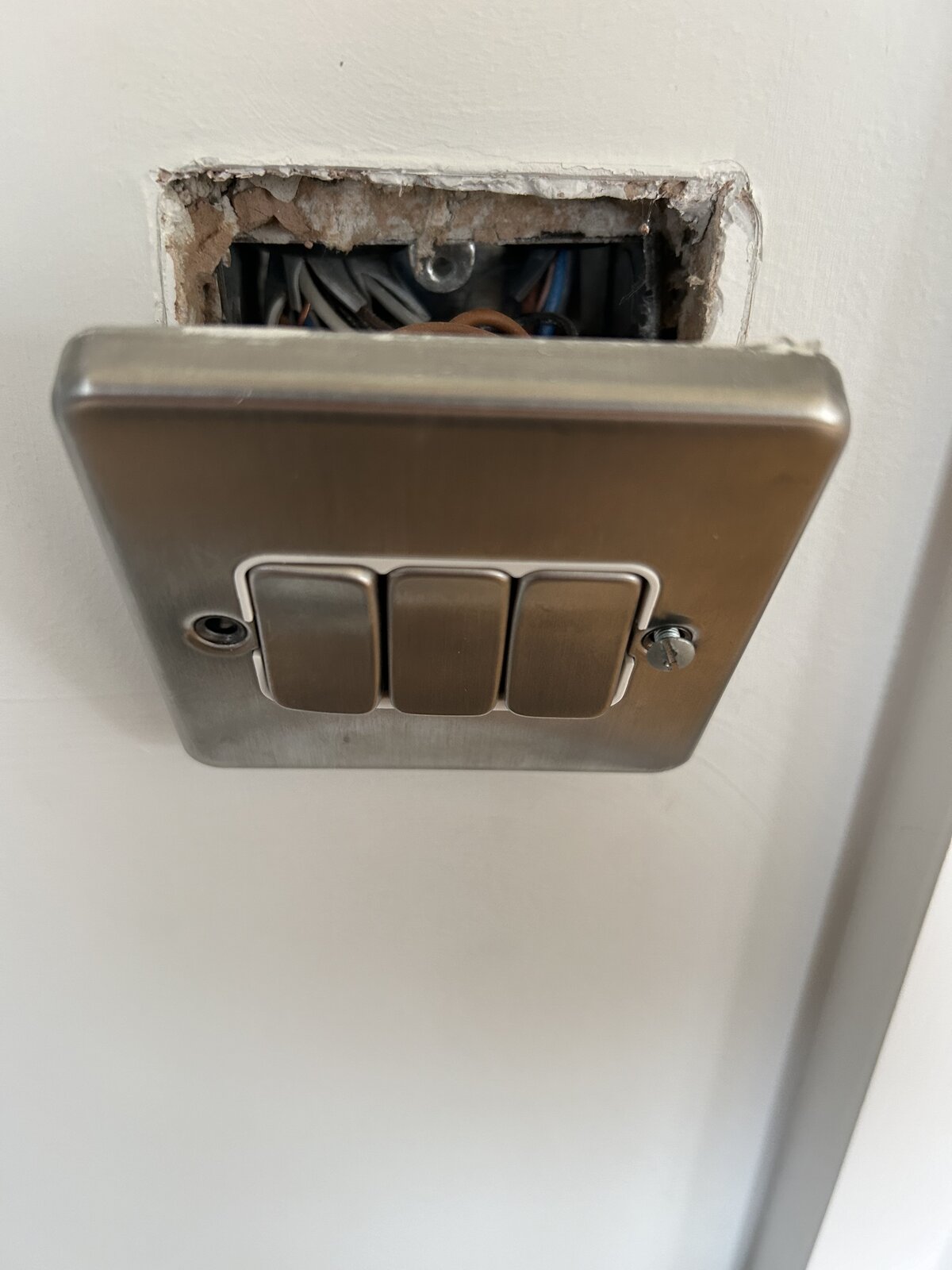

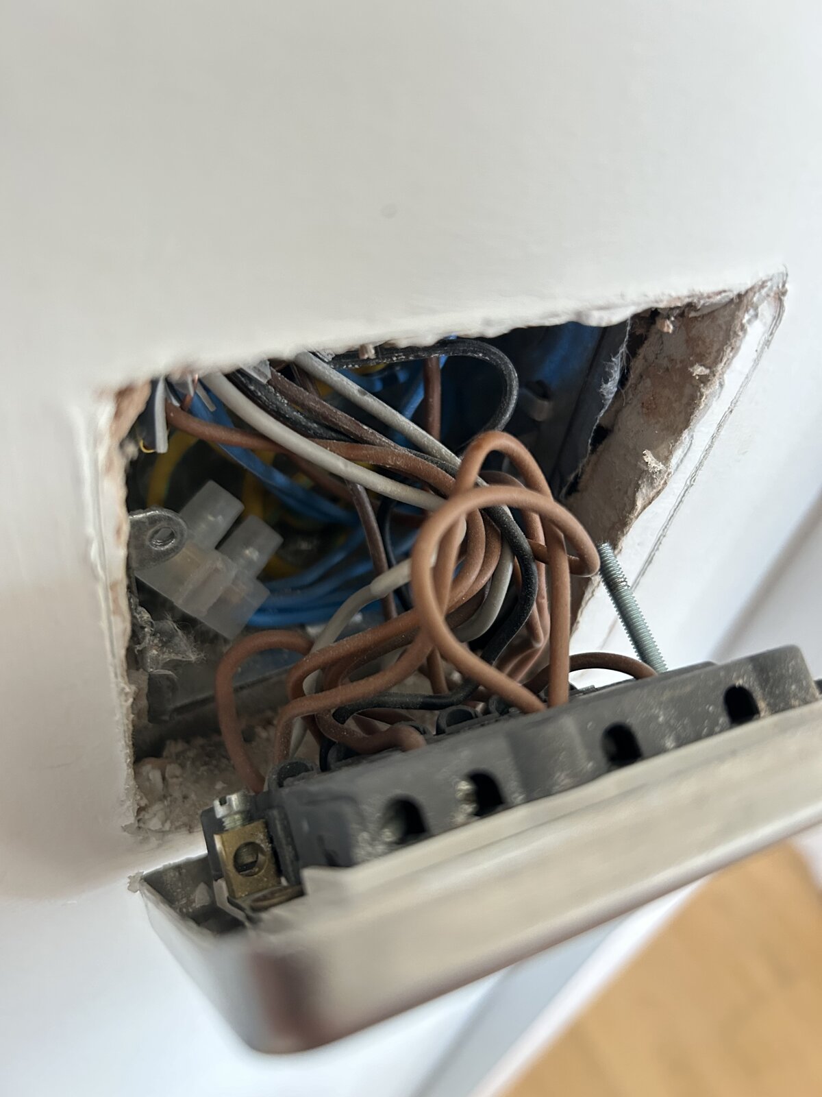

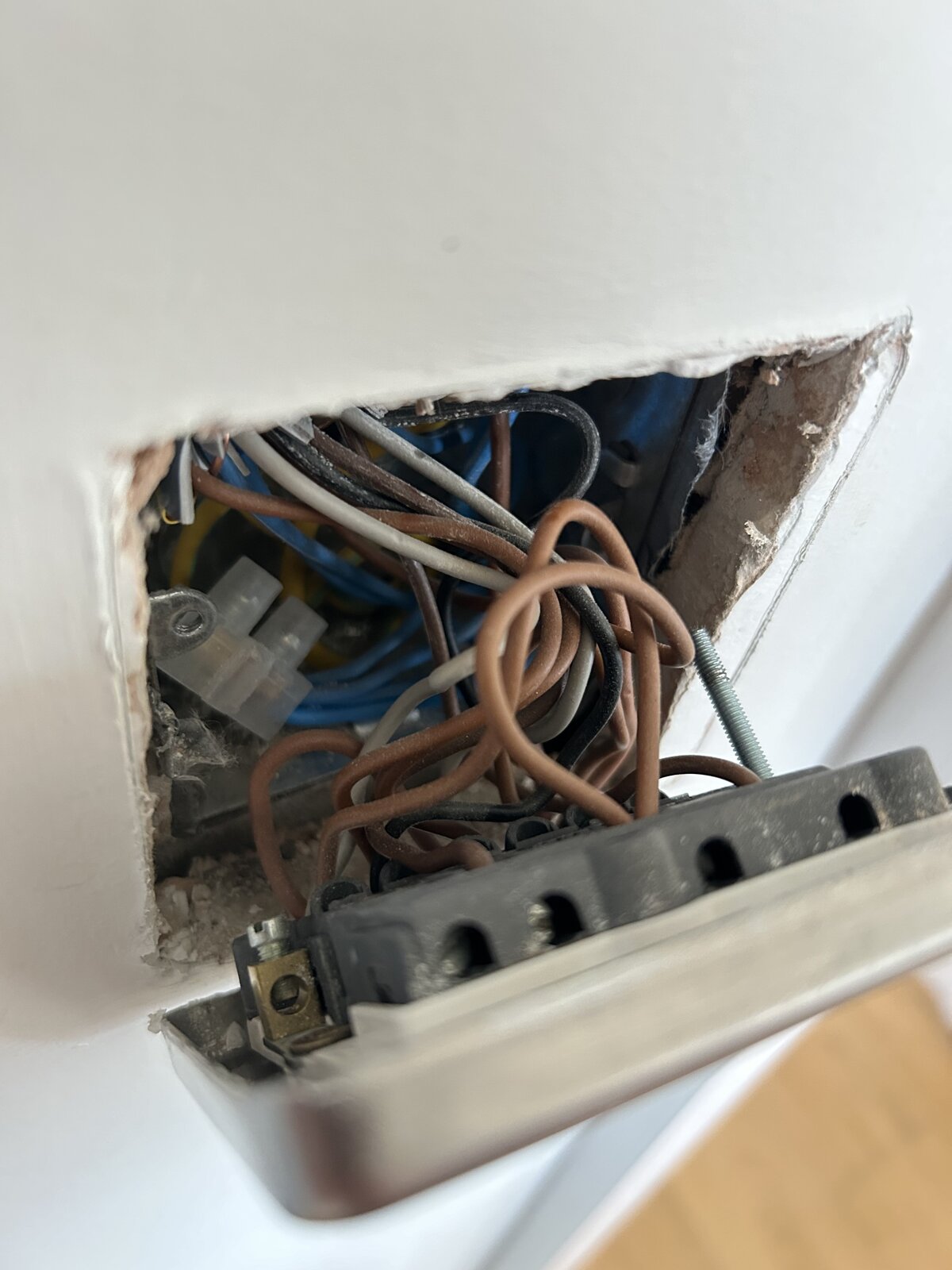

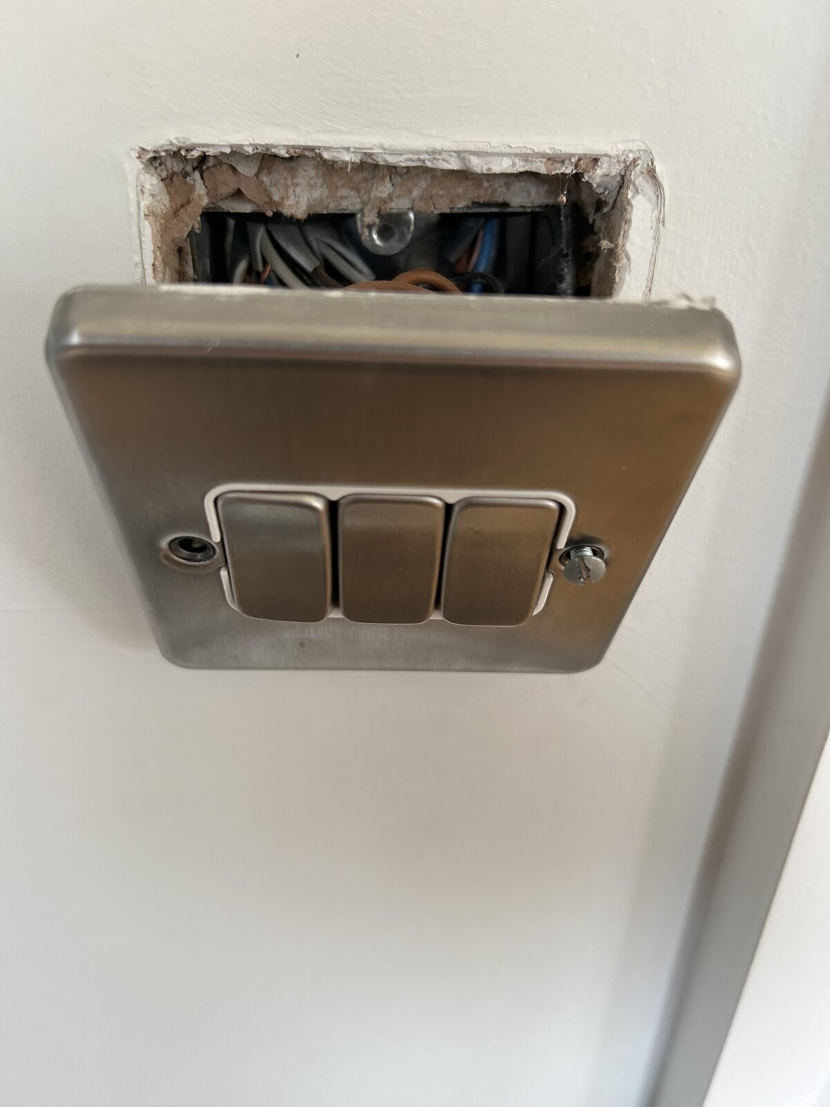

Looking to replace a 3 gang light switch in my kitchen that sounds like it’s been arcing / crackling when a switch is used.
Took the screws out to have a look this morning and noticed that the switch faceplate is not earthed - the earth wires all seem to terminate at the back box.
Is this ok? Or should the face plate it be earthed to the back box too?
I’ve attached a couple of photos.

The faceplate must be earthed.
I wouldn't describe it as "being earthed to the backbox". It must be earthed to earth.
The arcing/crackling is likely a separate problem.
It certainly should be.

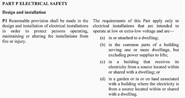

It MUST be Earthed. It's nothing (directly) to do with Building Regulations - it is Wiring Regulations.

The faceplate MUST be earthed - the backbox doesn't have to be even though they will be connected by the screws.

It is to do with The Building Regulations as I would say they have not complied with Part P - the actual Part P itself (not a book someone wrote about it) - the only actual law relating to electrical work.
Ok so for this switch in particular, that I was hoping to replace today, is the quickest way to make it safe by taking all the earth wires that are terminating at the back box and attaching them to the Earth connector on the faceplate?

That's why I stated not DIRECTLY to do with Building Regulations as the Requirement arises out of the Wiring Regulations. Yes I agree that is the faceplate which is more important to Earth if that wasn't clear from my remarks (and ideally also a link to the backbox from the faceplate (with the connections being at the faceplate end)).

If the Earth in sockets has been taken to the back box and not to the Earth terminal on the socket then that error must be corrected as soon as possible.
If that error exists then in the event of a fault in an appliance the Earth current will have to flow from socket to Earth through the fixing screws. This may limit the fault current to a level that does not trip the MCB but does cause significant heating in the back box.
