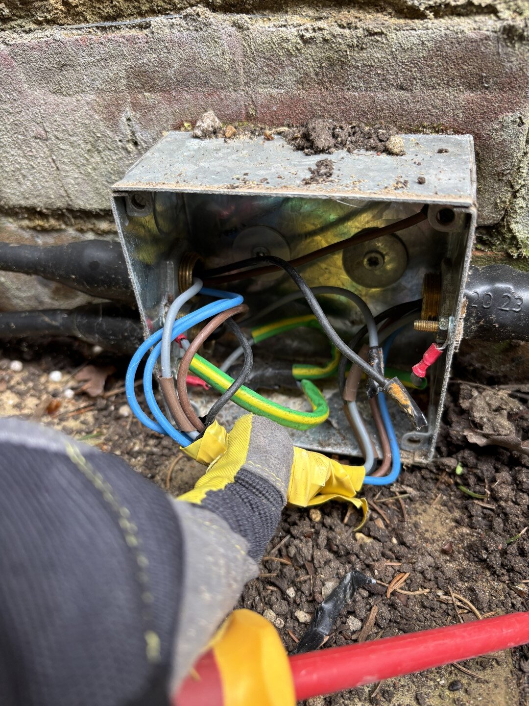

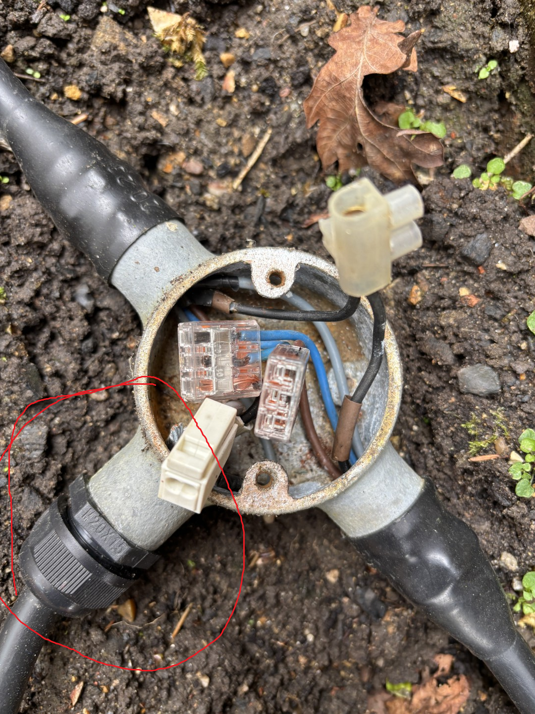

In my house's side passage I have a metal junction box just above the ground.
The external lighting comes from this junction box. It has an armoured cable input from the house and then goes to two armoured cables, one feeds the front external lights, the other feeds the rear external lights.
I was investigating the box as I wanted to permanently isolate the front external lights.
What is strange is that I noticed there are some earth coloured cables and they are connected to each other and as follows:
1) to the metal box
2) to what I presume is the metal sheath of the armoured cable to the front external lights
3) to what I presume is the metal sheath of the armoured cable to the rear external lights
But there does not appear to be an earth wire coming from the house, so is this junction box and the other wires coloured earth actually properly earthed (as these earth coloured wires just seem to be to connected to each other and other metal surfaces but not an actual earth wire coming from the house)?
The armour of that armoured cable is probably earthed from the house. I can see a banjo with earth wire attached. The whole box is therefore earthed in that way.
I say “probably earthed” as testing is the only way to confirm that.

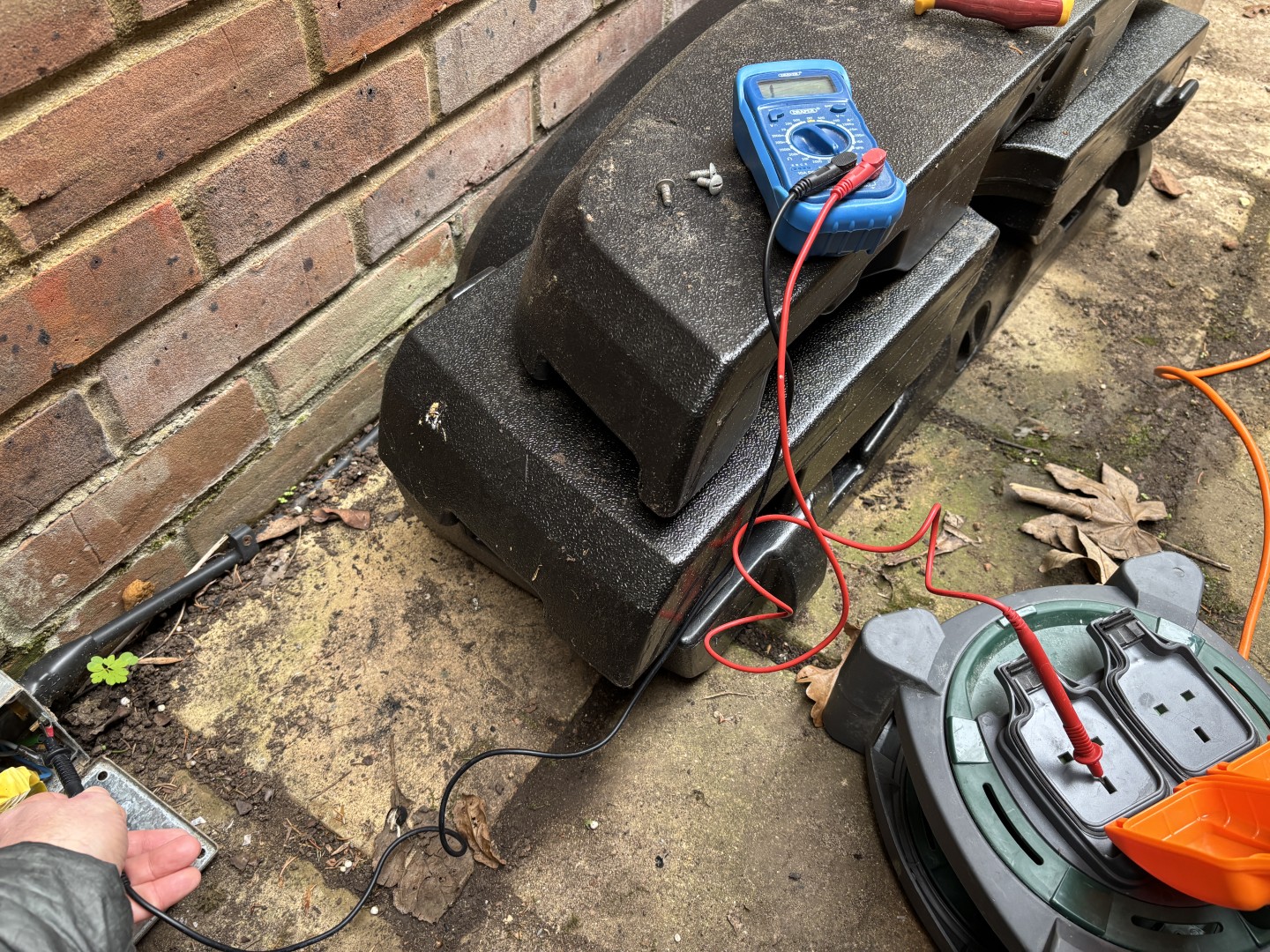

Run an extension lead from any socket to near this box, then measure resistance between the extension lead’s socket’s eath and the earth in the box with your multimeter.
It’s probably fine. It is normal to use the armour as the earth. One possible problem is that people may not understand that, make a modification, and not re-establish the earth. So it would be useful to see the other end of the cable to check if the armour has been correctly connected to an earth wire there.

1. Why are all the earth wires joined to each other with insulating tape (in my first photo)? Shouldn't they be connected by a wago connector or something? What's the purpose of wrapping with insulating tape?

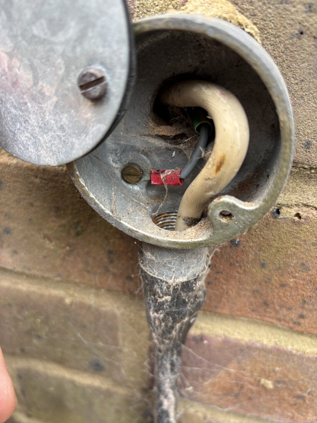

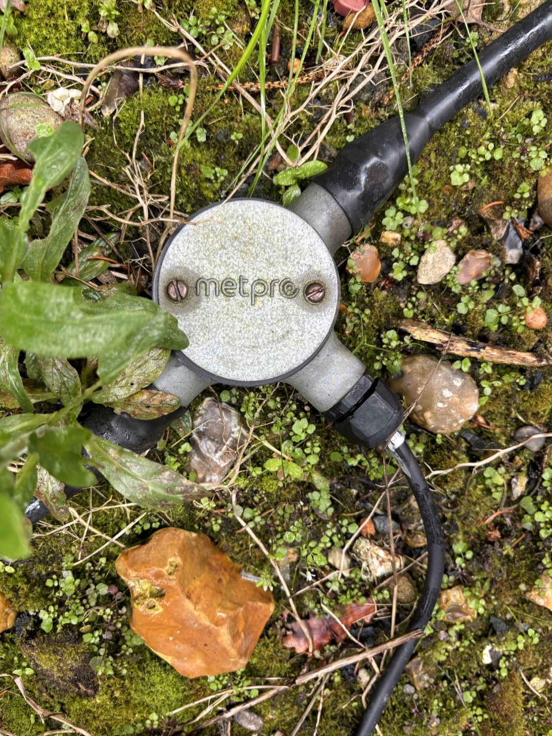

2. If the armoured cable in the garden is connected by metal conduit boxes and the armoured cables are connected by glands to the metal conduit boxes as per the second photo, does that mean as long as the first armoured cable is itself earthed, all the others will be earthed because they are 'daisy-chain' connected through the metal conduit box without needing any extra wire to connect the sheaths (i.e. the metpro conduit itself provides zero resistance between the armoured cables)?

1. I can’t tell what’s under the insulating tape but there could be a terminal block. They shouldn’t just be twisted and taped.
2. Yes.
3. You should use SWA glands and connect up the earths. I note Wiska have some products related to this, e.g. https://www.tlc-direct.co.uk/Products/WKEC308.html . I’m not familiar enough with this to comment in any detail.
Eh?? The box shown has got SWA glands. The Earths seem to be connected up, but looks can deceive. Testing is the way forward.

1. While two of the connections to the metal junction box have SWA glands, one of the connections does not have - see first photo and circled in red. All three connections to the metal junction box are armoured cable, but I fitted the one using the one in a red circle using a nylon gland, so it isn't earthed. The armoured cable is also connected to the wiska box using just a regular nylon gland so it isn't earthed that end either.

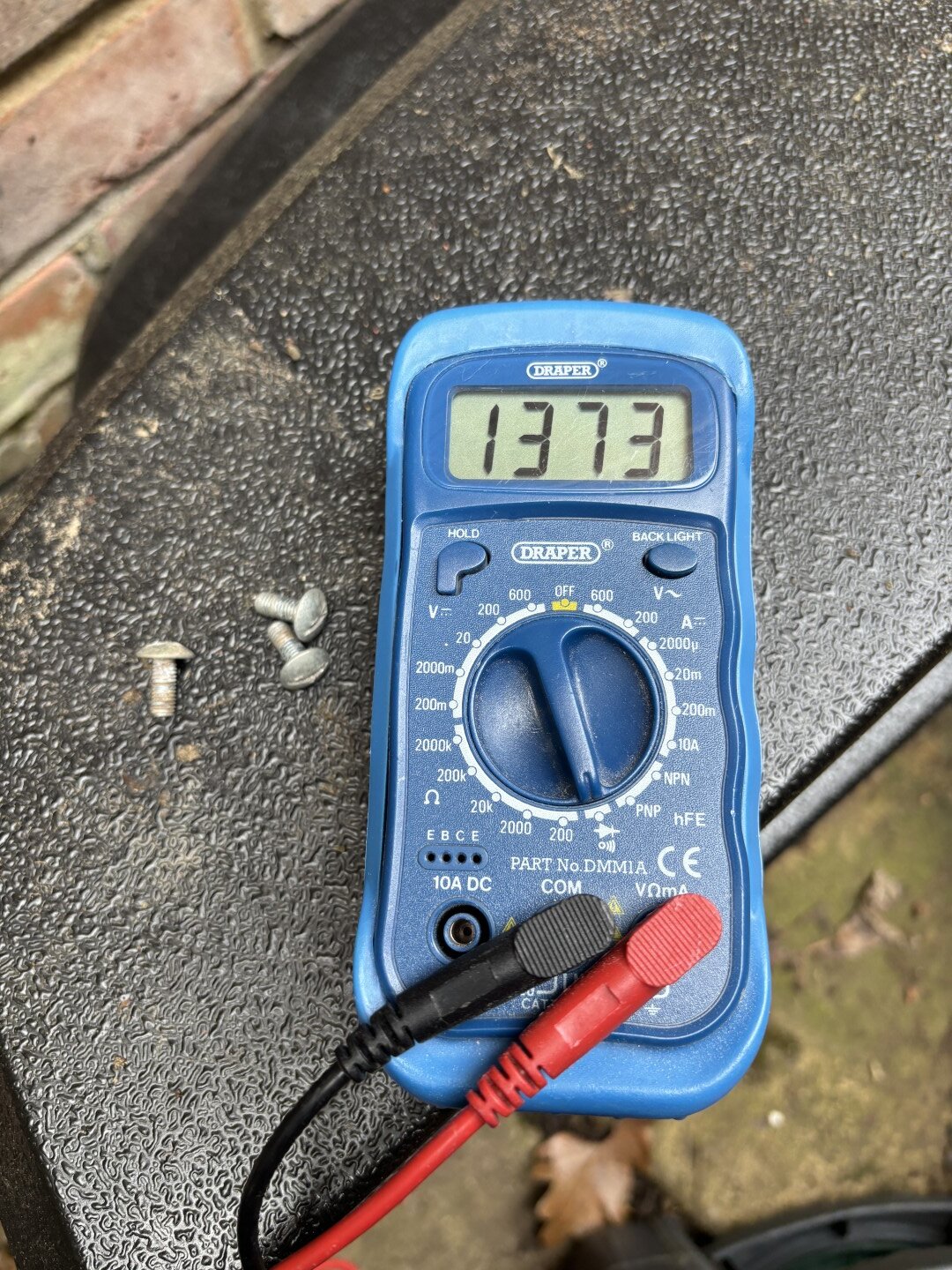

2. As ENDECOTP suggested, I did an earth test by running an extension lead close to the metal junction box and checking the continuity between the earth in the extension lead and the earth in the metal junction box. On the continuity test the result was coming it at around ~1400 - see second and third photos. Is this a problem?!?

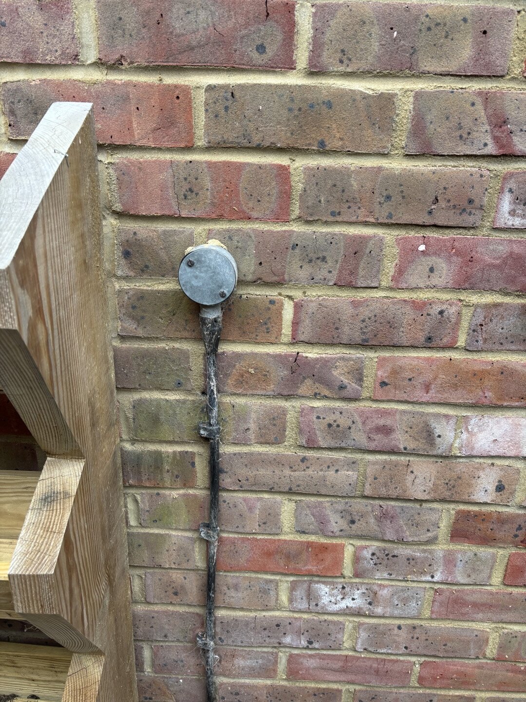

3. Fourth and fifth photos show where the armoured cable enters the house from outside. I don't know how to access this from the inside following kitchen fitting etc. The junction box itself looks like it is earthed - does that mean the SWA sheath would also be earthed and then the rest of the SWA are earthed by daisy chaining?
