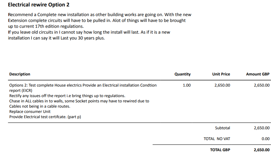

Hi Everyone,
I just bought my first house and its going to involve some significant work redecorating and a rebuilding part of the house. Its a Victorian terrace in Bristol with two double bedrooms, two receptions, the kitchen and bathroom are stuck on the back and looks like an extension but they are original, they need to be knocked down and rebuilt due to an ongoing subsidence issue that's gone a bit far.
The last rewire was in 2001, however they decided not to chase everything into the walls, there is ugly plastic trunking everywhere.
With everything else going on, including where part of the circuits go being demolished and rebuilt I want everything chased into the walls before i decorate etc, I may as well get a new consumer unit at the same time in case i want to sell at a later date.

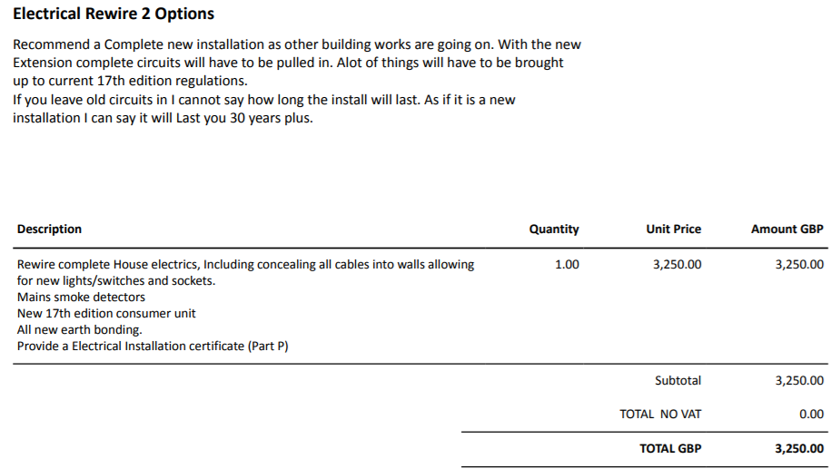

I have asked for a quote based on not rewiring and me cutting all the chases and holes for the back boxes into the walls and one based on them doing all the work, what i received were quotes for full rewires, supplied below, the 2nd for a full rewire and concealing cables seems plausible for my locality, but the one with me doing the prep work seems to be ignoring me doing the prep work and my request not to rewire.

Excuse me for asking for some confirmation of your plans.
With regards to the quote not requesting a rewire, are plans to chase out, sink boxes for sockets/switches etc and route new cable as a rewire yourself. Or chase in new cables to alter/add on to existing circuits?

Hi prentice boy,
I was intending to just cut the chases and holes for the boxes, right next where the current outlets are, assuming the wiring, all from 2001 is sound, I could cap them, then let an electrician actually wire them, (i could do that bit, but wasn't assuming it would be me) the rebuild would need to be a new circuit I guess, but the wires could follow the same path there.
I would have thought a test would at least be suggested before recommending a complete rewire, the last periodic test was in 2011.
Not sure what I did to question 2, may have amalgamated it into 1.
I feel you are concerned I may rewire loads of stuff so an electrician may need to clean up after me, I just want everything where it is now but chased in, plus the rebuild. When you say you would want to know how the customer did things, I can take direction if need be.
A bit surprised also the quote wasn't broken down a bit more, even parts =£x labour =£y.
I can also follow instruction regarding what capping or conduit I use, but I don't want to touch what's under the floorboards, it can be as it was from the last rewire.
This may be partly up to my builder who passed my requests onto the electrician, but I am sure he would be clear.

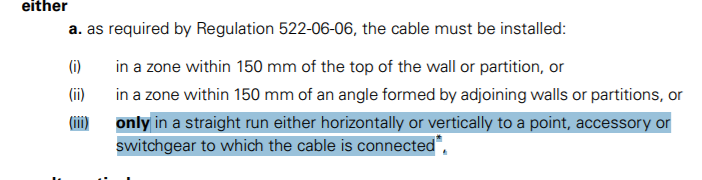

There are permitted safe routes to follow when chasing cables in walls, if you are using the same cables, then you will have to align your sockets and switches accordingly, as there may not be any slack cable to work with, to allow this.
Also cables should be located correctly in floors. Use this link and look at the subsections concerning walls and floors.
https://www.diynot.com/wiki/Electrics:Installation-Techniques
But looking at the link it does state that cables can be chased in greater than 50mm and safe zones can be excluded, but there are other building regulations concern the safe structure of the wall, which most often prevents the greater 50mm chases being made.
I certainly would do some testing of the installation prior to any alterations.
But I would have quoted for the inspection and testing on the existing install, before I would have quoted for any alterations, as I would be much informed into what is really required after doing EICR (aka PIR back in the day)

When it suggests mechanically protecting the cables as an alternative, what products are we looking at? I am looking at suppliers and not seeing any saying they are specifically for this purpose.
I should asses what was done last time under the floors, but it should have been compliant with 2001 regs, have they changed a lot?
Mechanical protection, would obviously be something that protects the cables from damage by screw/nail/drill etc. There is no mention within BS7671 (wiring regs) that states what this should be, but rule of thumb and experience would suggest a 3mm gauge metal cap or conduit. You could if wished use an earth shield cable, but you are keeping cable, so not an option.

I was responding to old and bold, who said to leave it to the competent installer, which seems to be saying don't even think about merits of the quote or getting other quotes, just accept without question.
Even doing nothing myself I should ask around and discuss price, surely?
It is advised to always get at least 3 quotes. But saying that, the prices quoted, if including materials does not sound extreme. I would be concerned though, with any electrician using the term 'part p certificate'.
