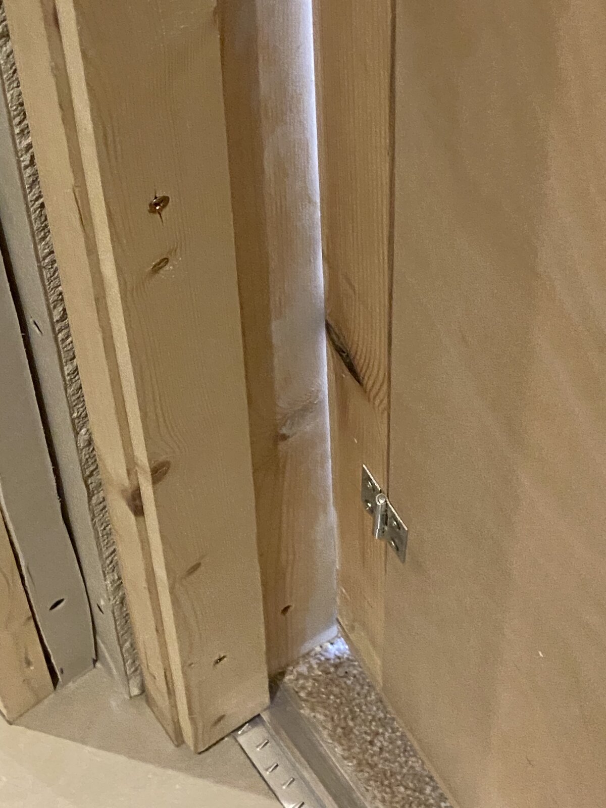

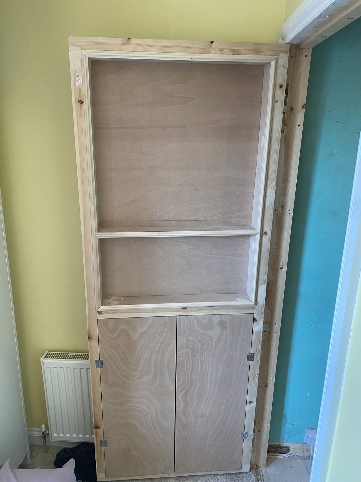

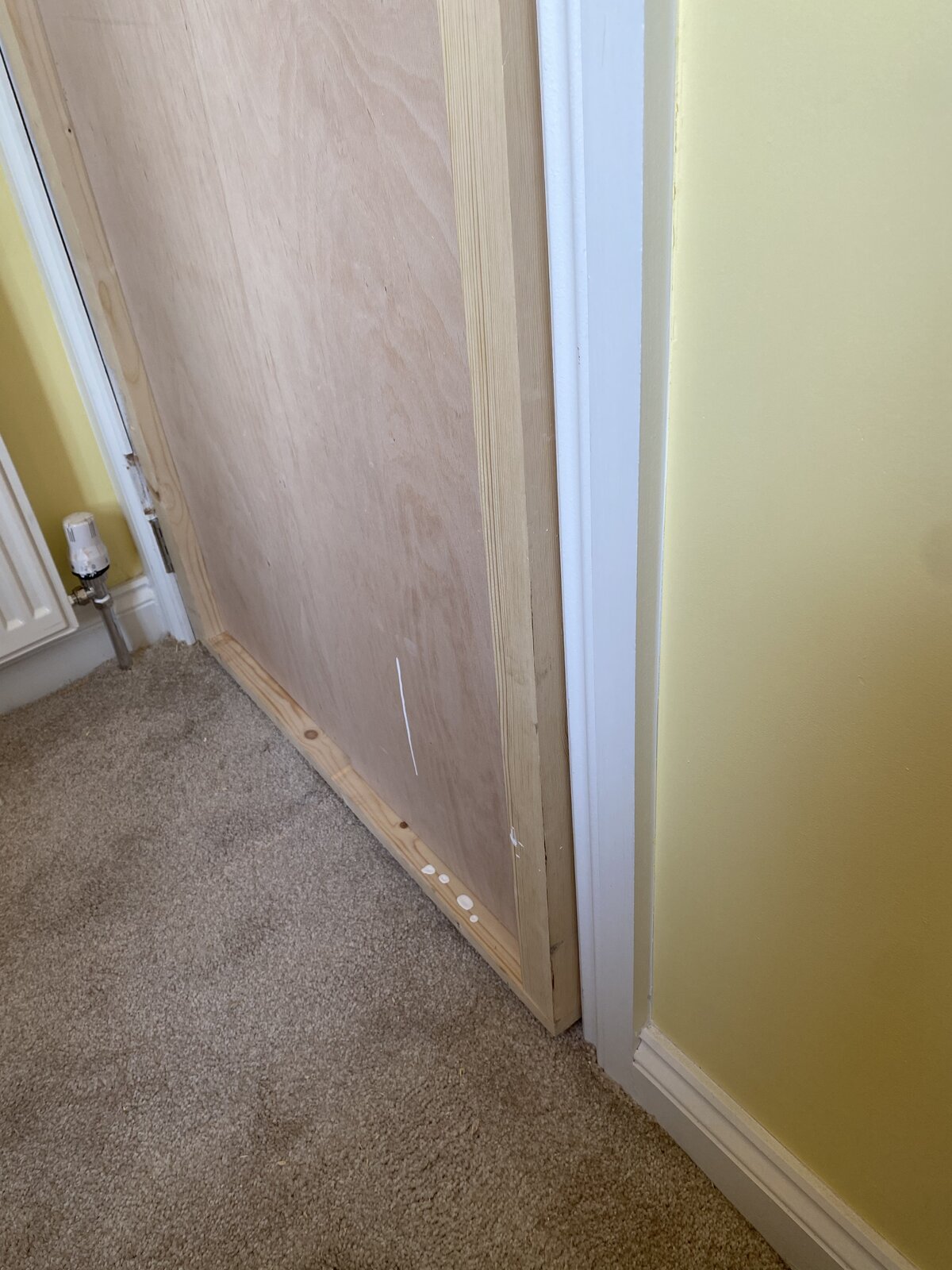

Hi all,
Really hoping you can help. I have attempted to build a “secret bookcase” door for my daughter. The door itself I’m happy with but despite hanging it three times, the bottom corner on the opposite side of the hinge side, sticks out by about 4cm when I close the door. Everything is plumb and level so I just don’t understand it. When I lay the door flat, it’s flat! It isn’t warped. Has anyone got any ideas please?
Thanks,
Joe.
Check if the main hinges are recessed enough and if the screw heads aren't protruding. Looks like the hinges aren't closing fully.
If the frames not square to the door you may need to plain some of the door edge where the hinges attach
You photo’s do not show what you described, the door is not closing along entire height not in one corner ?
Photo is only the bottom half of the door. It’s fine at the top corner but the bottom corner sticks out so the gap gets bigger as you go down the door
Whe you lay the door down how do you know the door isn't just lying flat under it's own weight? Can you push the corner in?
You can push the corner in yes. The door itself is really light. I even took the cabinet doors off to check if it’s warped but no dice

What screws have you used on the hinges?
Do they sit nicely in the countersink or do they protrude?

Hi @angliojoe
Please don't take umbrage.
You have used butt hinges, but used them as exterior surface mounted hinges. Only the knuckle is supposed to be visible. Conventionally, you would chisel out a rebate in the edge of the door face to accommodate the hinge (and possibly one in the frame).
For future prosperity, a 35mm cup hinge- the type used for kitchen cabinet doors might make life easier. They are far easier to adjust, up down, left right.
Hi @opps, thanks for the message. The butt hinges on the cabinet doors at the bottom are more there for effect than anything else. The door itself was the problem and had space for the hinges routed out which turned out to be the problem, one was too deep. I added a spacer in the top hinge on the frame side and sunk the screw heads on both hinges in further and it finally fell flat against the frame so all sorted. Although it was a bit tedious :)
