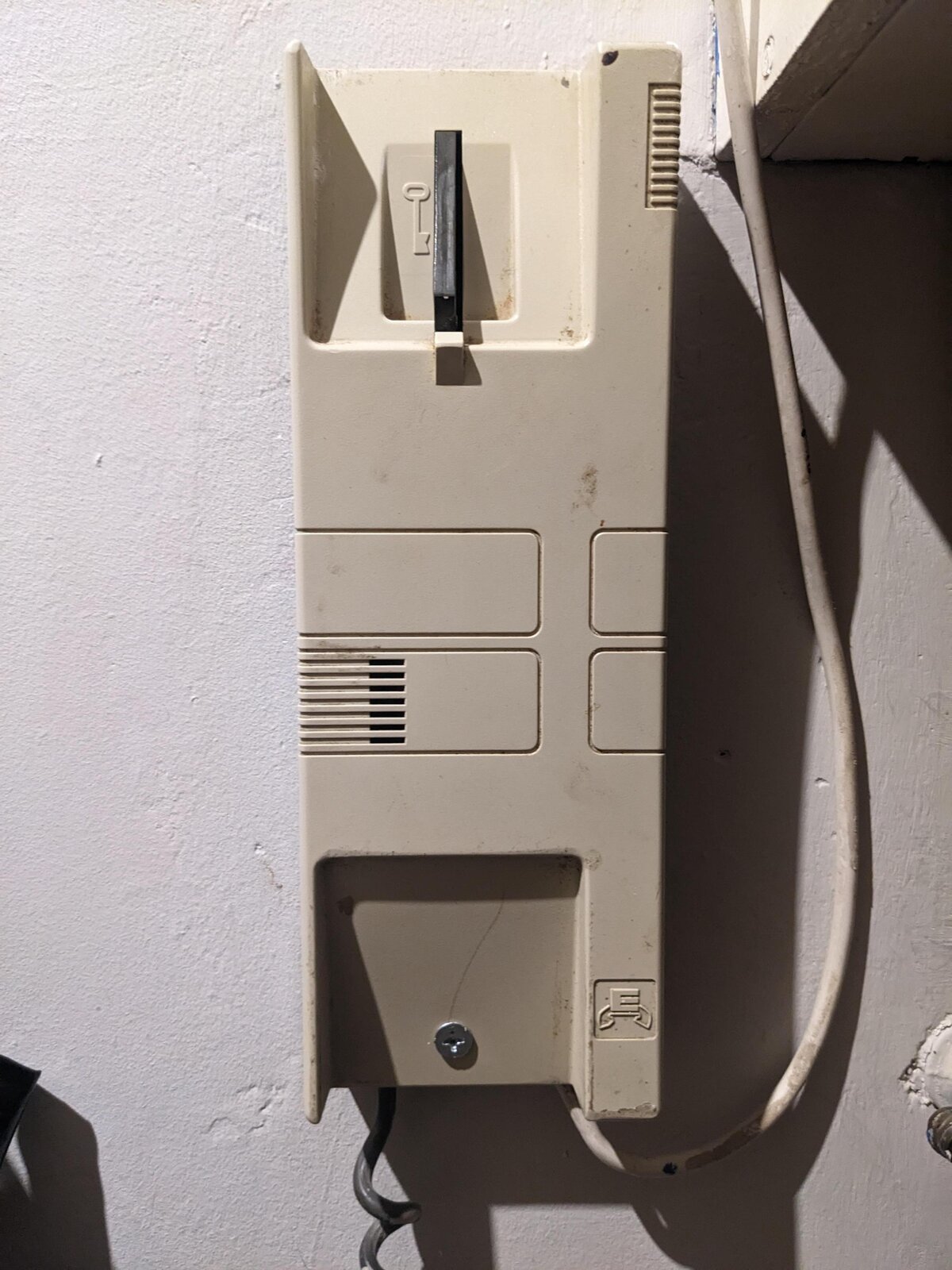

Old handset cover plate, Urmet 1030 or 1130, not sure:

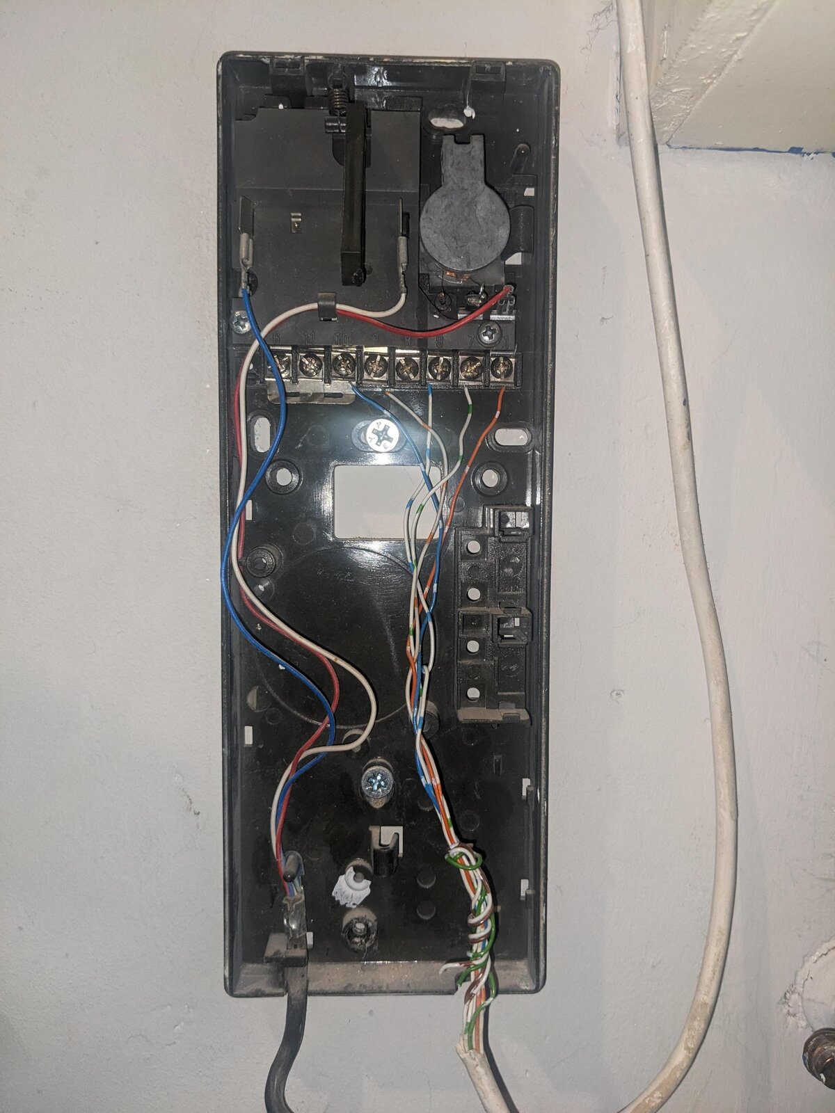

Old handset wiring:
According to www.intercomsrus.com, both 1030 and 1130 have the same terminals (I've noted the wire colour in square brackets)
6, 11, 10 - common [blue wire with white stripes]

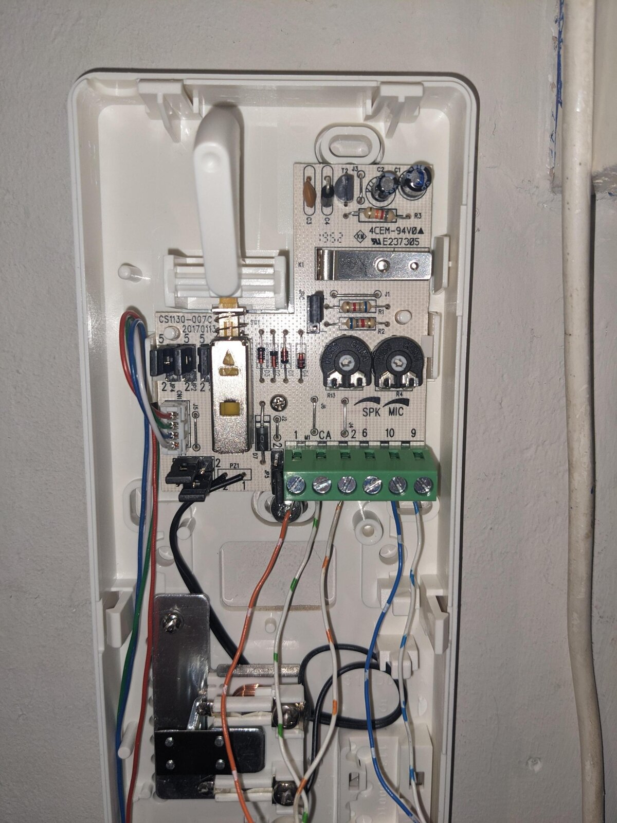

New handset, Urmet 1130/16:

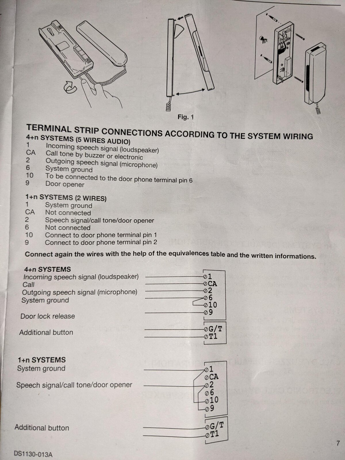

The terminals on the 1130/16 are definitely different from the old handset. The instruction booklet that came with the handset states the terminals are as follows:
1 - Incoming speech signal (loudspeaker) [orange wire with white stripes]
CA - Call tone by buzzer or electronic [white wire with green stripes]
2 - Outgoing speech signal (mic) [white wire with orange stripes]
6 - System ground
10 - To be connected to the door phone terminal pin 6 [blue wire with white stripes]
9 - Door opener [white wire with blue stripes]
(I tried connecting the blue wire (the system ground / common wire) to terminal 6 but this results in the door lock button not working)

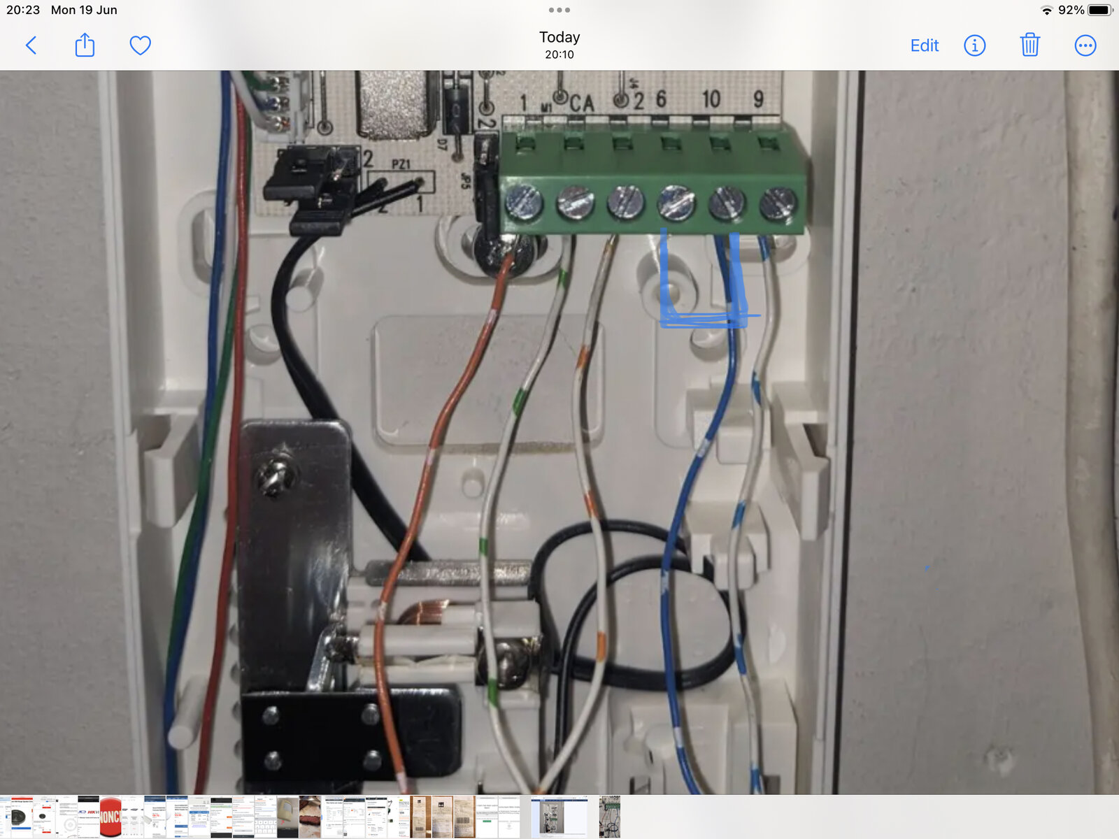

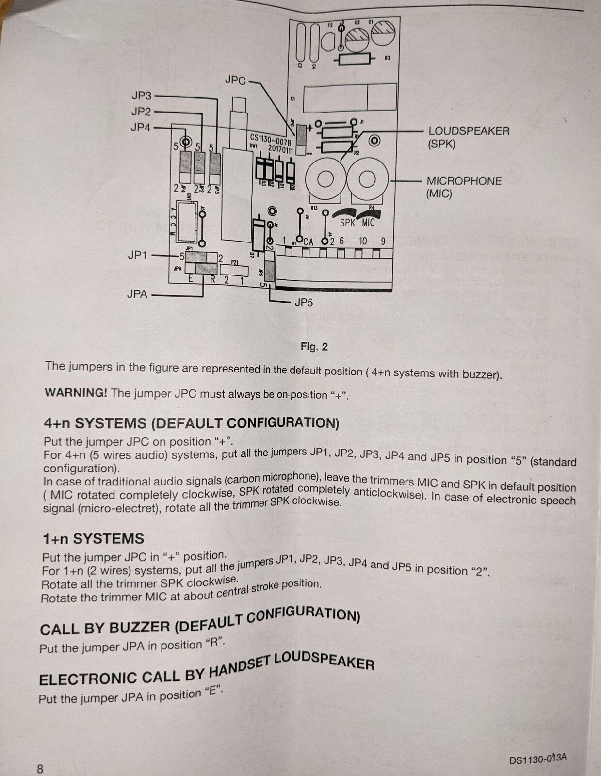

Think it needs a link between 6, 10 as per image …..if everything now works apart from buzzer then I would be looking at the button in the panel …..also what do the instructions say about the two jumpers inside the handset bottom left on the pcb ?

Thanks for the fast response.
Would rather avoid doing this if poss. Seems weird that the wire would need to be split to make it work properly?
The jumpers look like they're all in the default position for a 4+n system with buzzer.
- JP1 is in position 5 (standard configuration)
- JPA is in position R (call by buzzer, default configuration)
Here's the two instructions pages from the manual showing terminals and jumpers...
Instructions - terminals:
Instructions - jumpers etc:

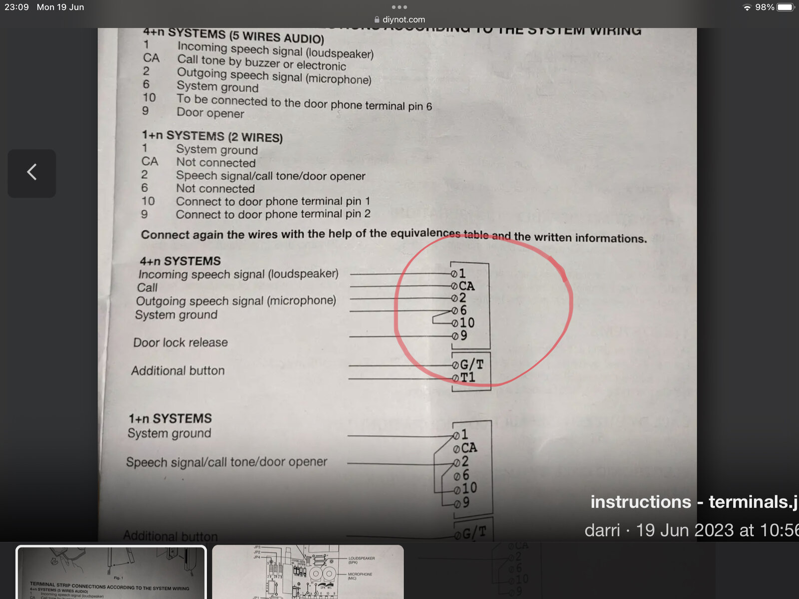

AND IT CLEARLY SHOWS IN THE DIAGRAM THAT IT NEEDS TO BE LINKED …..but if you know better ….best of luck …
Haha, thank you, it does. So Is it just a matter of slotting in the system ground wire into pin 6, then adding a wire connecting pin 6 to pin 10? Completely new to this.
OK I got it all working at last! As sparkymarka kindly suggested, I needed to follow the instructions properly and connect terminal pins 6 and 10 together. I did this by snipping a bit of unused wire and trimming the plastic coating off both ends so that about 0.5cm of metal was showing, then slotted the wire into pins 6 and 10, joining them. I moved the 'system ground' wire (the blue one with white stripes) to terminal pin 6, as shown in the instruction manual. Now the buzzer is working 100% and I can finally let the postie in. Phew.
