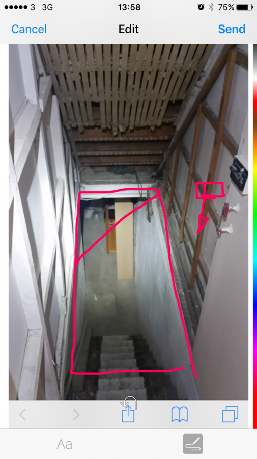

I'm really after tips around constructing the door... Like
  • Does it need to be fire rated
  • What hinges can I use that are flush on the surface that also work with a door that's potentially 40mm thick
  • Steel frame or timber frame
  • Would this be notifiable?
I'd make a door out of floorboards with 3x2 strips on the bottom and double hinged like this:
With one of those swinging farm gate type catches to hold it up. You will have to run a rim round the opening for the 3x2's to sit on.

Isn't that diagonal the wrong way around?
No it's correct; it allows the door to go up against the wall.
Ians made a good suggestion of using floorboards, but I'd split the floor/door in half. Half to lift up against the wall, and the other half to lift up and under the stairs. This makes them both lighter to handle. But you could also split it 1 third and 2 thirds, with the latter being hinged at the bottom of the stairs, and having gas struts to help lift it. Unless you could find gas struts extendable enough to handle the whole door whilst hinging it from the end. Use fire rated ball race hinges.
You are right in thinking about extra large door stops to support the "doors", something like 2x1 should be sufficient, but I'd glue and screw them to make certain.

But I thought his original plan was to use the door as the rail to protect the hole?
Opening up and blocking the gap between the stair rise and the drop on the room side
my thoughts are to find the point going down the stairs where you just clear the floor with your head or have to duck a bit then cut a trap to fit that area that only moves when you need maximum clearance
this will reduce the weight and unsupported span off the main trapdoor/s
