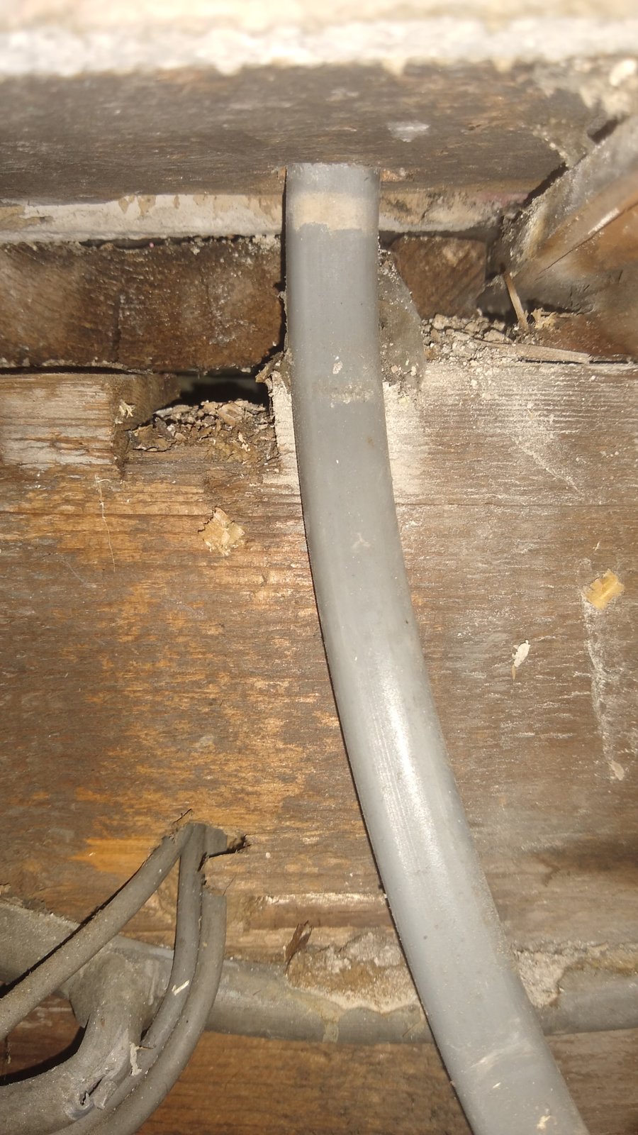

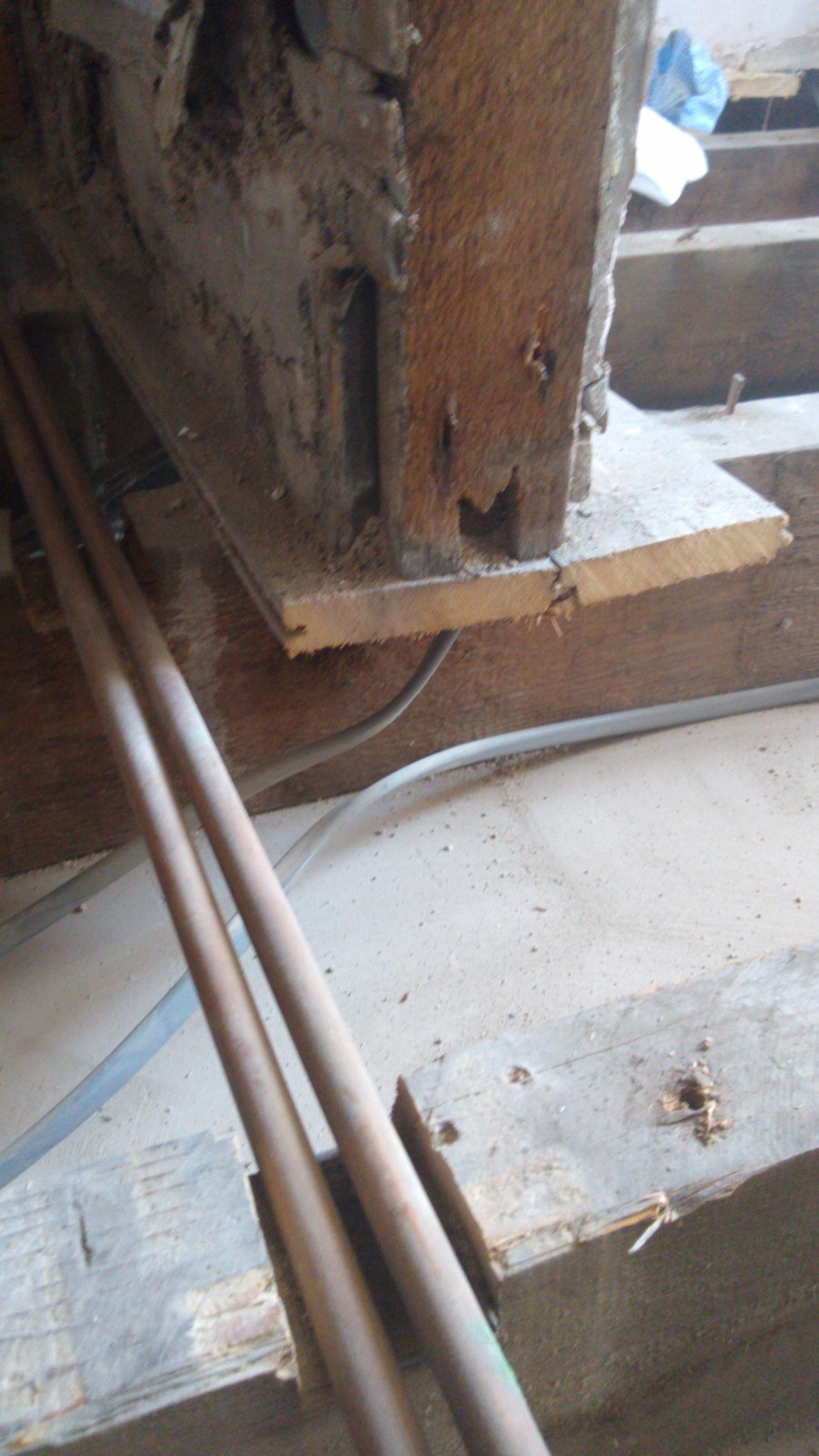

Here are a couple of pics
General pic of stud wall in question
.... And a close up of the stud wall. The joist can be seen and also you can see a floorboard on the right that the stud wall is sat on. I removed a bit of board to see what was going on

I wonder if i may be able to put a screw into the joist from the side that i am working from - angled through the side of the noggin into the joist?
Yes. That was what I was suggesting. You'll neef s couple of screws at each end

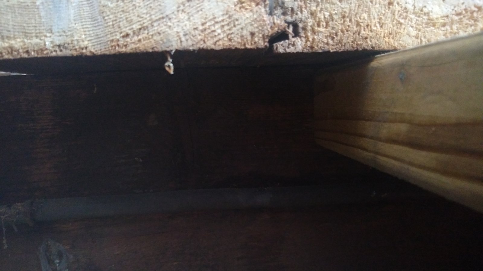

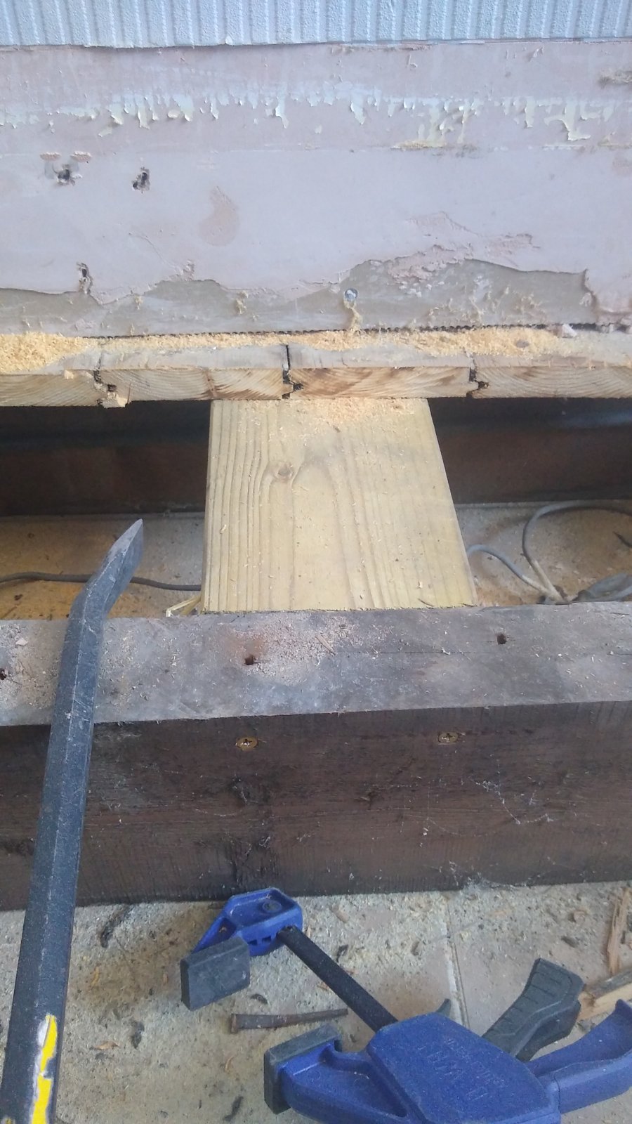

Finding hard to get noggins in vertical due to cables etc in way. Does this look about right?,
Also how can I get a nail or screw from under the noggin into the floorboards? Doesn't seem enough room to work.
Cheers again much appreciated
That's good. Stiffer if you can get it vertical rather than horizontal like that one. Pilot drill countersink and screw down from the top at an angle (i.e. skewed) rather than trying to screw from beneath. Far easier

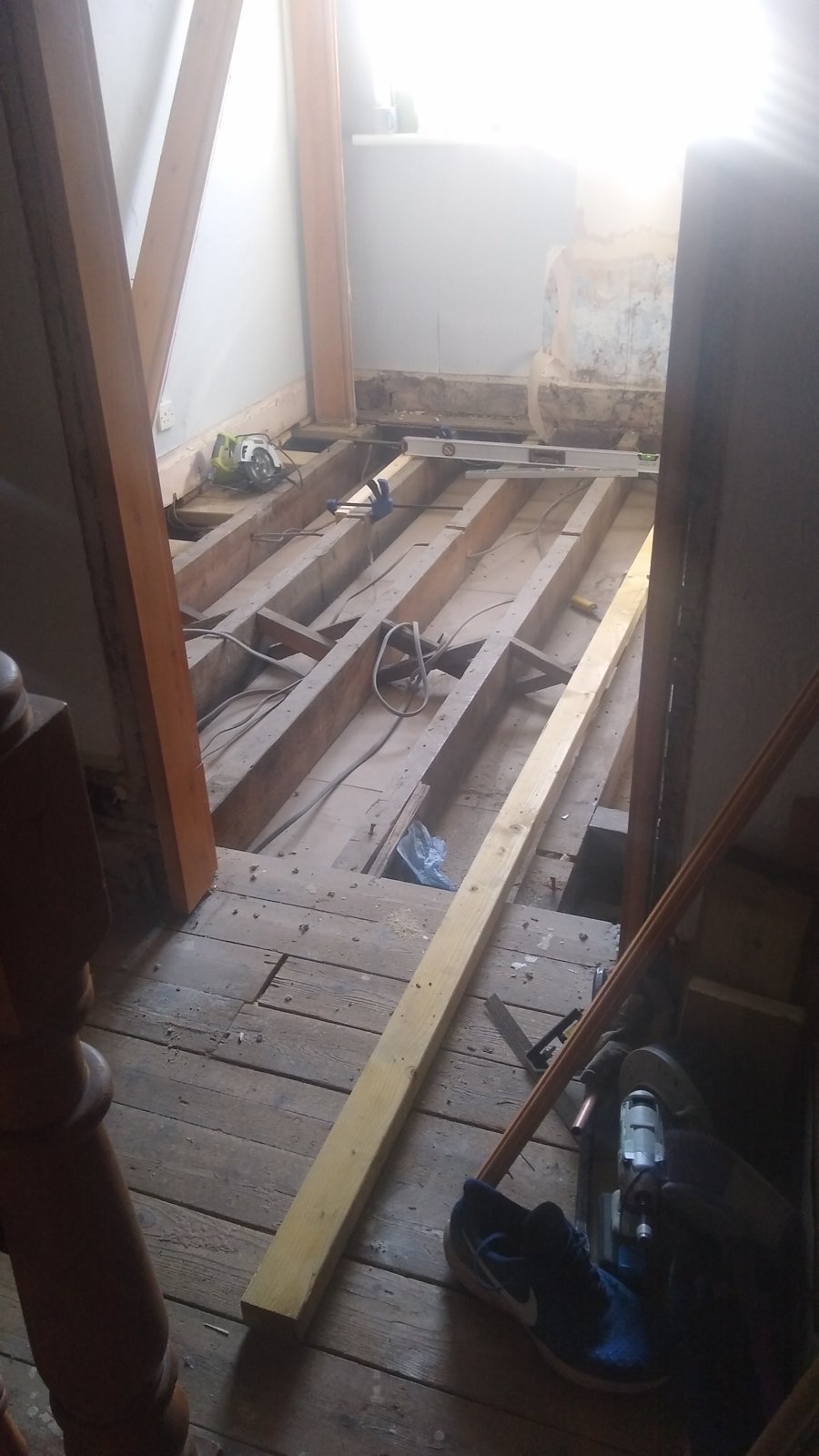

Update after today
It was a stressful day as you say! In the end i took the bath and sink out, and when putting it al back together the bath waste and tap was leaking so i thought sod it and ripped it all out as i need to level the floor in the bathroom so thought here is my opportunity.
I've bought 28m in total of 5x2 (to be on safe side)
My questions at present are:
1. One or two of the current joists are twisted/bowed (ie. not vertical if i put spirit on the side), do i just bolt to it as normal? Will the top edge of the new timber reflect the joist i am bolting to?
2. How do i leave the floor edge on the stud wall where i have put noggins? I won't have anywhere to screw in the new floor at the edge of the room?
3. The joist spacings are not your typical 300mm or 400mm, they're coming in at 380mm or so - will this be an issue when laying board down?
Normally you just face fix it and leave it at that, unless it is really bad. In that case it may be necessary to plane the top edge of the sistered board to get it right (flat, horizontal). It normally doesn't need to be perfect, but within 2 to 4mm is generally acceptable
You should have put in the noggins at 300 to 400mm centres. If you add some form of packing atop these noggins (e.g. a offcuts of the removed flooring, thin plywood, etc., building the level to that of the top of the new sistering boards) then that will suffice to carry your new flooring
Yes and no. In other words there are workarounds. Your t&g boards will work out at 2400mm long as a rule (ideal for new 400mm spaced joists). Additionslly, in a typical domestic environment your rooms normally won't be more than about 4.8 metres, so with a little bit of organizing you may well be able to the boards to join end to end over a 5 x 2. This gets a bit more awkward on your alternate rows (where instead of two full boards you get a half board, a fullboard, then a half board) so if you get a joint that misses it is often just a case of screwing a 2 x 1 batten (slate lath, etc) or the like onto the side of the joist for that board width (600 to 700mm long). The alternative might be to install a couple or three noggins between joists for that board. The key issue is that you must not have unsupported end joints
4. On the picture below, would you start on the right and work your way down to the left?
Quite possibly. A bit difficult to say without being there in person, but working towards a door is generally a good idea. You generally start with the tongue nearest to the wall (you saw this off on the first row to get a tighter fit). That allows you to get the glue into the groove of the installed board and fit the tongue of the next board into that. Starting from the left keeps that going for the end joints as well (if that makes sense)

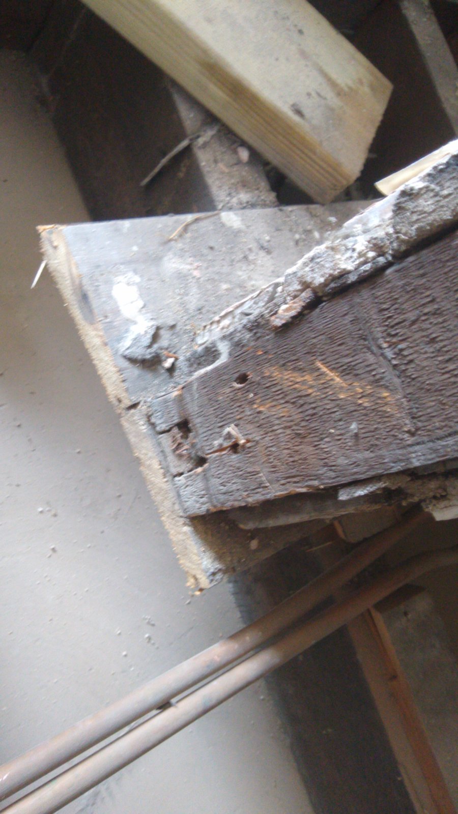

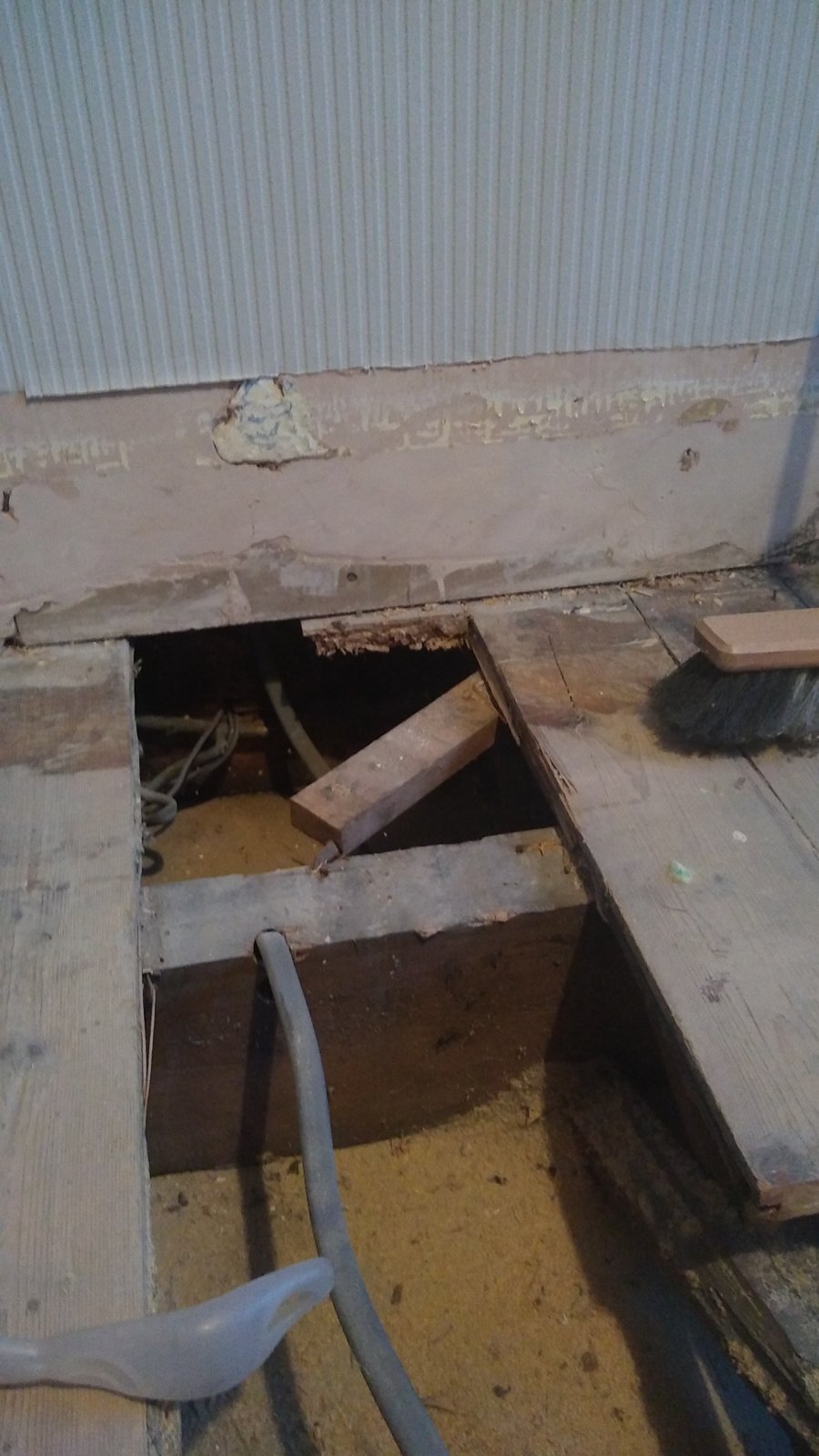

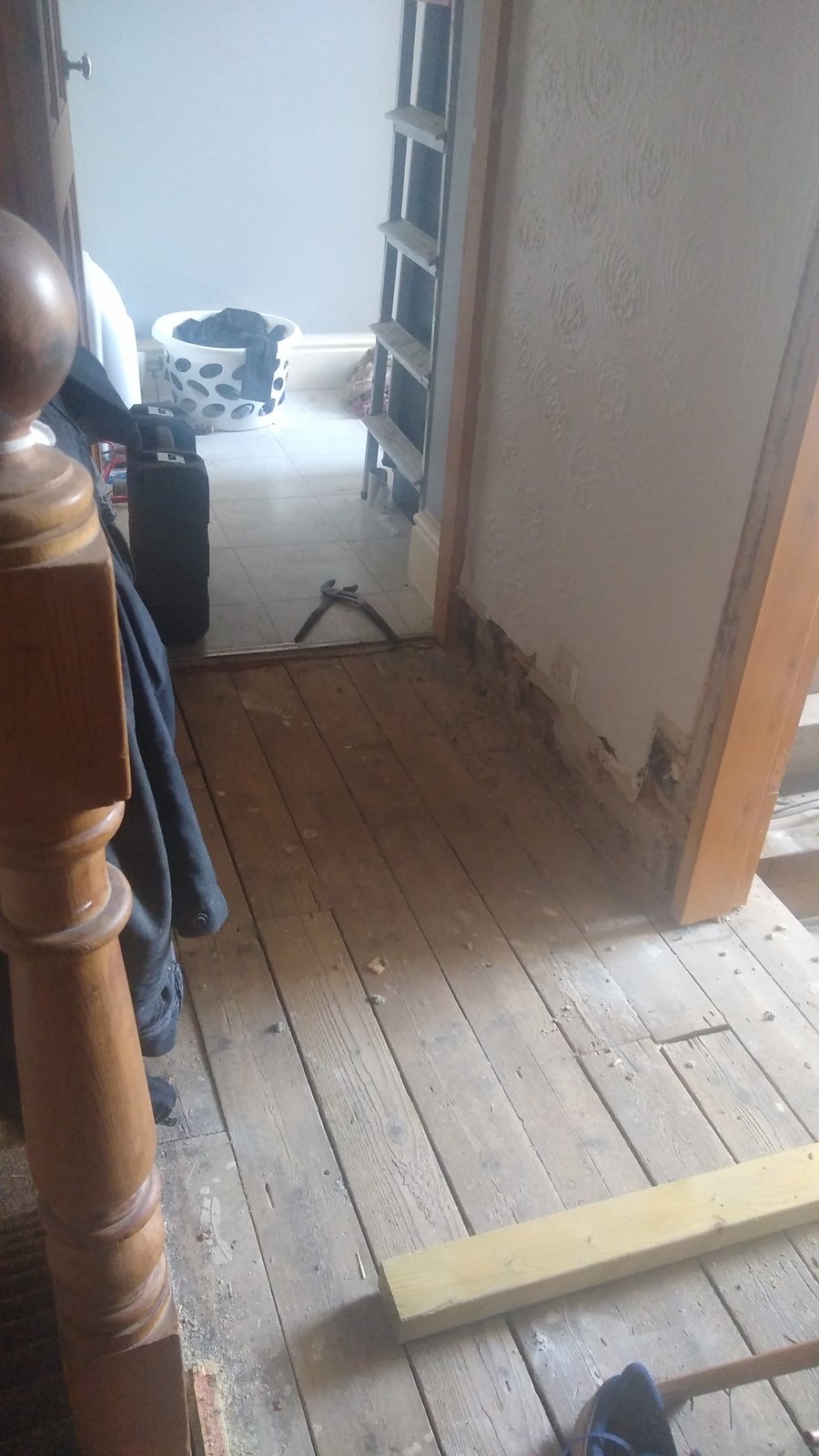

Hi there, just an update, couple of pics and questions.
I've had another day of demolition, mainly in the bathroom and also taking out the floorboards in bathroom and landing.
I've attached some pictures below of the door casing edge where it goes from the landing into the bedroom - does it look as though i have cut the edges ok? The door casing was loose so i took it out and cut next to it. Also, how do i best trim down the width of the board that runs parallel to stud wall, to keep it tight to the wall?

I'd put in a noggin across the opening beneath the threshold from joidt to joist. Thiat will stabilise the joists carry the wall (and later the door casing) as well as giving you somewhere to rest the joints between boards
Screws for the floorboard should be 4.5 x 50mm chipboard or flooring screws or similar.
If needs be use s hand saw to do.the last bit of trimming flush to.the wall face. Multitool can do a similar job
