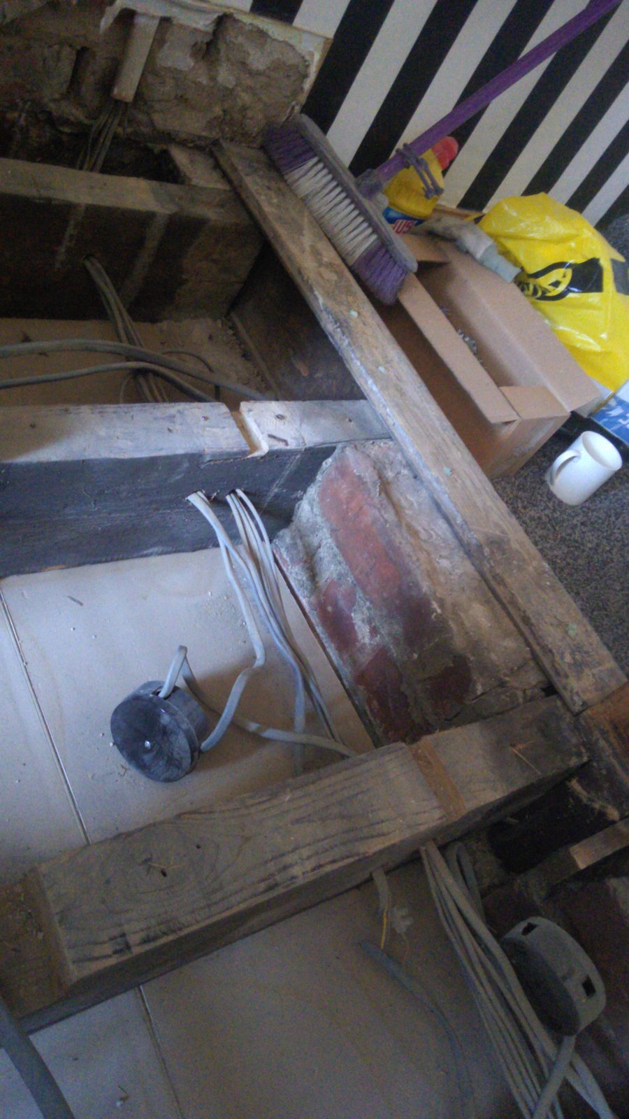

I'd put in a noggin across the opening beneath the threshold from joidt to joist. Thiat will stabilise the joists carry the wall (and later the door casing) as well as giving you somewhere to rest the joints between boards
Screws for the floorboard should be 4.5 x 50mm chipboard or flooring screws or similar.
If needs be use s hand saw to do.the last bit of trimming flush to.the wall face. Multitool can do a similar job

Just about to start sistering joists and starting here at top of stairs. Do I keep this first plank in which has s bull nose on it? Or just chisel off the tongue on it and likewise on th new floorboard and lay flush with the edge of it?
Up to you, but a bullnose isn't very durable in chipboard. Personally if leave it in. Add a piece under the edge so that you can tie it into the chipboard (to reduce chance of squeaking in the future)

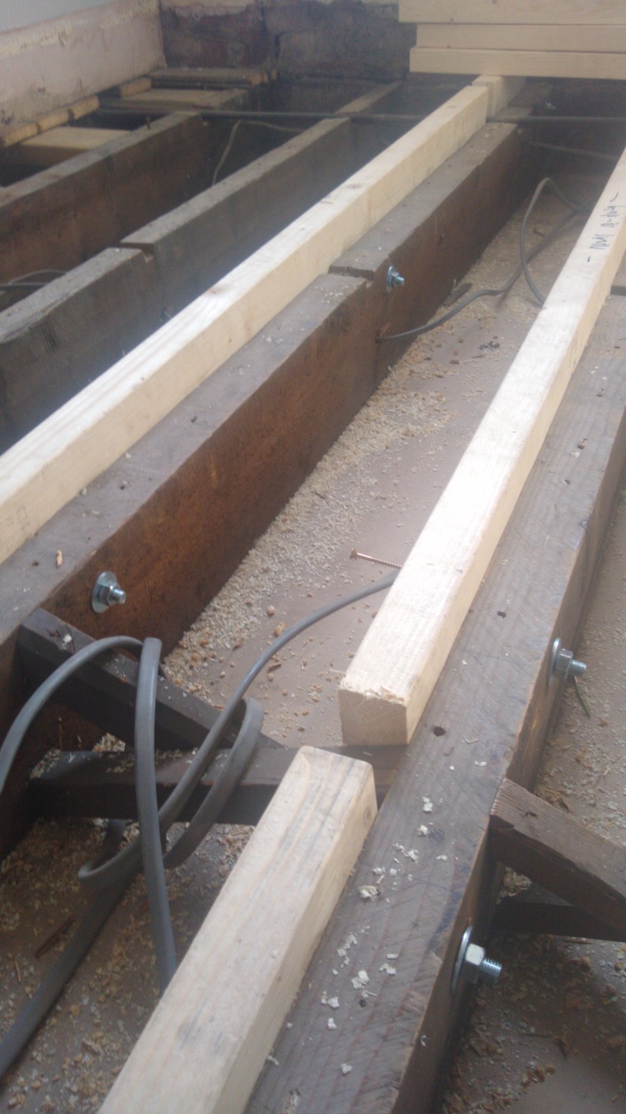

Getting there with the bedroom floor now, just a couple of lengths joists to do then I can fit the floor. I think I'm being a bit too particular trying to get it 100% level, undoing bolts and re doing them etc. There is a slight bit of bend in the board's isn't there? I'm talking a coupl of mm not centimetre.
The joists happened to be 2.5 inch sloped over 3m span so glad I'm doing this job!
Would you suggest installing noggins between new timber? Pic below

Small variations of 2 to 4mm make little difference to the overall result, as I've stated earlier. 6mm and a over you can sometimes feel when you walk across the floor.
Would you suggest installing noggins between new timber?-
On a 2.5 to 3 metre span it shouldn't make much difference, especially if your joist spacing is 16in (or just over 400mm). In your case herring bone strutting is clearly visible, so that shouldn't mske any appreviable difference.

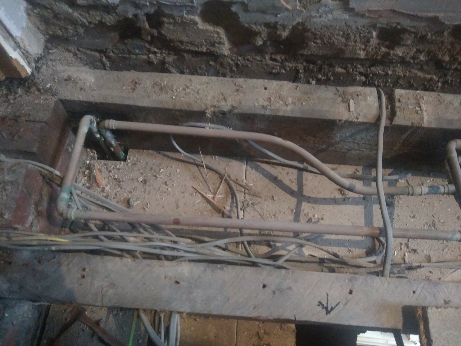

What would I do in this situation? I can't move the pipes as they're rigid and no access this side due to cables? Struggling to see how I can sister to this one....
I ripsawed a room long wedge and screwed it to the top of the joist.
Less accurate than your sistered joists, but I had no other choice owing to pipes.

What tool did you use and how did you measure put the depth? The depth will increase as the slope decreases? Cheers.
With a tape measure I measured the height of the nearest sistered joist above the original joist. I did this at the two ends of the room.
Using these two measurements (you can get a third middle measurement by taking the avereage), on my new joist I marked a line to make a long cheese shaped wedge shape.
I then used a rip saw or circular saw, cutting by eye along the line.
https://www.google.com/search?client=firefox-b-d&q=rip+saw
Then I put the cut (rough) side down on the old joist so had a flat surface facing upwards.Screwed this down with the heads countersunk (flat).
Not the best way, but worked.
SFK
In your circumstances there I might well consider ripping down a tapered timber from 3 x 2 softwood or the like and screwing it to the top of the joist. Easier to do if you have a laser level and some means to adjust the fitted taper, such as a jack plane or power planer. Just make sure to sink the screw heads sufficiently below the surface. Maybe worth pointing out that a few millimetres out of level here and there isn't that noticesble, if at all
