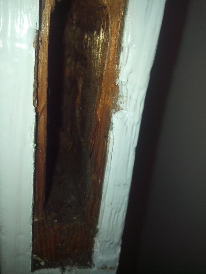

although the existing door is a 44mm fire door, isn't it?
Is it a flat faced door, is there anything like FD30 marked on the top of it, and is it solid and heavy, and does it have a self closer on it.
If it is, then it might be better to fit a similar one, but that still doesn't mean that you have to fit intumnescent strips.
It's heavier than a normal 35mm but then I'd expect that.
From above (no markings) :
Door furniture removed :
Inside the existing mortice :
There was a asbestos survey on the flat(s) and some of the front doors contained asbestos but I'm almost certain thinking about it this related to the communal front doors. No mention of internal doors in any flat(s) containing asbestos and I know plenty of them still have these original doors still within them. The surveyor gained access to a few flats with consent and would have picked this up. There is still a slim chance I suppose.
The construction of the door (what is going on inside) perhaps someone will know. I think if there is a chance there's a flame retardant in it, it's completely disintegrated by now.
It has a lot of the characteristics of a fire door, and then again it doesn't; but at the end of the day, being an internal door, it's immaterial. If you decide to change it for a different type, then you'll just need to move the door stops, and the lock position, and then use some filler to pull things together.
