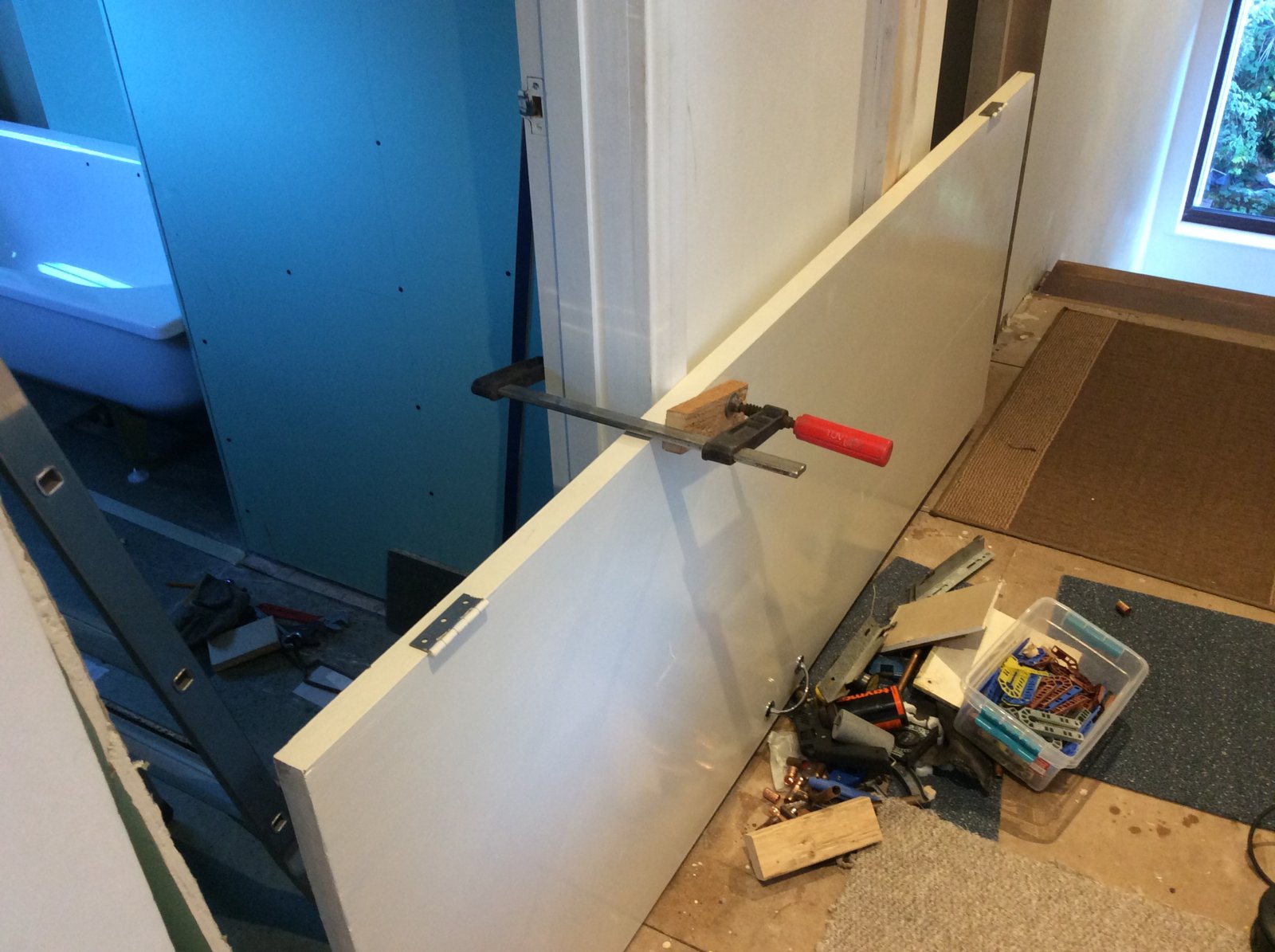

I put one end in workmate , works fine . Or cut slots to match doors thickness in a couple or 4x2’s and fix a small ply base plate to stop them rolling over .
This is a pretty quick and solid way for hinges,locks
We use big timber wedges in a a simple baseplate, quick to knock up and holds door solid for routing etc
