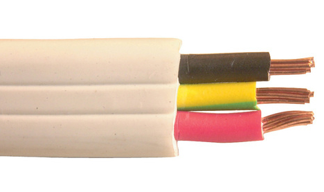

I know from the pictures I've seen the Australian version of T&E has an insulated earth throughout, and also appears to place the live ("active" in their terminology) in the middle with neutral & earth on the outside edges, at least on some cables.
Hmmm...... Just did a quick search and can't seem to find the type with red in the middle, but I'm sure I remember seeing it some years ago. But here's an Australian version with insulated earth in the middle:

I suppose that if you're going to apply sleeving at every termination anyway it's probably just as easy to have the earth insulated throughout the cable to begin with, and adds minimal cost to a reel of cable. But as we've discussed before, it's really not clear why it was decided to specify sleeving at terminations in the first place, other than somebody just thinking "it might be a good idea."
