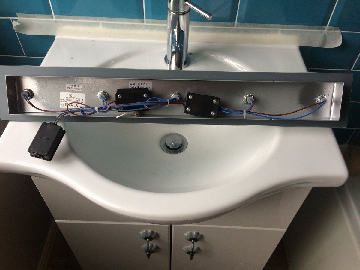

This week I fitted this light for a customer which I purchased from a well known electrical factors in the city.
It is marked as being double insulated.
Do you agree?
I was going to say not with single insulated conductors but realise the body is plastic.
Are the wall fixings plastic as well with no metal accessible - screws?
Is it plastic?
Looks metallic to me....
In which case, :eek:.
If the internal wires were sleeved/ insulated and sheathed I would say yes, but from the photo the wires look single insulated. A non approved design change in the factory to save money perhaps?

The fitting is all metal apart from the mirror bit, and the singles are so easy to trap between the wall and the edge of the metal back part of the fitting (n)
Not much you can do apart from report it to Trading Standards for the area where you bought it, write to the chief executive of the people you bought it from, and see if you can get the "manufacturer" or importer to explain why they think it is DI.
It might be possible to sucessfully claim it complies with the regulations for Double Insulated when made and sold.
I don't know what the regulations actually require, but I'd be surprised if they allowed SI conductors in contact with an exposed-conductive-part.

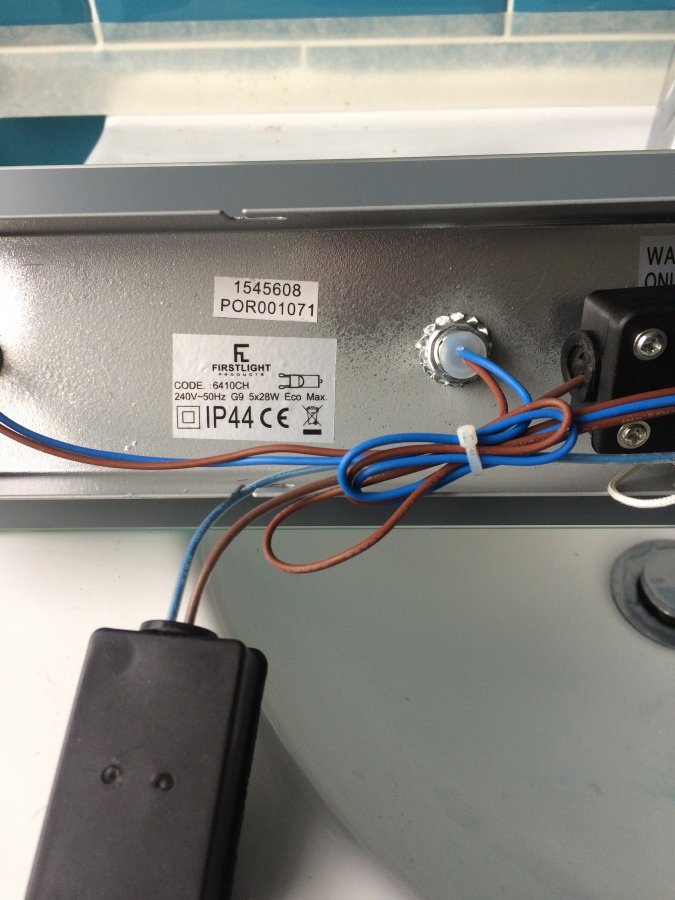

Do you agree?
No, I don't agree. It is marked as being Class II equipment. :p
From 61140:
7.3 Class II equipment
Equipment with
– basic insulation as provision for basic protection, and
– supplementary insulation as provision for fault protection,
or in which
– basic and fault protection are provided by reinforced insulation.
OK. it's marked as Class II equipment.
– supplementary insulation as provision for fault protection,​
Not as far as I can see.
– basic and fault protection are provided by reinforced insulation.​
