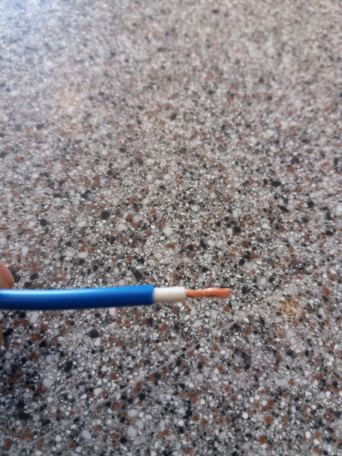

There seems to be a natural assumption that the wires are single insulated,, however it is possible that they are double insulated. Double insulated 1.5mm wire is rare in the UK and I have to import it.
The electrical connections are sealed and the transformers may be classed as class 2 due to the mechanical protection.
I cannot see how the fitments are protected from the main chassis and that may be the only area of contention if the insulation was to fail there providing indeed the wire is double insulated like the wire I have attached in photograph.

Twin layers of insulation on a conductor may be thought of as being double insulated wire but it is not. In the wire overheats and melts the insulation then it is no longer insulated. Conductors insulated with one layer of insulation and encased in a non combustable and non conductive sheath such as fibre glass ( but not metal ) can be consdered as being double insulated ( from any adjacent metal or conductive item ).
The wire shown may be a conductor coated with low cost natural colour insulation with a layer of more expensive coloured material added to make the wire coloured.
The Wire shown is tested under IEC 60331 for heat resistance and combustion also tested to conform with UL 1097, This is a major requirement for underfloor heating cold leads. But it is good that people show concern through not knowing :D
But that wire is mine not the one in the light :p
Not sure how it has escaped your attention, but it is the wiring in the lights which is of concern. Knowing that DI single core cables exist, and have standards which apply to them, is of little use when discussing a light which does not use such cable.

To be class II it doesn't have to be double insulated. The wire could be single insulated but providing a level of insulation classed as "reinforced insulation". It would appear that this means it has to pass a 4U + 2000V = 3kV HiPot test between the conductors and chassis.
DVM leads quite often use a single piece of insulation that falls into the reinforced insulation class as it protects you from the shock hazard.
Is there any marking on the cable inside the light? Might it have an insulator capable of passing the 3kV test?
To me it looks like it might struggle to pass a 1kV one.
