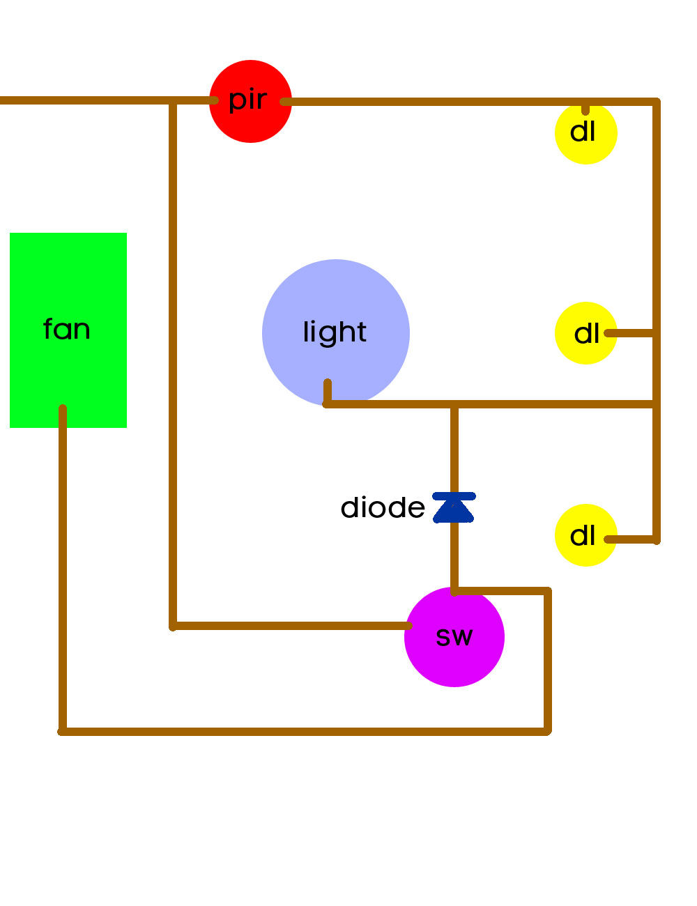

Hi, looking for some guidance, I am trying to work out how to do the following:
1. PIR to activate all lights but not the fan.
2. Switch to activate all lights and the fan.
It's 230v mains circuit, can I use a diode for what I am trying to achieve? Or relay?
Or is it best to just use another switch for the fan only?
Cheers
the main light, fan and pull switch are an existing circuit, but the downlights and PIR will be newly added.

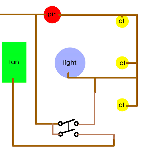

Thank you very much EFL, that makes sense to get a DP switch, cheers (y)
