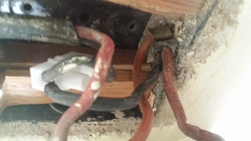

downstairs switch stops upstairs switch from working???
Why would it have mattered?

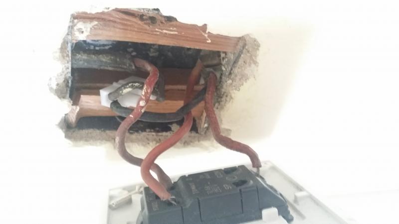

As you are aware, it wasn't me who raised the issue. However, now that you have questioned, and on reflection, the question of whether or not it was an intermediate switch was actually a red herring. As you imply, it wouldn't have mattered if it had been an intermediate switch, wired as per photos!
Kind Regards, John
Except to cause confusion in the minds of some.
It would seem the "spark" that visited was very easily confused.
And a rip-off merchant to boot.

Quite so. It's obviously not easy for us to sort this out from afar, but I would think that any of 'us', armed with a meter, would be able to get to the bottom of the problem in a few minutes at most (if we dared to touch/disturb that VIR cable!) if we were on-site.
Kind Regards, John
Maybe that's why sparkie galloped off, ...
I think you're being unnecessarily kind. We've been told that he moved a few connections around at the switches, so he wasn't frightened of disturbing the VIR (maybe didn't even realise it was dodgy) - I'm afraid that it seems (at least to me) far more likely that he simply "didn't have a clue".
...although I for one would not have accepted a penny.
Quite so - but it sounds as if he not only accepted payment, but requested it!
Kind Regards, John

so coming up from downstairs is the 2 cables. with the red into com and black then the other red into L1 the red into L2 comes from the wire going to the light itself
Hope that makes sense??
Yeah. Think so. ;)
Have you tried reconfiguring the wiring as I suggested?
Handle the wires gingerly, so as not to damage the insulation.
Mark them so you know where to put them back if it does not work.
Just to remind you,
If the black wire in the downstairs landing switch is the live feed, then it should go to the common. The two reds then go to 1 and 2 in that switch.
In the upstairs switch, the wire in terminal 2 and the wire in the common terminal should be swapped round.
