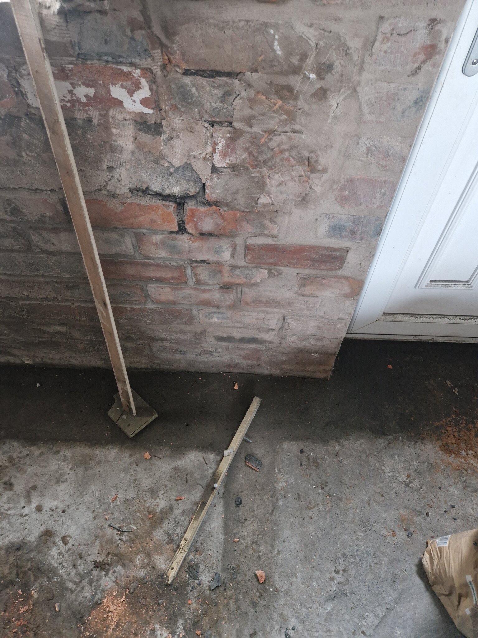

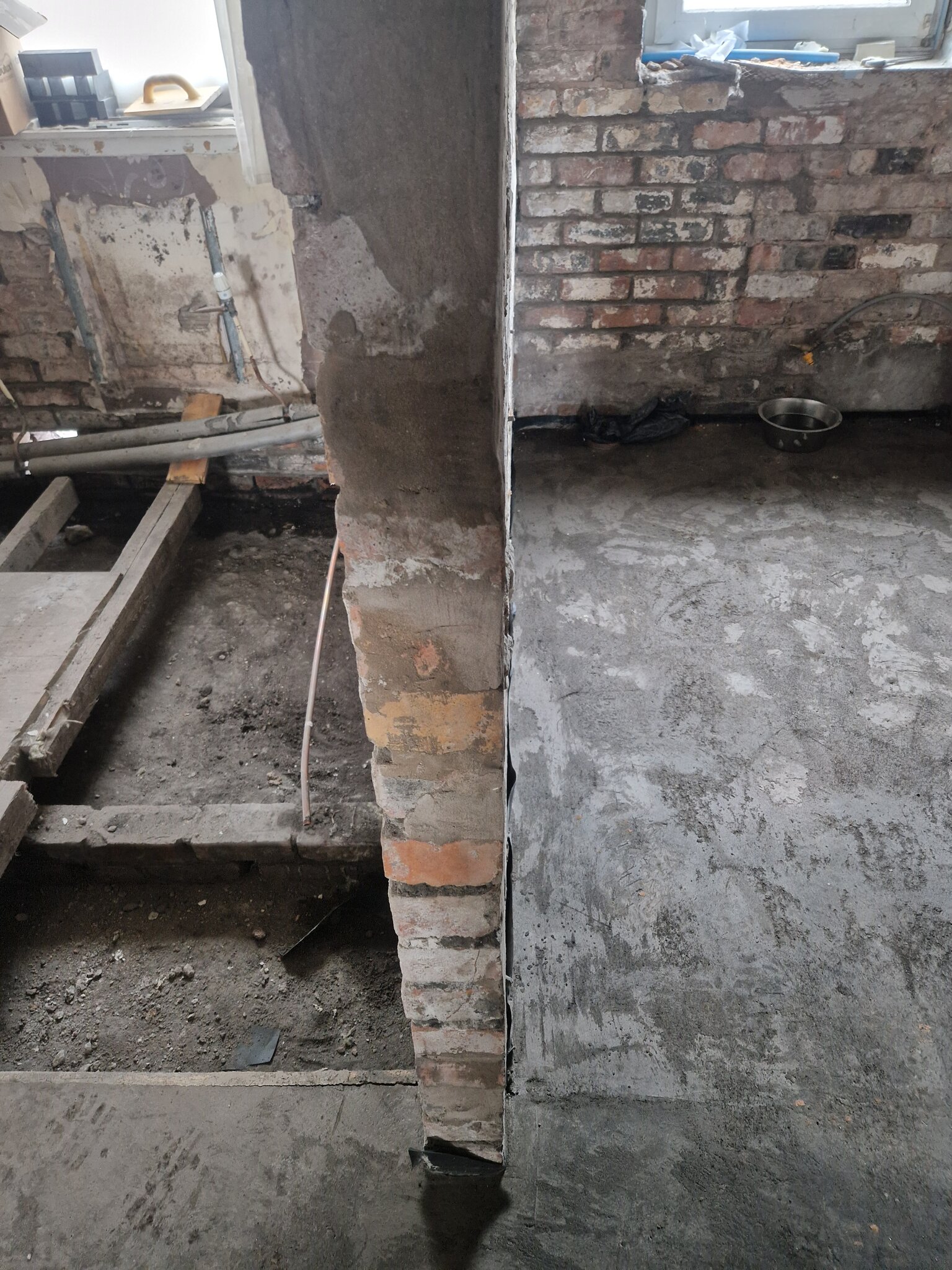

Dpc height around pvc door
In theory i should of stepped up the internal dpc as i went into the next room along to finish at ffl but cause i have connected the dpm down low to the dpc then filled ontop i didnt think there would be a issue
