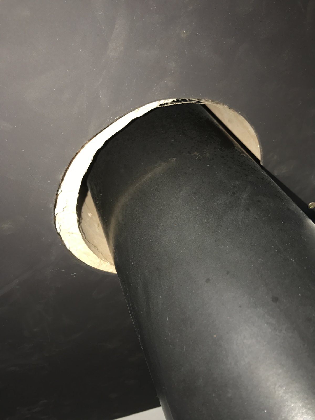

Hi guys, I've got a slight draft coming down side of the flue. Would a collar be the route to take to solve?
Many thanks,
Devs.
A collar alone wouldn't stop the draught. Fill the gap with cement. And then a collar so it looks tidy.
Also check that where the flue exits the wall (on the exterior side) is fully sealed (i.e. not just a collar). The outside should have been fully sealed (cement + collar) by the installer otherwise you are at risk of carbon monoxide poisoning.

Just look into this now guys and the gap is greater than the rope size. Is there an alternative? Would some loft insulation do the trick?

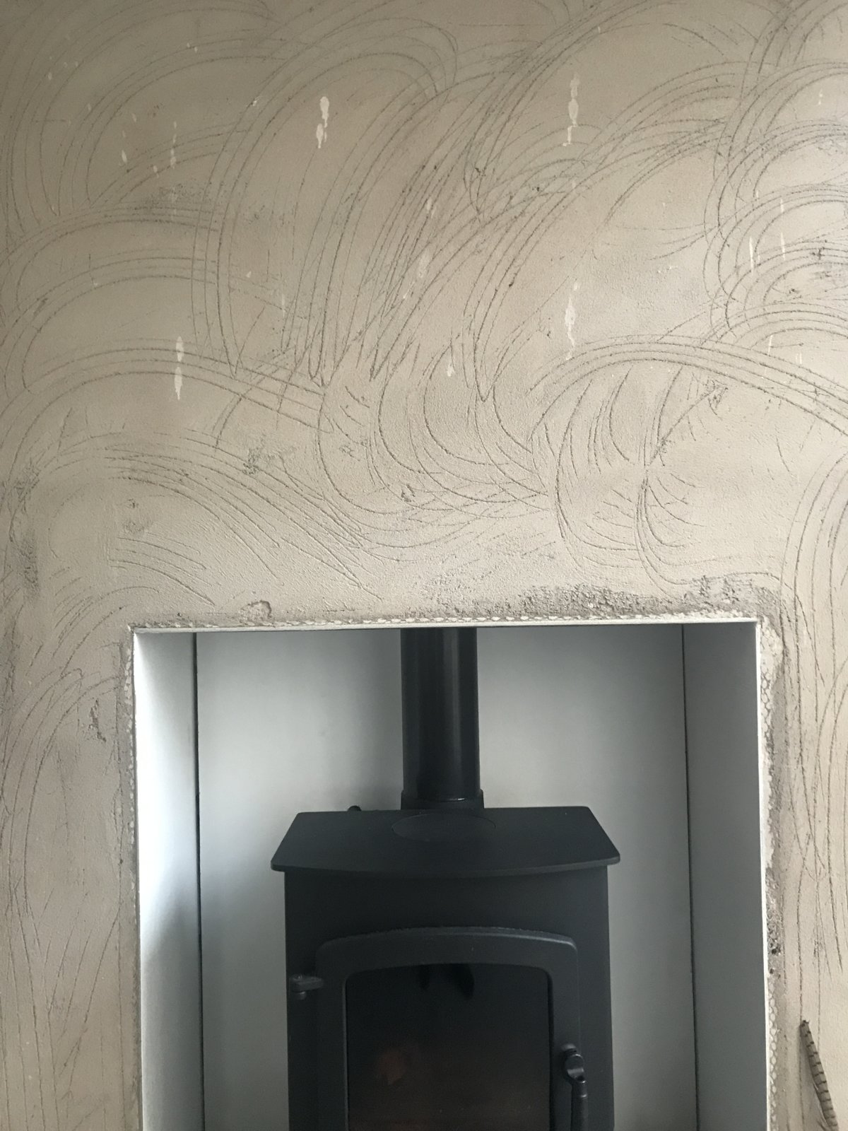

well what fooking flue is it ? take a picture further away so we can see what its connected too ;)
Its this fookin flue... vitreous going into clay..
