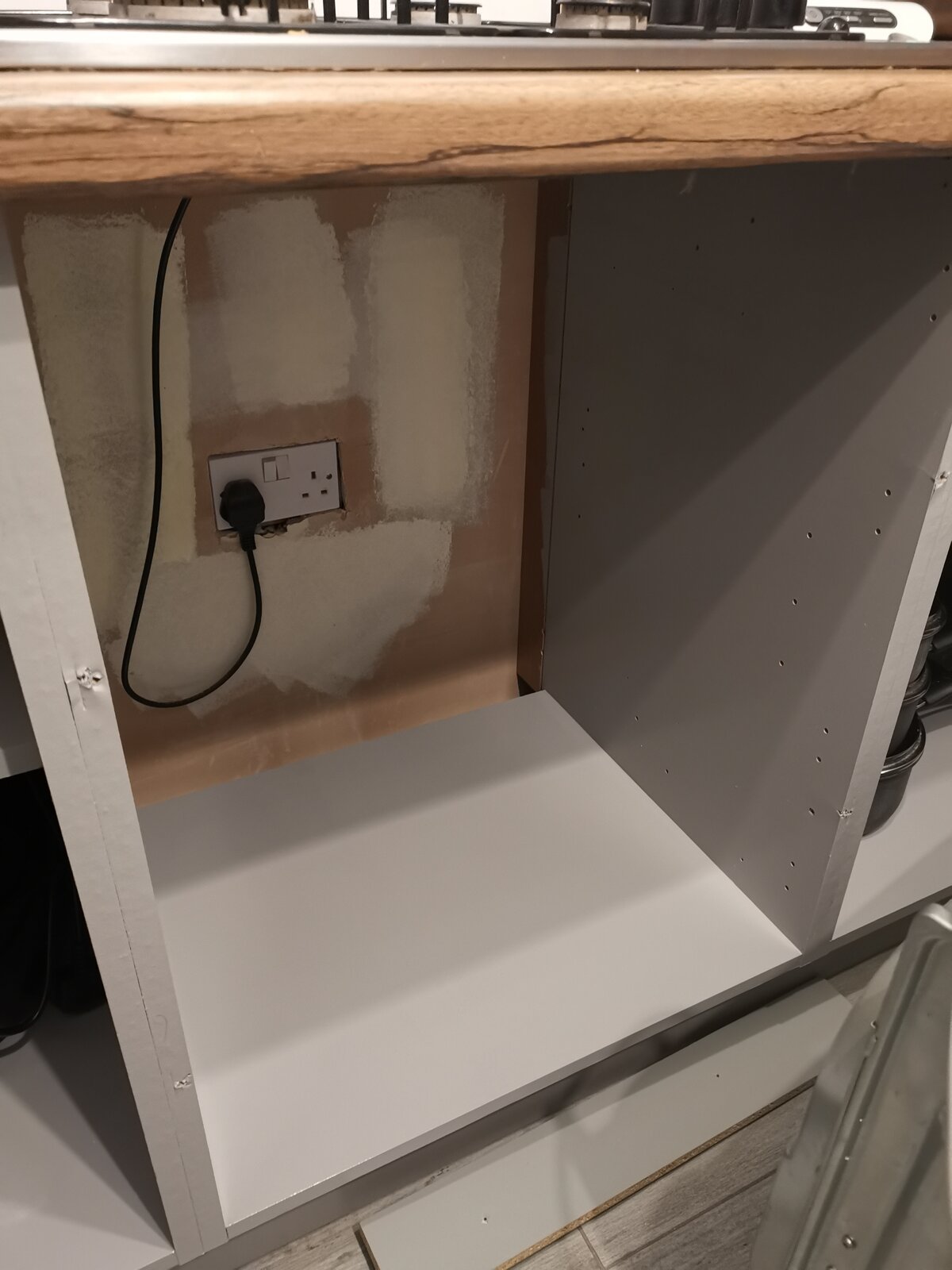

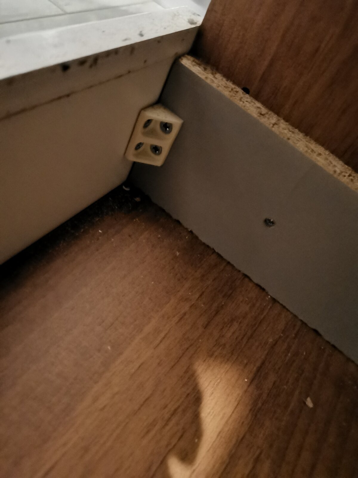

We've always wondered if we could use the bottom of the oven as a drawer for baking tins oven dishes etc.

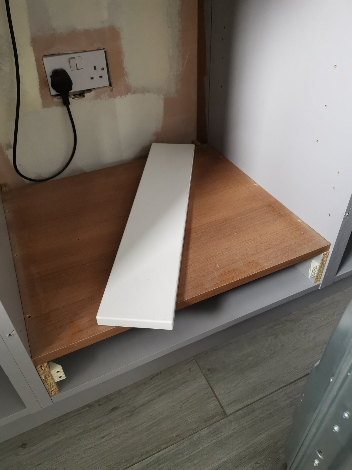

Took the oven out this evening and noticed that below the oven is a shelf so after taking out the screws we noticed there's space to put a draw.
Noticed the front is just screwed on but could we take the bits of wood at the side out which the shelf is sitting on and attach right angle brackets to support it instead? Leaving us to be able to get some runners and draw?
Noticed the shoddy plastering round the plug socket.
With the side bits of wood out it currently looks like this

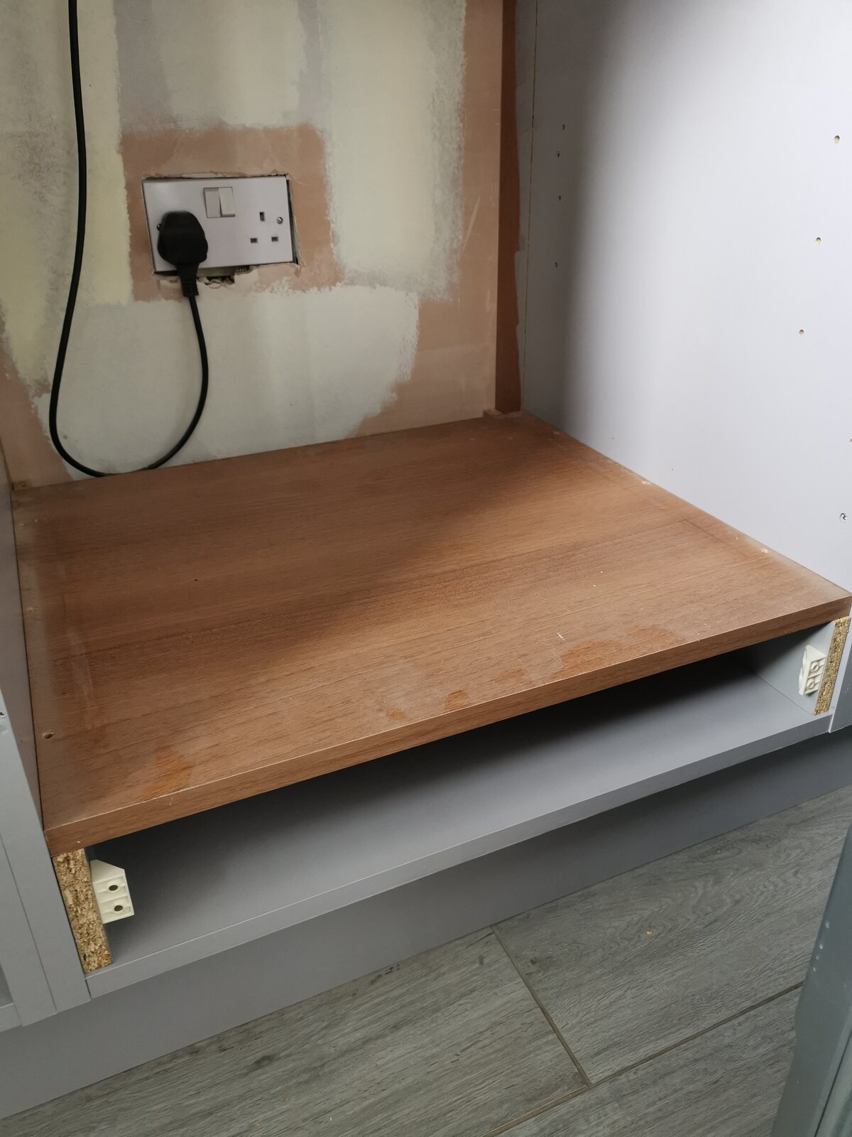

The 2 end panels are about 564mm hoping I can get a shallow draw if not ill magnet the front piece, just seems like wasted space.

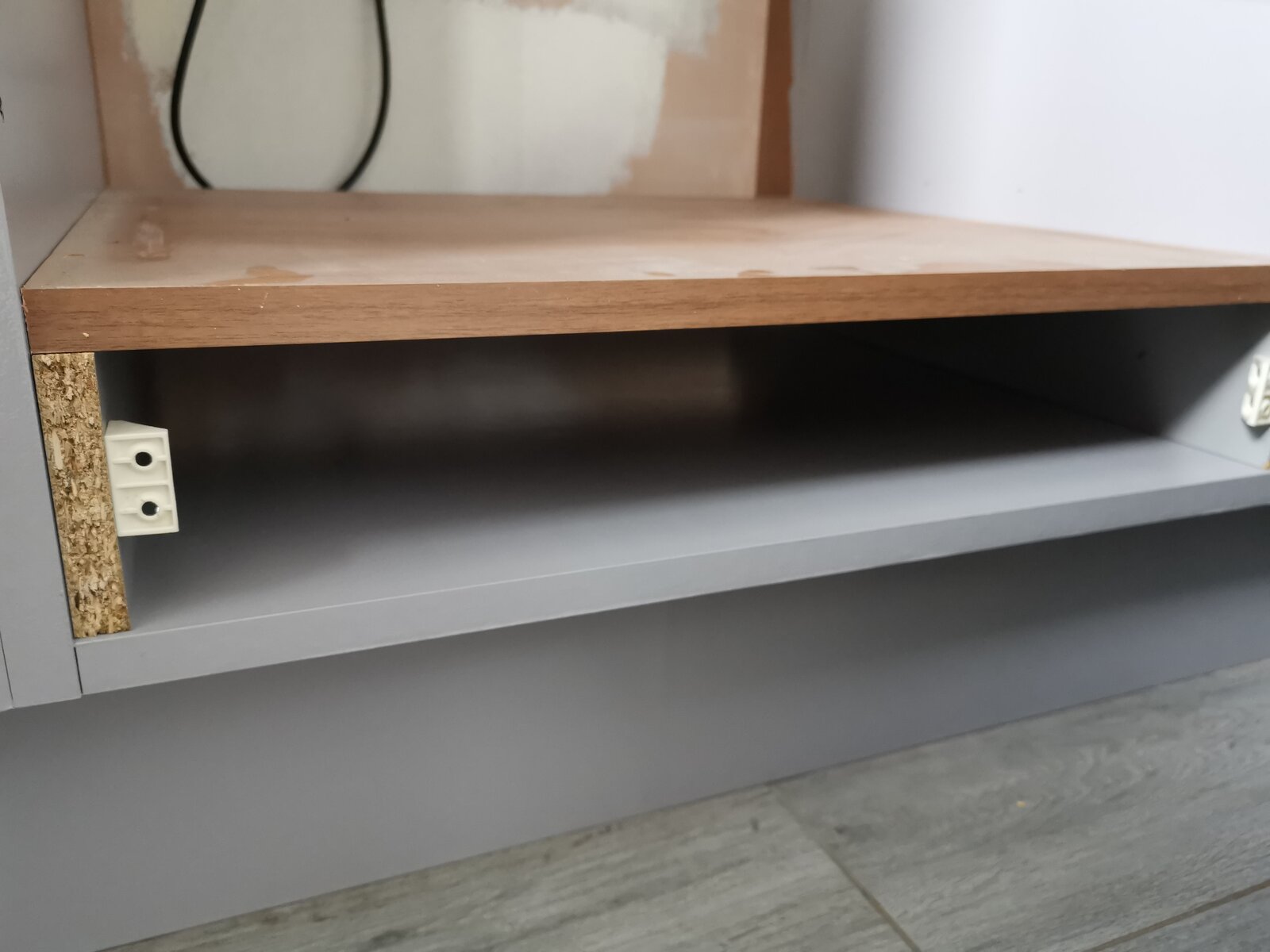

Does the shelf take most of the weight and is that why they've stood in on wood and screwed them to the cabinet sides?
It's just the kick space, which you can find under all kitchen units. So if you were that desperate for storage, you could adapt the kick space under almost any kitchen unit for the purpose. The reason kitchens normally don't use that space for regular storage, is that it is not easy to use being so low and inaccessible.

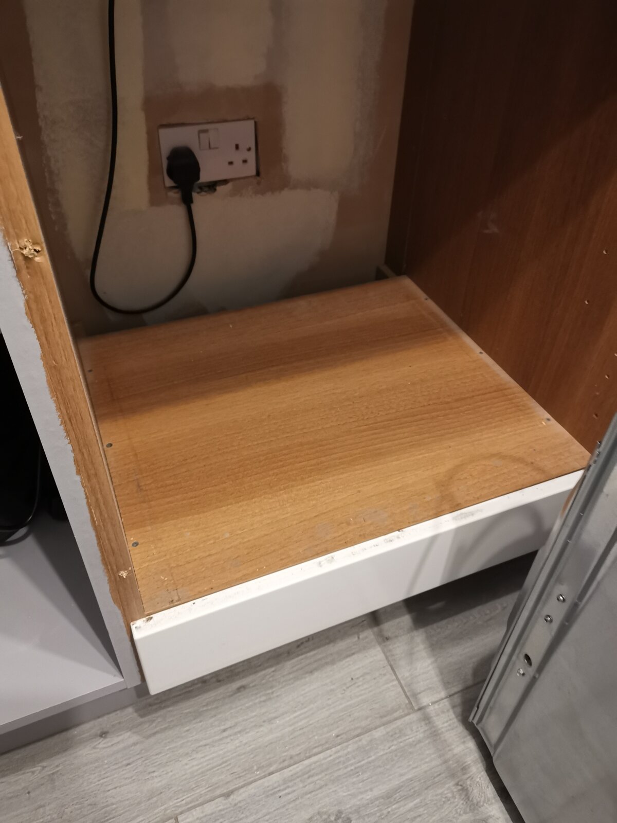

We've got the front this is what it looks like before I took the oven out.
I just want to know if I can do away with the wooden bits holding the oven shelf and attach brackets to hold the shelf instead.
The oven has never been flush with the worktop and could do with being raised a few mm

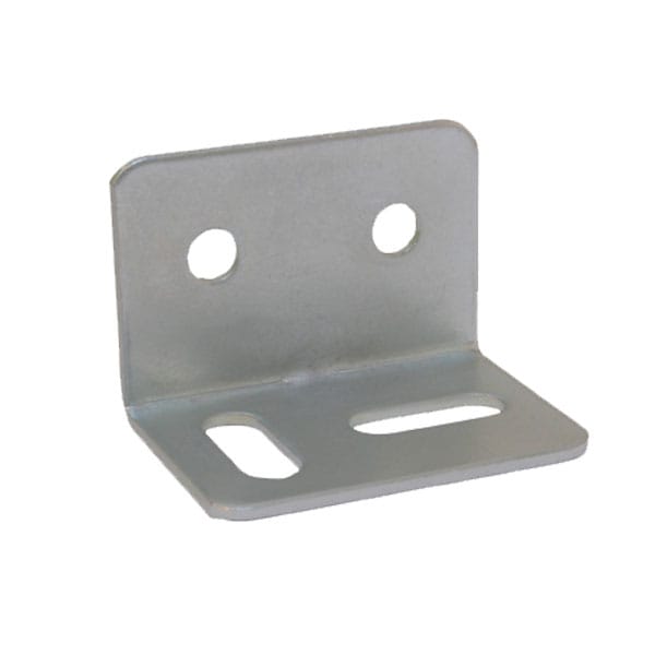

Yes, but the tyype of bracket you show is a repair bracket and nowhere near large enough or strong enough. These will just bend. amd in any case I think you'd struggle to get the back of the oven up onto the rear pair of brackets:

What you need is a pair of proper oven support brackets:
These are quite expensive (£25/pr), and not easy to come by, possibly because oven manufacturers generally supply with new ovens. In fact at that sort of price I'd be tempted to source some steel or aluminium angle bracket (metal section of a DIY shop or or an ironmongers) and drill/countersink half a dozen holes in each myself.
