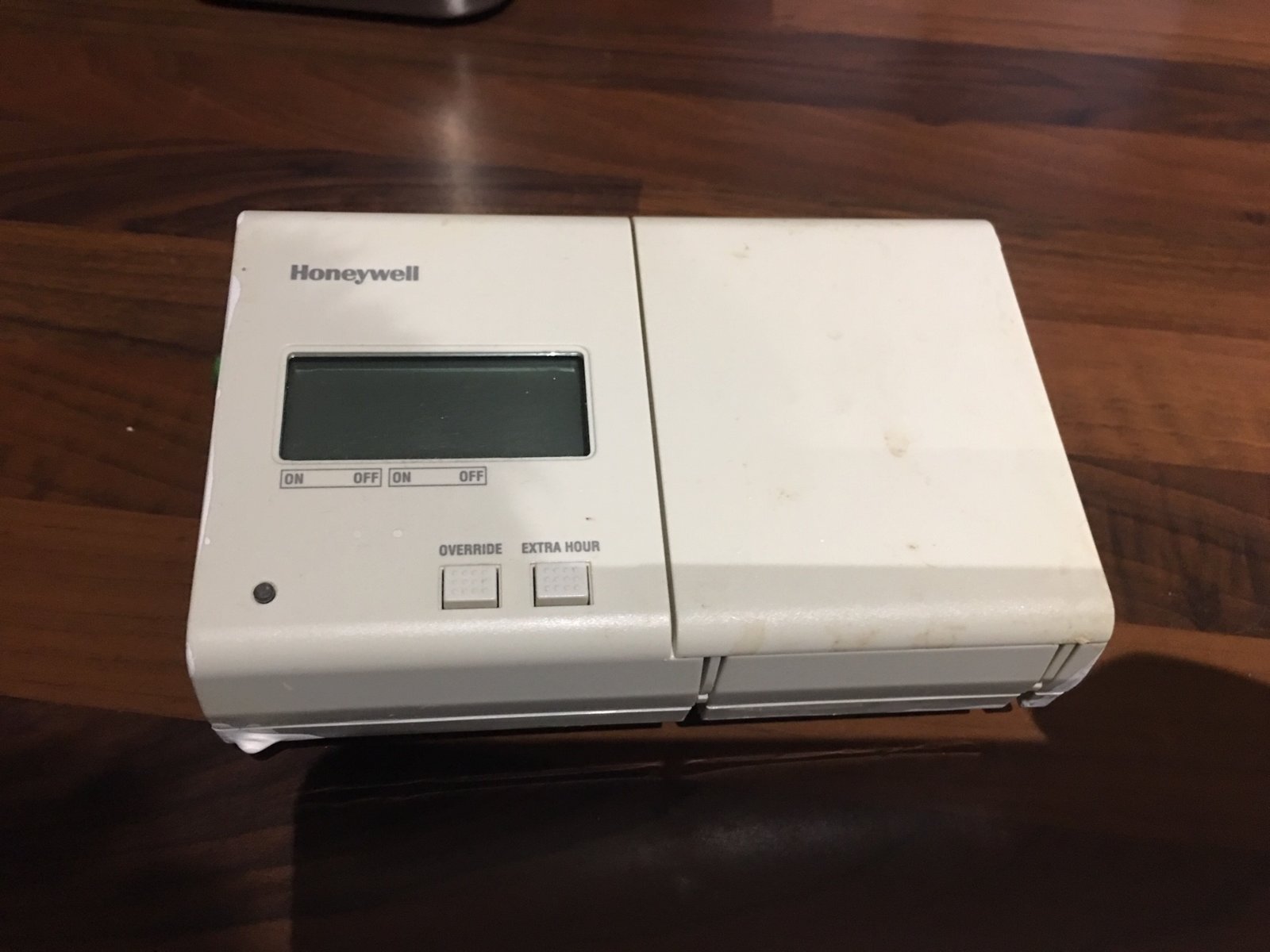

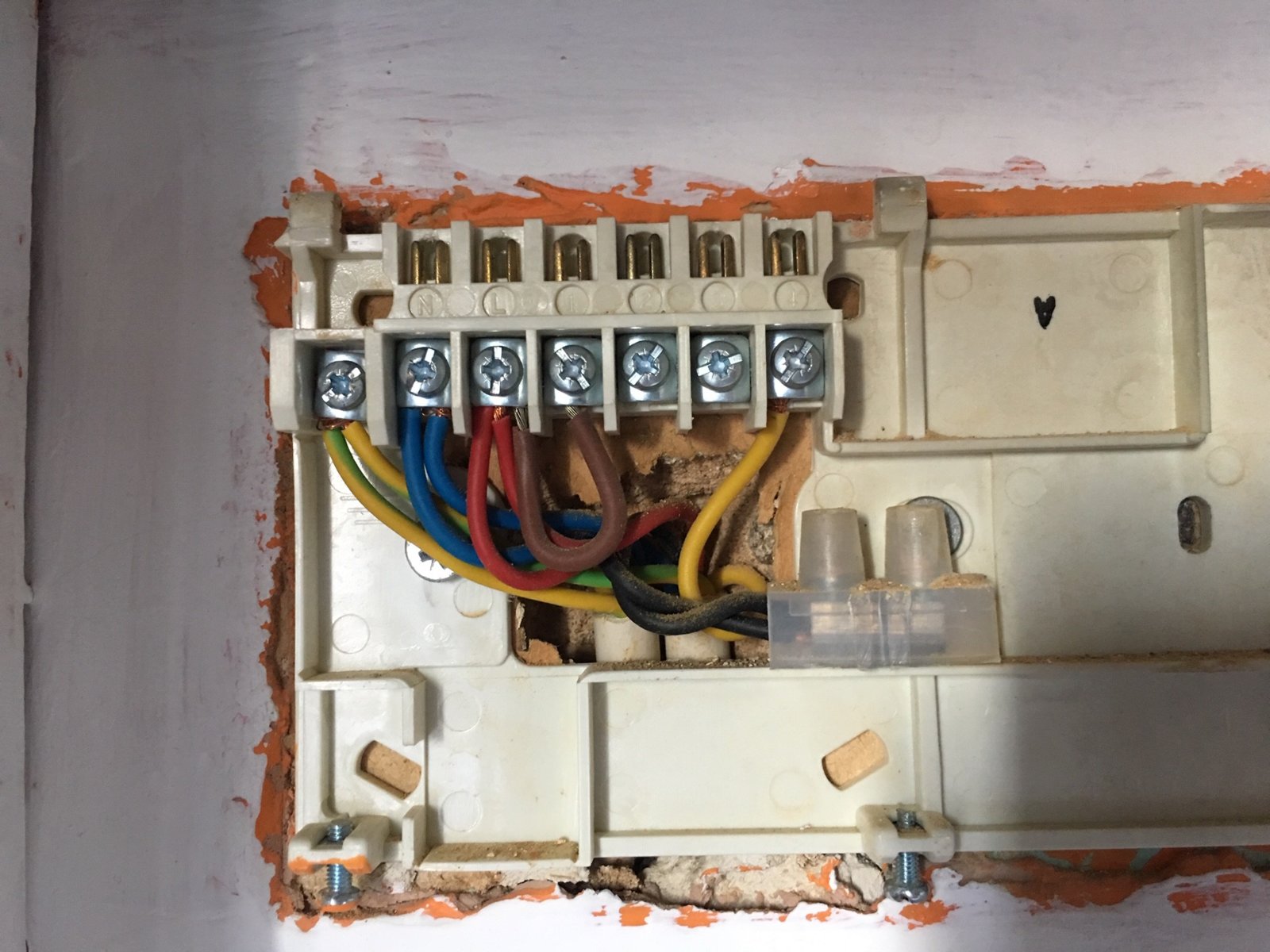

The image below is when I took off the Honeywell Timer.

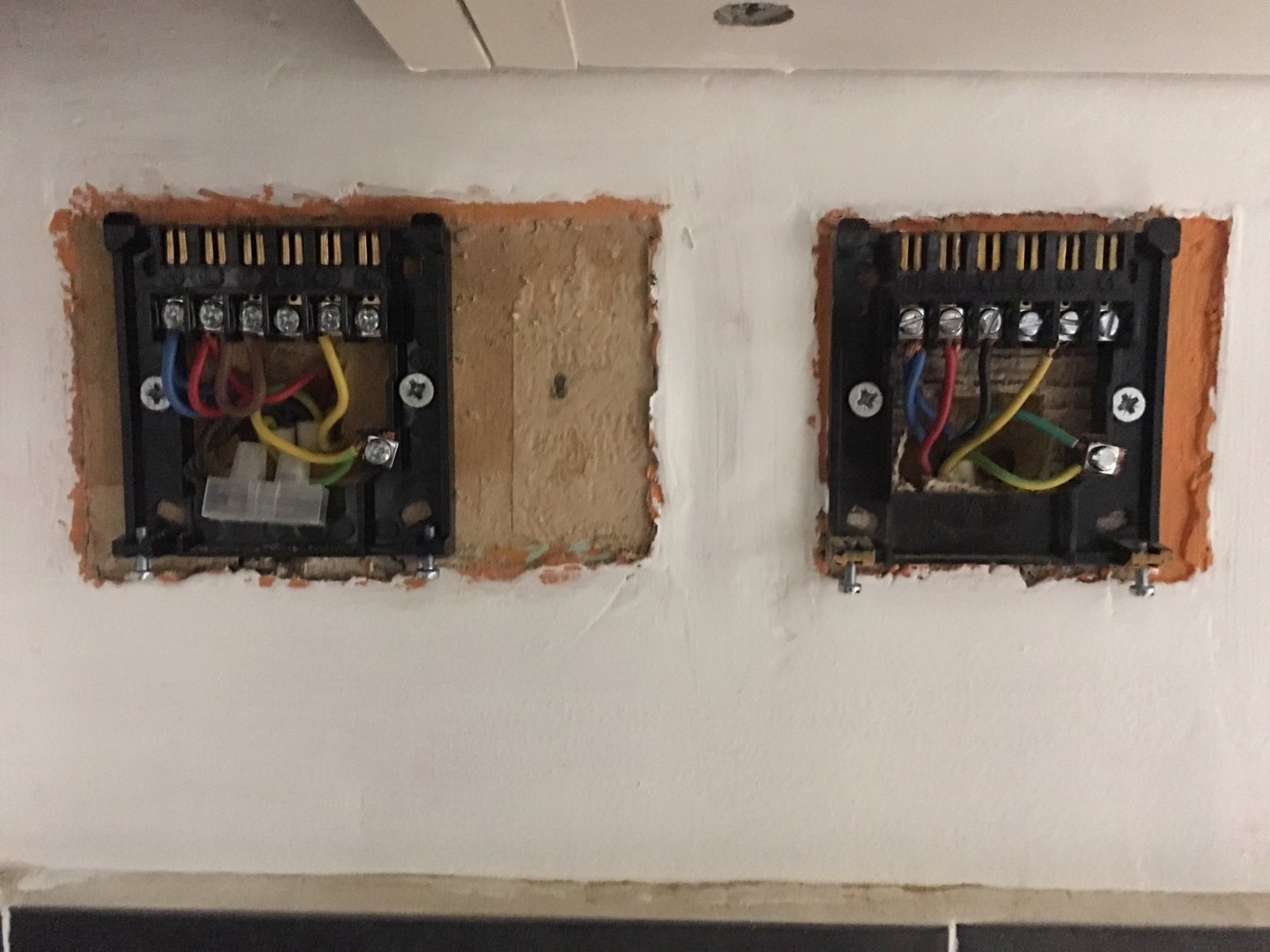

below is how I read the instructions :notworthy:

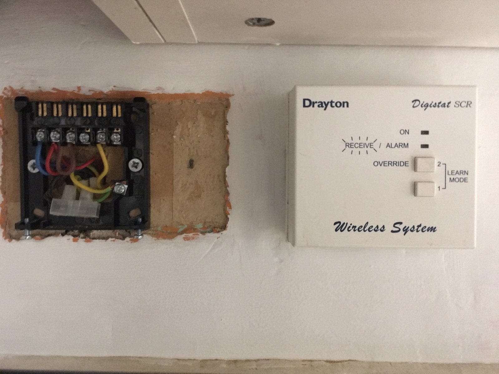

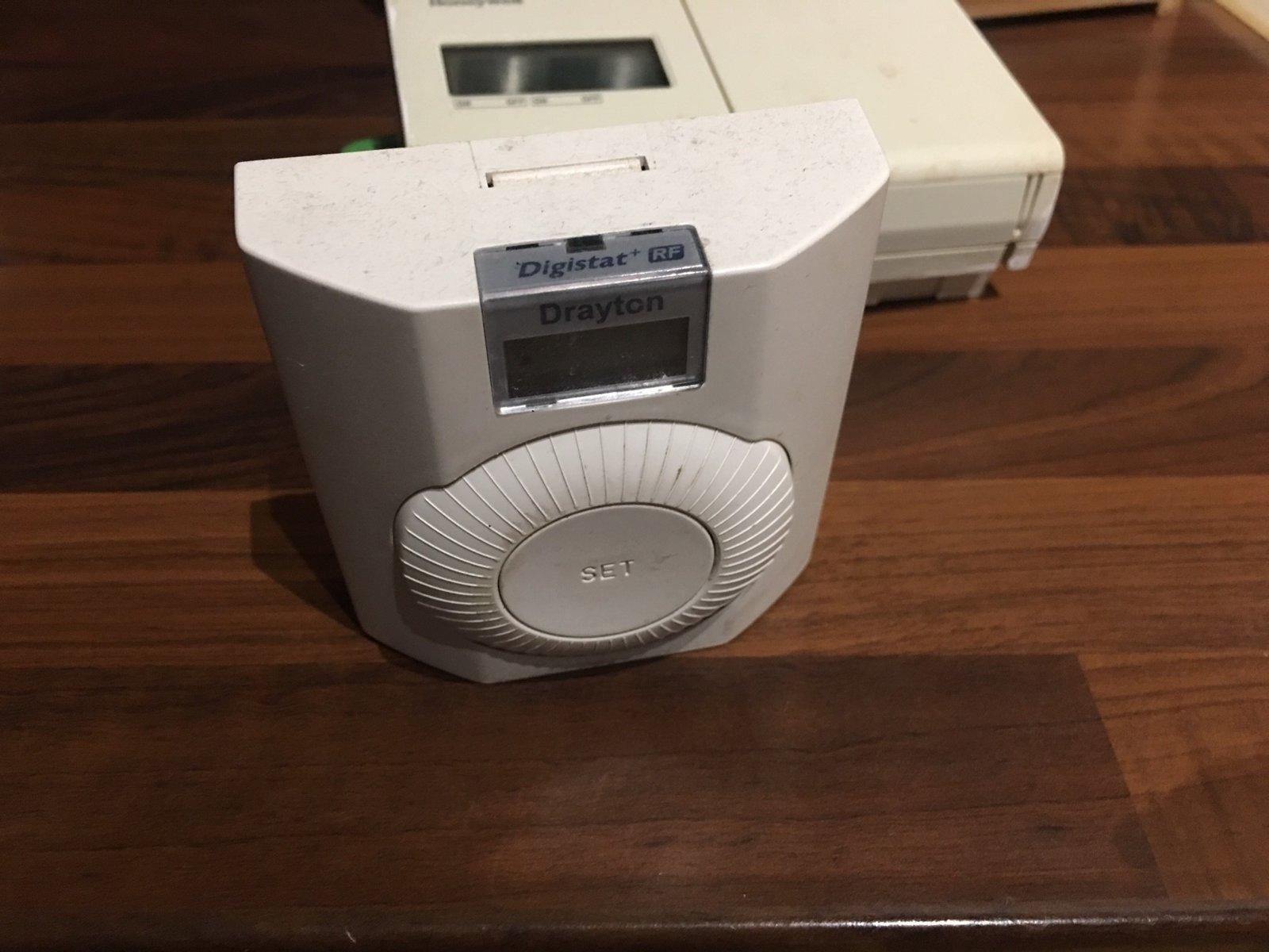

The image on the left is when I removed the Drayton Digistat+ RF
I am of the thinking I need to get rid of the Drayton Digistat+ RF but how? Do I just cap the ends and put a blanking plate on the wall?

Do I need to wire the old thermostat receiver into the new Drayton Wiser unit?
Any help would be great!
What is it your trying to do ? you posted pics of your old stuff but nothing of what you have replaced it with, could you post a wiring diagram and/or pics of what you have connected up.
Sorry for not posting an image of the Drayton Wiser I have, thought I added it on the upload.
This is the one I went with - https://www.draytoncontrols.co.uk/products/Smart-Heating/Wiser/wiser-thermostat-kit-2
The last picture in the 1st post is my wiring attempt for the wiring diagram I received in the box. https://wiser.draytoncontrols.co.uk..._24-11-17_t3612_wiser_instructions_issg_g.pdf
Thank you for the response Picasso. (y)
The black and yellow wires on the drayton receiver could be switching the 24v side of the boiler, if you stick 240vac on them you will fry the pcb, obviously you need to find out where they are connected in the boiler, if they are connected to the 240 side you can just connect them together and the boiler will work from the wiser stat.
