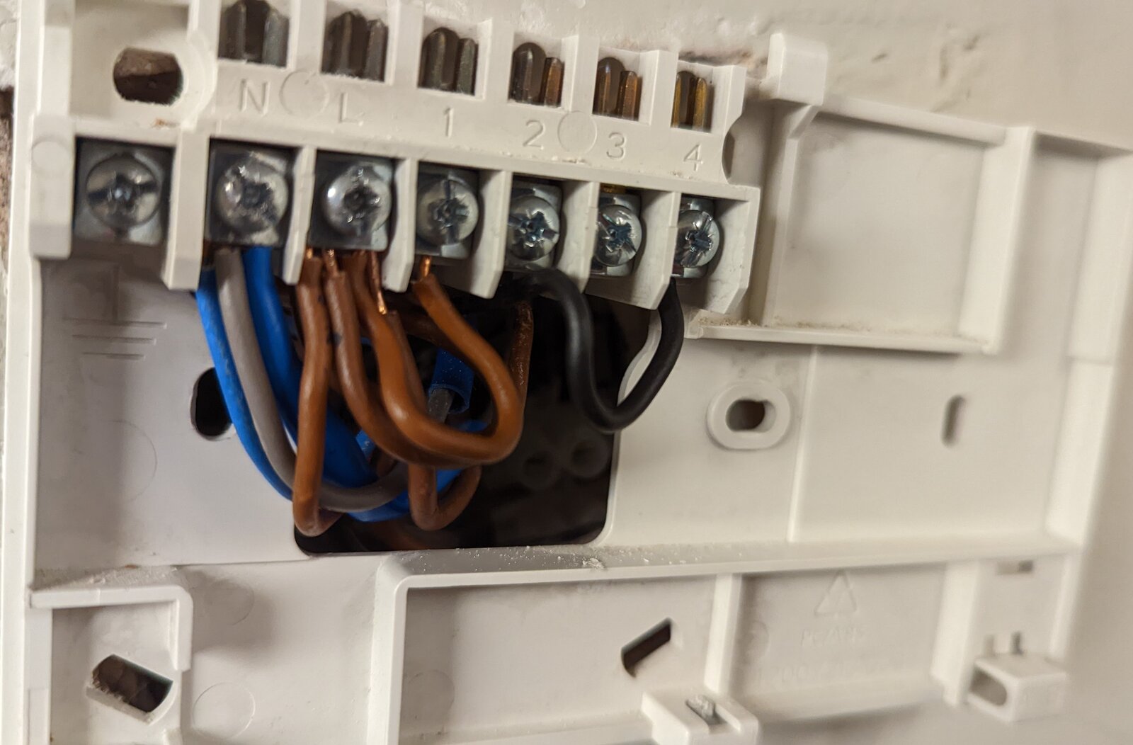

Hi, please can someone help me. I have tried for days but cannot do it.
Currently I have 2 zones and hot water run off a conventional boiler.
The sytem works perfectly with my ST9100C1006 and the 2 thermostats (CM927, and CM907).
I am looking to replace all with Drayton Wiser, mainly for smart TRVs. I opted for the 3 channels as I have the 2 heating circuits.
There appears to be 4 sets of cables.
The cables on the left appear to be live (240v).

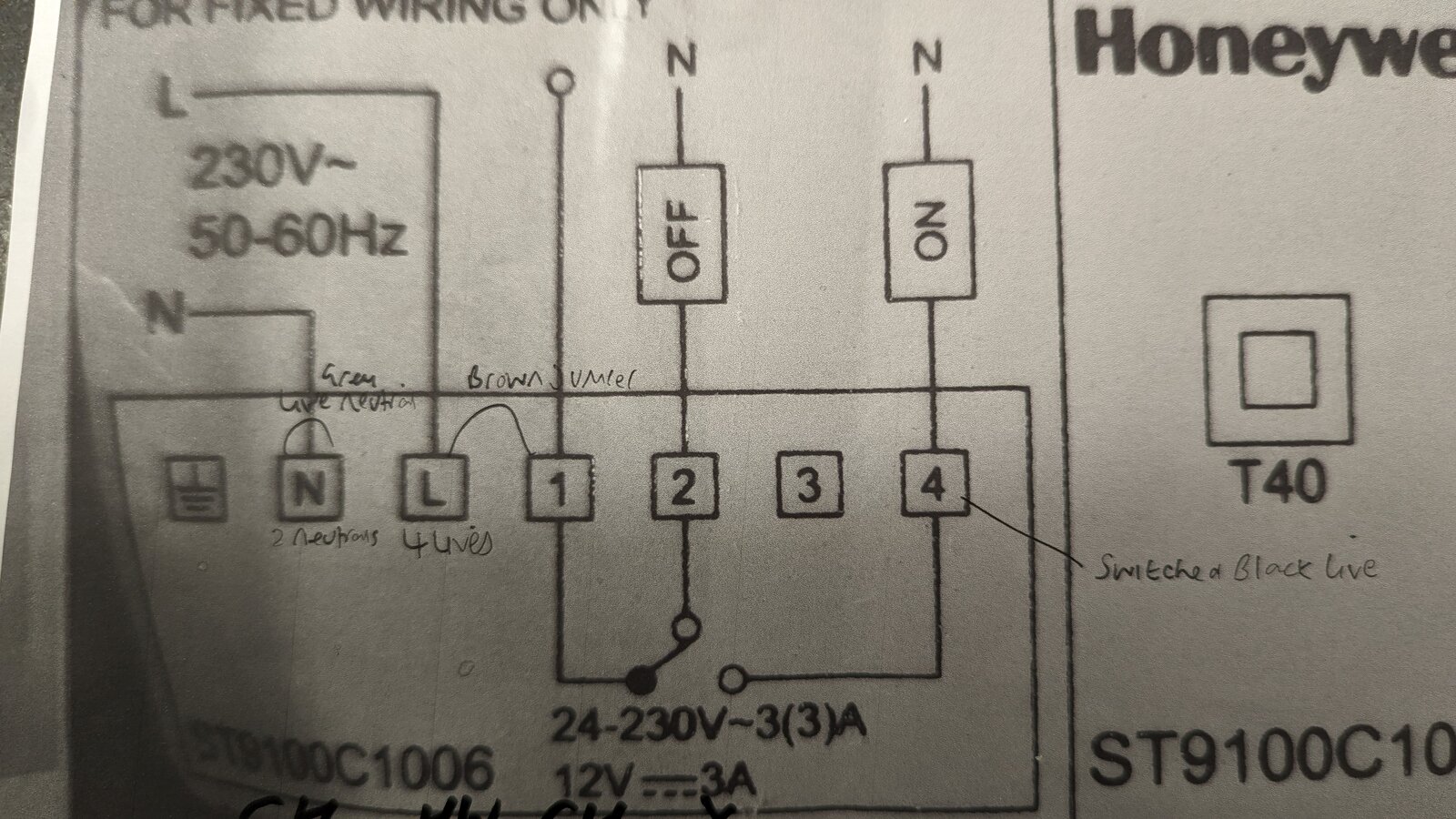

In the ST9100C1006, all the Live cables go in Live, all the neutrals in Neutral (including one grey cable with blue sleeve), and a black cable with live sleeve is in the end port marked "Neutral ON". There is also a jumper cable between Live and 1.
Cable layout needed for Drayton Wiser 3 channel
Thanks in advance.

Sorry, I wasn’t sure if you had wireless programmable thermostat’s. If all the wiring for them is in that photo where all the lives are, then it’s just a case of figuring out which wires you need and don’t need. The Wiser will take care of the switching, which are your a and b on the bdr91, so you can probably lose a few of the permanent live and neutrals.
Figure out which is the main permanent live and neutral, and then just figure out your switching for the heating and hot water and you should be ok with the Wiser 3 channel.

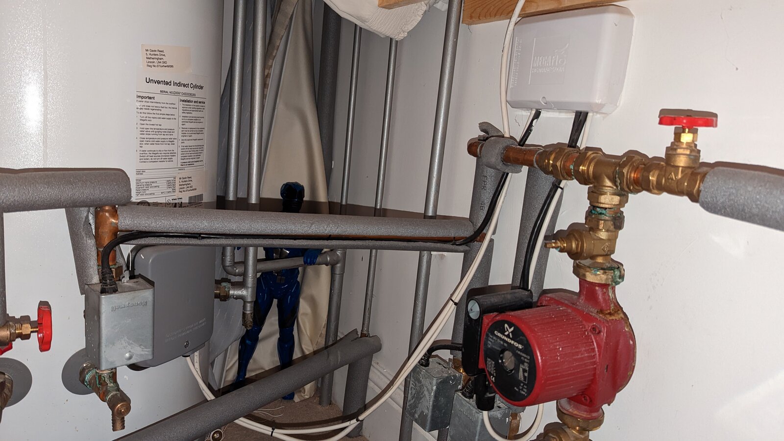

Before looking further, my question is what controls the DHW? Have you got some cylinder with hot water in, as to date seen nothing to show how DHW is controlled.
We have a megaflow, run by the ST9100C1006 (that I am looking to make smart)
That picture shows all three motorised valves and it would seem that's where the Wiser unit should be fitted.
Thank you so much - this way seems easier, as the cable layout inside the Megaflo is a lot clearer.
So to confirm, the "motorised valves" are those the "honeywell metal boxes" (makes sense as the timers are Honeywell, also there being 3 as its a 2 way CH system + HW).

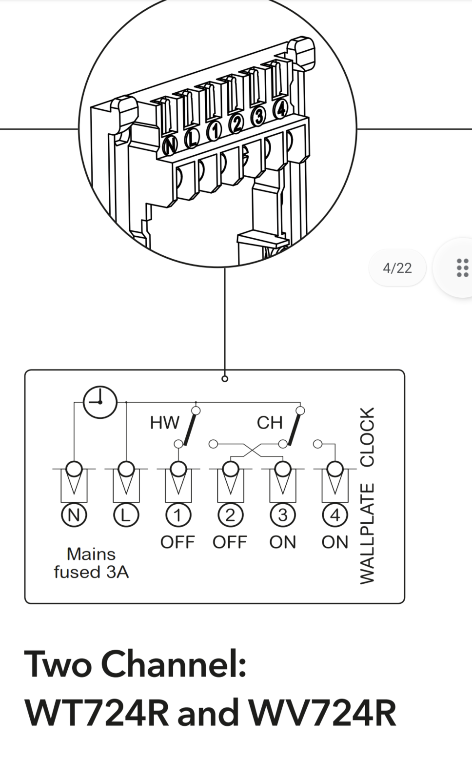

I need a 2 way Wiser (not my 3 way), and connect the HW and just 1 CH + add my smart TRVs to all rads.
The cabling for the Wiser (when I get it) will be links from L+N + presumably 2 cables, HW and just 1 of 2 CH).
Do numbers 2 / 4 in the Wiser diagram need cables?
If that is correct, can I then remove all of my Honeywell equipment?
Thanks.

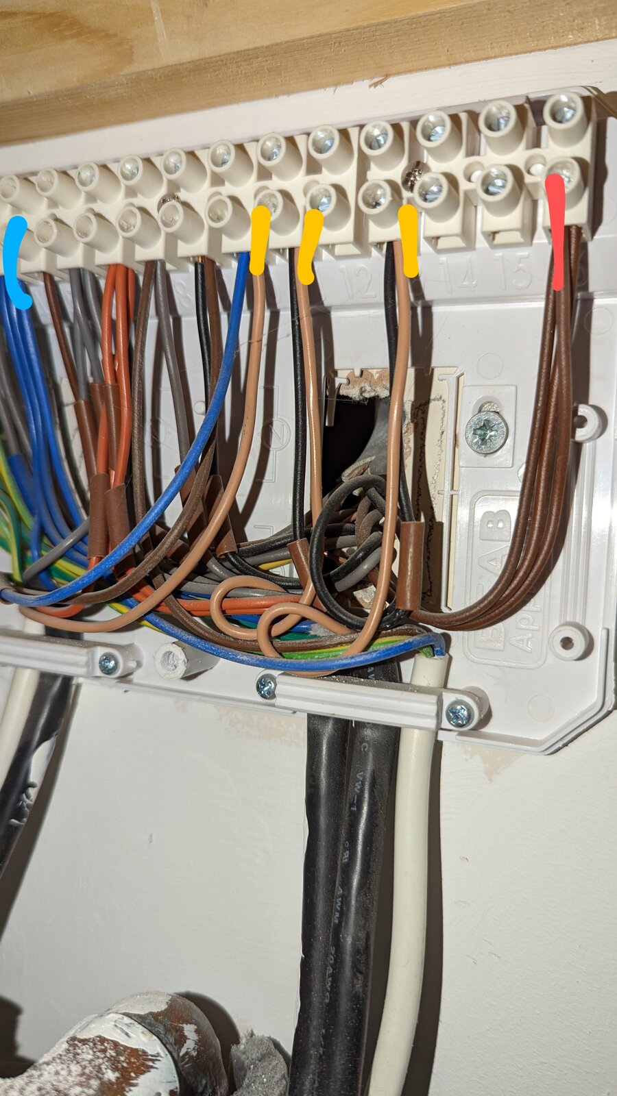

My 2 way Wiser arrived, but somethings wrong, the gas hot water boiler isnt igniting - but is instead (I believe) powering on the immersion heater.
I obtained the cables direct from my Megaflo. I have not removed the megaflo cables, but instead added a cable to the top part of the corresponding terminal strip.
I connected both N + L to the Wiser, as well as the red circled wire (which is hot water - when this is disconnected my gas boiler will not ignite) to No.1 of the Wiser.
I have not added any heating cables yet, as I wanted to do 1 step at a time. Incidentally the actual water timer (ST9100C1006) is in another room.
Any help would be appreciated. Thanks.
