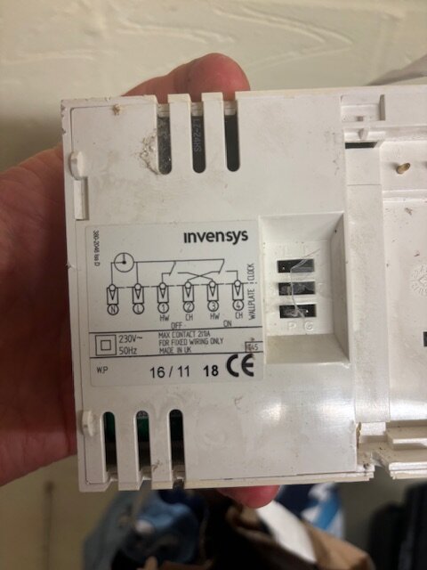

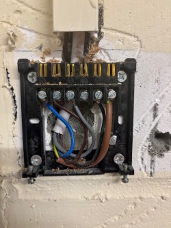

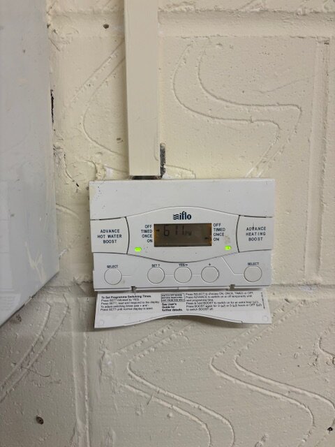

Hi all,
We've just moved into a new home and want to install a Drayton Wiser heating system here. I installed it at our last place but understood the plumbing set up a lot better and it was much simpler!
What we have is a combi boiler, as well as a hot water tank, and I think a cold water tank in the loft.
Firstly, is a Drayton Wiser system possible on this type of set up? I tried to use the product selector on their website and it seems to say yes, if it's pumped but not if it isn't? Is that correct? If so, how would I find out if it's a pumped system or not?
Secondly, if it is possible I'm assuming I would need a wiser 2 kit?
Also, if we were to add some wet underfloor heating, would I need to consider anything else?
Lastly, if it's not possible, are there any alternatives for a similar kind of system?
I've attached a photo of the boiler programmer in case it's helpful.
Thanks in advance!
Are you sure you have a combi?
What is the boiler make/model?
The existing controller seems to be setup for a Y plan system.

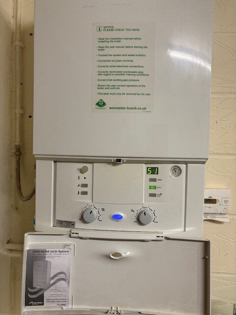

I think so, but could be wrong! We only moved a couple of days ago so just getting familiar with it all! It's a Greenstar 30CDi system.
Photo attached
Photo attached
The Greenstar 30CDi comes in many flavours!
Could.you show us a better pic of the user manual?
Sure. See photo!
Yes, not a combi! :)
A Wiser Kit 2 should be a direct swap-out of your existing programmer; possibly even fitting on the same backplate, with no wiring changes.
For future upgrades, I.e. adding underfloor heating, you can add an extra Kit 1 - it's not worth having a Kit 3, as although it includes control of an extra zone, it doesn't have the Hot water off terminal that your Y plan system requires.
You also have the option of adding smart TRVs, should the budget allow.

So is this a condensing boiler not a combi?
Yes, it's a condensing boiler, not a combi.
And presumably the system I described is a gravity fed system? Presumably not likely pumped?
Only you can tell what system you have, as only you can find all its components!
Although I can't confirm anything, your controller suggests you have a pumped Y Plan system, and the boiler pressure gauge, being at 1.7 bar, suggests a sealed system - your cold water tank in the loft may be redundant, or not related to the heating system.

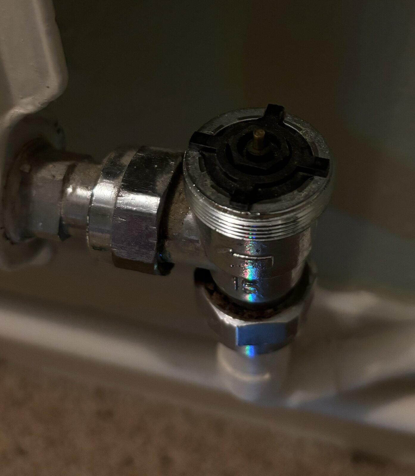

Morning,
I managed to get this installed lastnight (thanks for the advice so far) with ease but just had a few questions.
- is there an adapter you get buy so the TRVs fit a valve like in the attachment?
What would happen if you had 2 room thermostats in the system? Which would the controller/ boiler listen to?
And lastly, can the Drayton smart plugs act as WiFi signal boosters between TRVs and the controller?
Thanks!
See attached.
