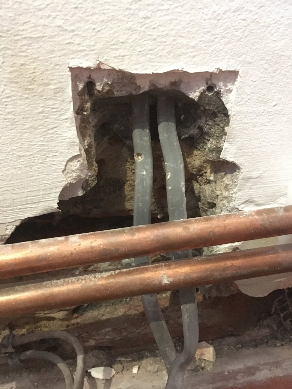

Drilled into cable - repair advice
Would it be possible to put a box over where you drilled the cable, you can often get enough to Thru crimp the cable
I didn’t want to terminate the ring as I’d end up with a spur off a spur. But guess I could go for this approach if I used 4mm cable from the JB where the ring is terminated to the first socket. Then leave the 2.5mm connecting the two sockets. Would that be acceptable? I’m not sure what the benefit is if I’m already replacing one cable it’s easy enough to do 2x2.5mm and maintain the ring.

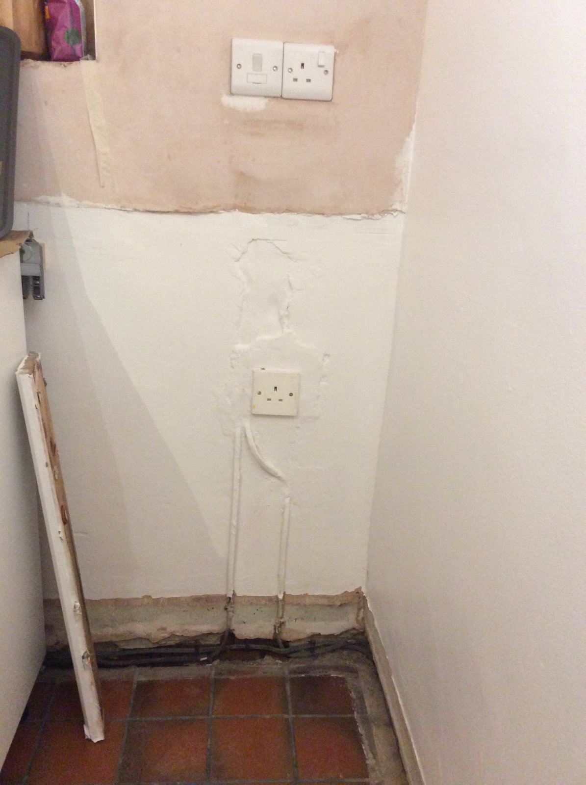

Chasing a new cable from the previous socket would be a pain but is possible. I would still need a JB to reconnect the cable back to the CU though. I guess one JB is better than two!

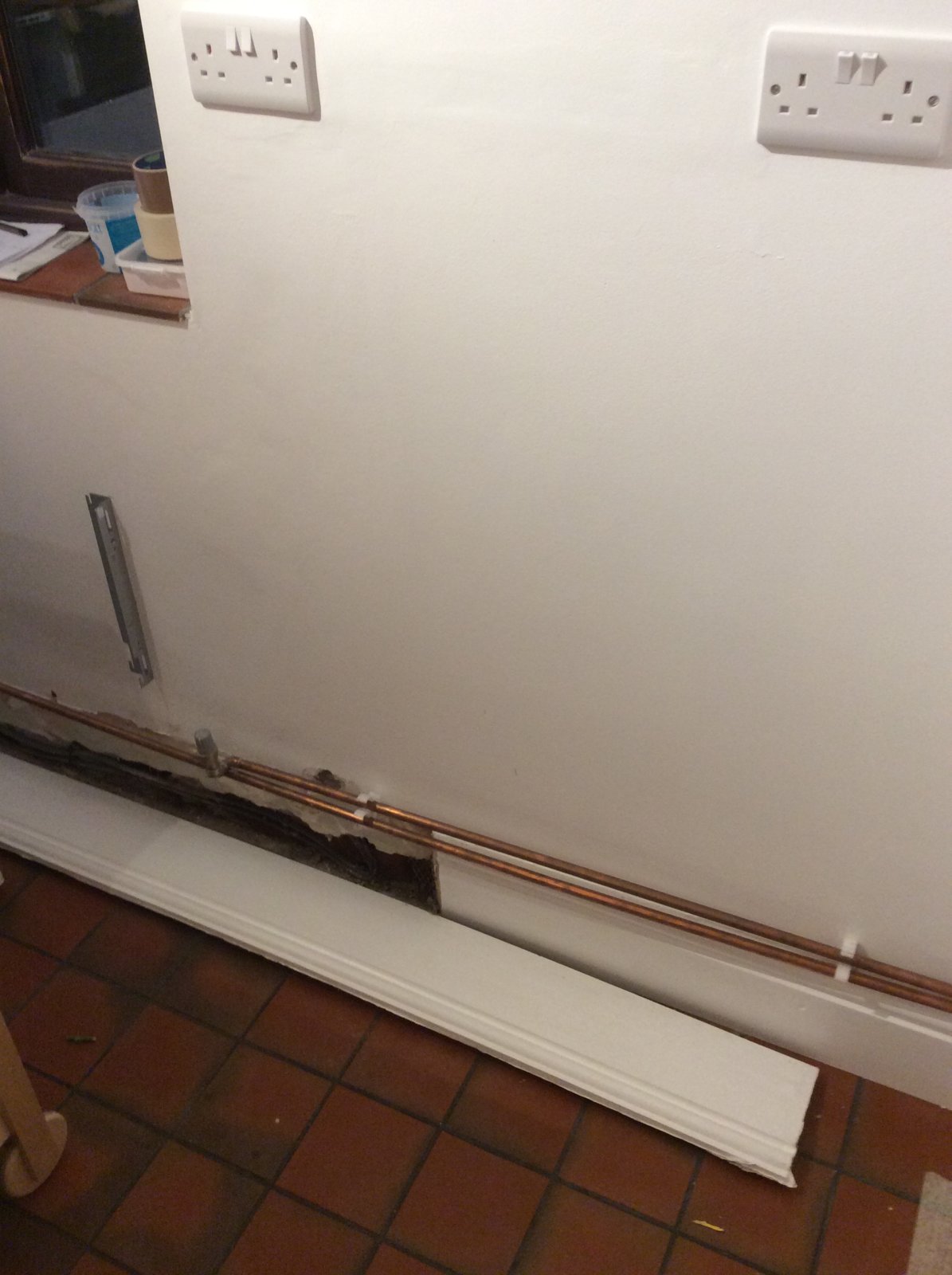

Pics attached. Offending hole is by copper pipe. The two sockets are on the same wall but the one on the right has plasterboard behind it (old bricked up doorway). Second picture is the previous socket.

I was thinking I might have another go at exposing the damage and seeing whether it is just one cable. If I could get access and reconnect the damaged cable I could cut a hole in the back of the cabinet that will go in front of it so that’s it remains accessible.

Just seen your recent pictures; where is the hole you have drilled?
Fair enough, I was trying to keep it as close to the original circuit as possible I guess but the 4mm option would be preferable as could be done with just one JB. Thanks.
The hole is directly below the left hand socket behind the copper pipe.

Had another look at it today. Managed to hack away enough to expose the damage. Definitely not soft plaster!! :LOL:
Only one cable damaged, long cable returning to the CU so no chance of replacing that.
I think I can remove enough to put a JB on the wall near the damage, cut & strip the damaged cable and reconnect. Should be enough slack.
Hopefully problem solved. Cheers for the advice (y)
