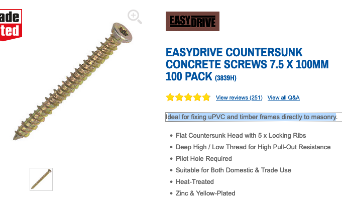

I'm planning for my garage conversion over the coming weeks. The first area for me to clarify is whether I should be drilling screws through the timber frame straight into the single leaf wall. If I do so, wouldn't I be compromising the moisture barrier that sits against the brick wall by making holes not only in that, but also in the brickwork it is supposed to be a barrier from?
Also is the any use in painting the interior brickwork with a DPM solution if I'm going to be using a membrane anyway?

So drilling through the timber batten to secure it to the single leaf brick wall. The membrane which sits against the wall is the DPM which is what will be punctured via the screw (not the vapour barrier)
If this isn't to be broken how do people secure the timber stud work to single leaf brick walls?
Q:
Also, if battens are not secured to walls, what are screws like this for: https://www.screwfix.com/p/easydrive-countersunk-concrete-screws-7-5-x-100mm-100-pack/3839h
A: Window Frames.
When SFix say:
Ideal for fixing uPVC and timber frames directly to masonry
they mean
Ideal for fixing uPVC and timber window frames directly to masonry
Build the stud work independent from the external skin, leave a 50mm airgap, fill with insulation, then vapour barrier stapled to warm side of stud.
