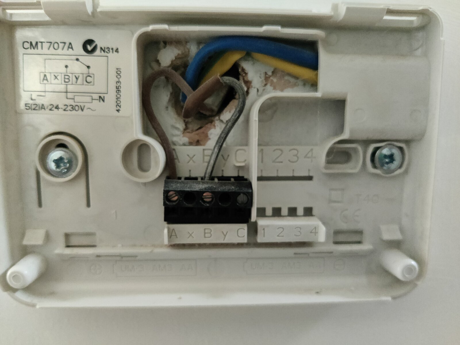

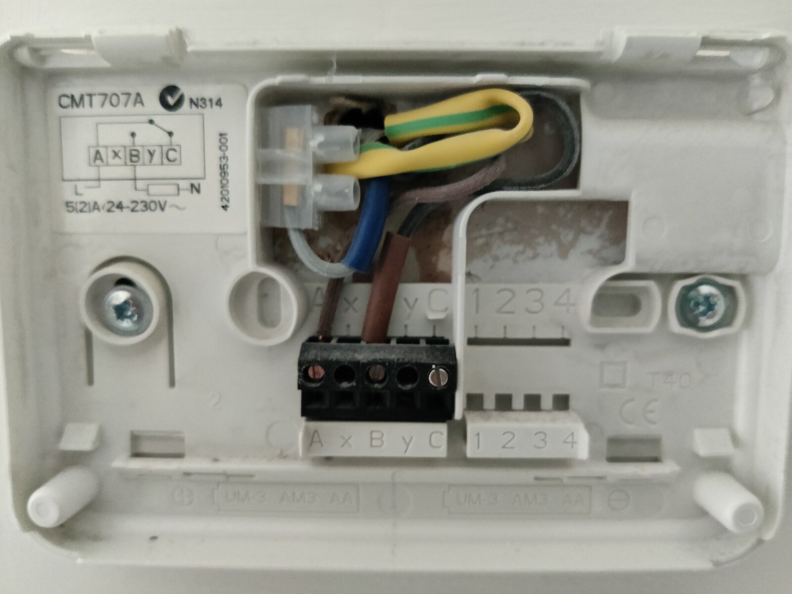

Looking to fit a smart thermometer at home. House was built in 2016 and has an Ideal Logic 35 combi boiler and dual zone Honeywell CM707 thermostats currently.
I'm looking at Nest E (or v3)
Could someone explain the wiring for me? The A wire doesn't seem too common in installations / wiring conventions and I don't want to get it wrong.
I appreciate I'll need two nests for to it being dual zone but just looking to install one first.
Downstairs stat:
Upstairs stat:

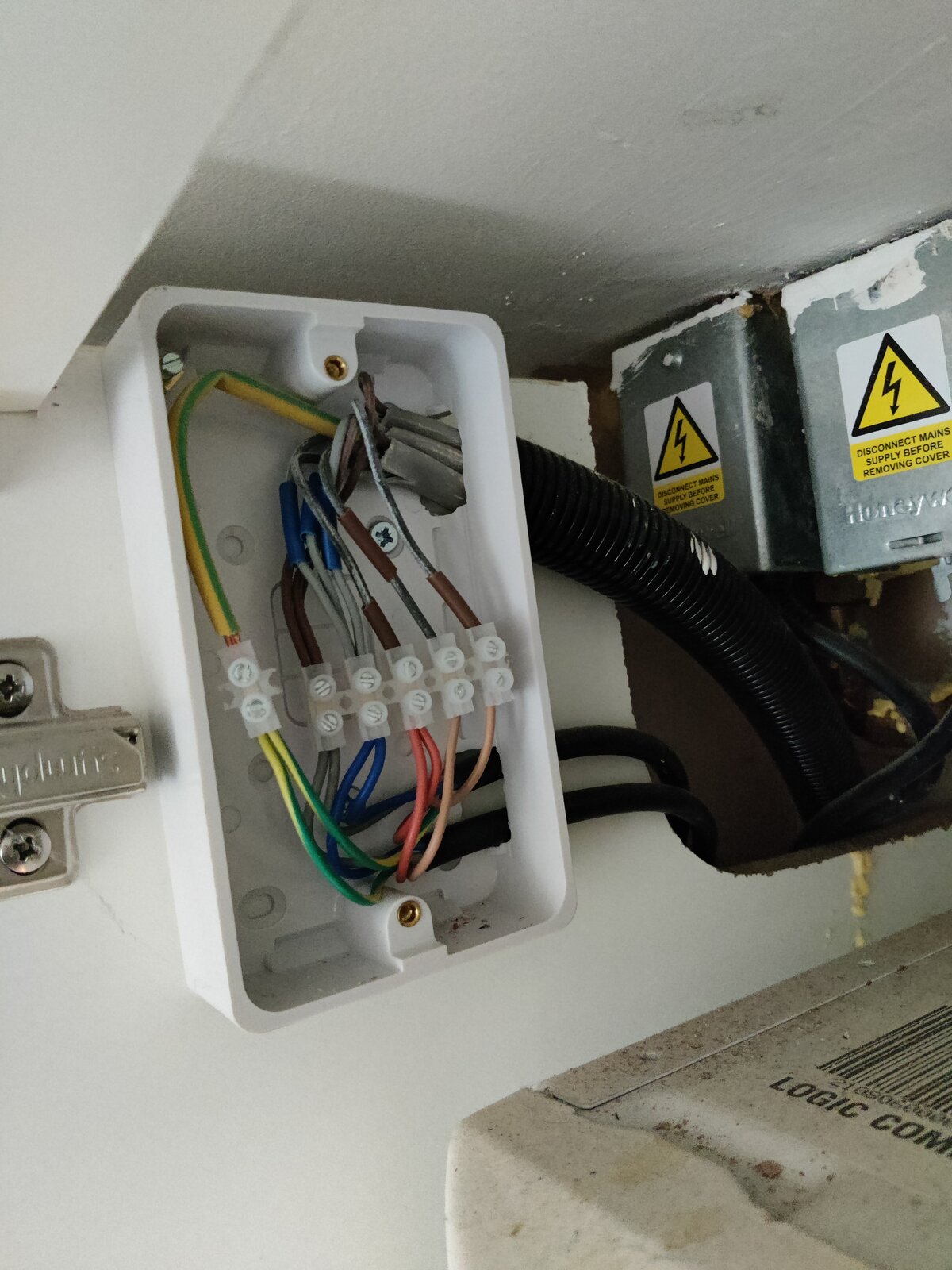

Junction box by boiler
Boiler wiring:

Great to provide photos, but if you’re going for the Nest E battery operated one, then it’ll just be a case of transferring the wires the same, live and switched, so A to Com and b to NO.
28 Nov 2021
2
That's great, thank you.
What about if it was the v3?
I think she prefers the v3 for looks, so might have that downstairs and the E for upstairs where aesthetics will be less of a concern.

It would need the heat link to be installed by the wiring center (junction box) and x2 heat links would be required.
