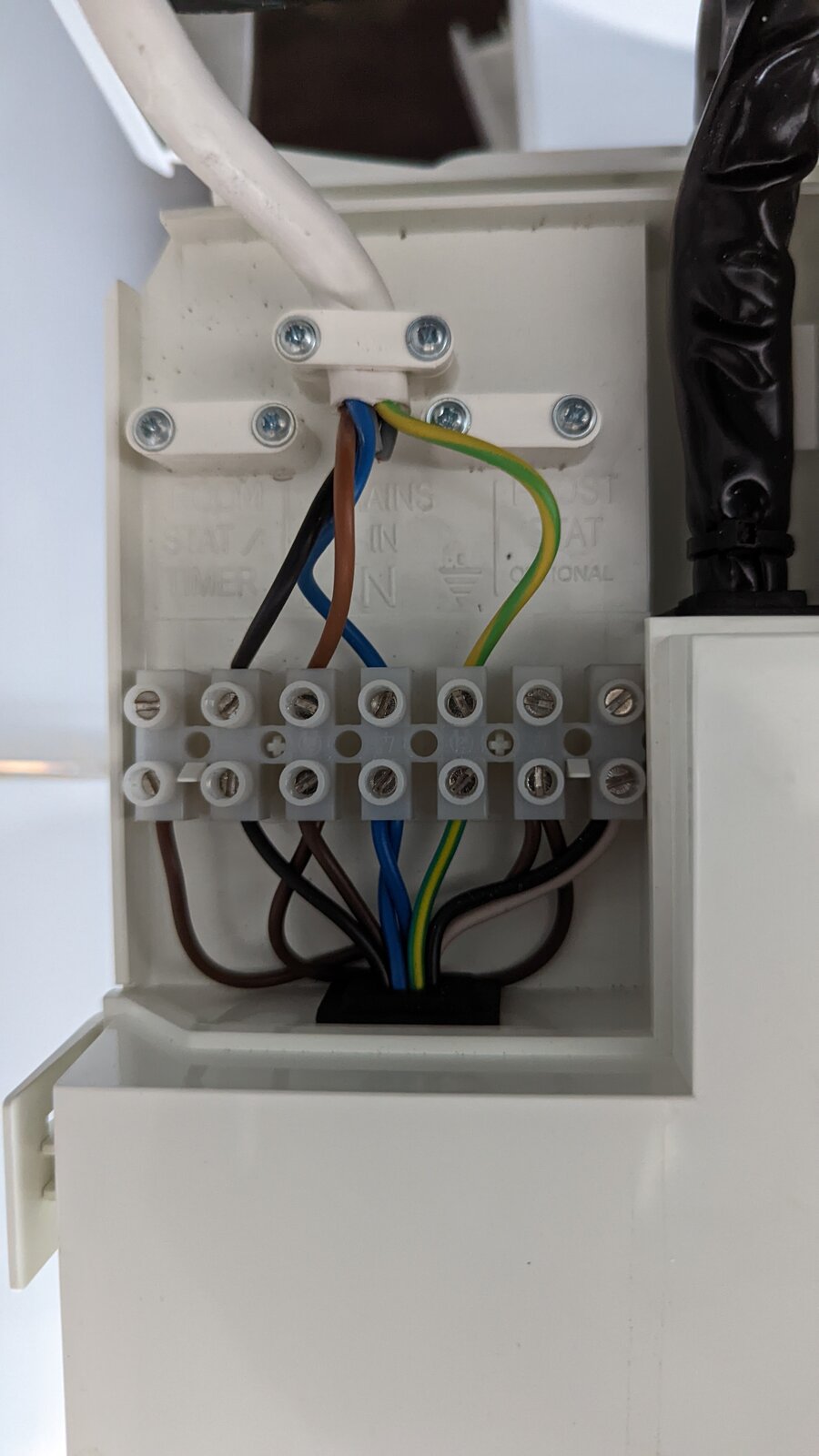

Where am I likely to find the wiring centre and zone valves? I've had a look around the boiler in the cupboard it's fitted in and the only thing in there is the boiler.
Follow the white flex that enters the boiler, where does it go? Any photo may help.

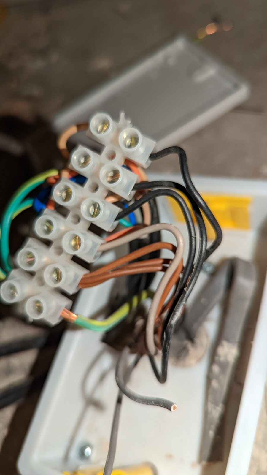

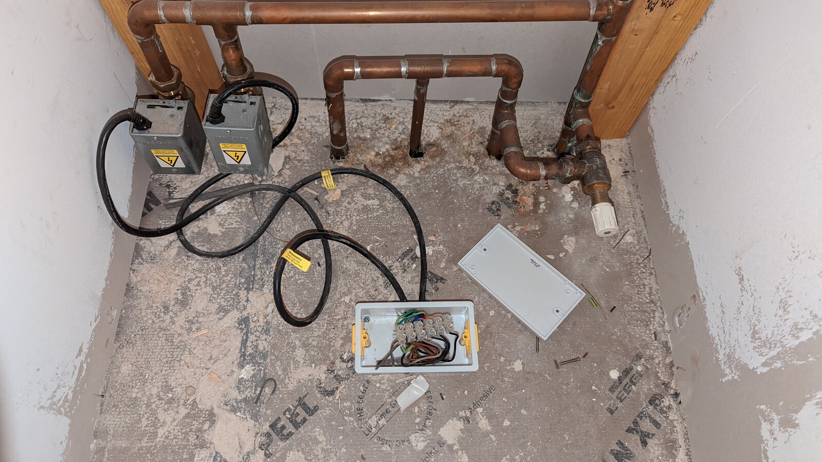

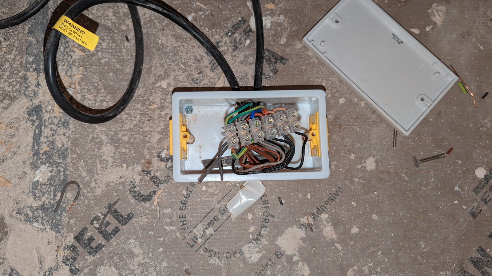

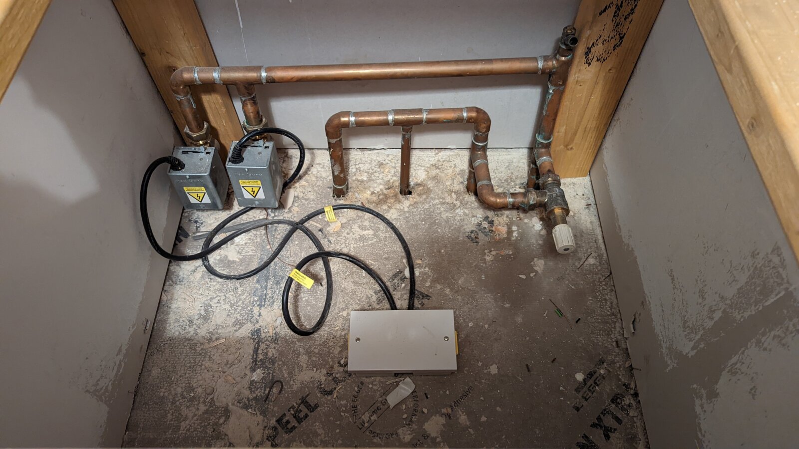

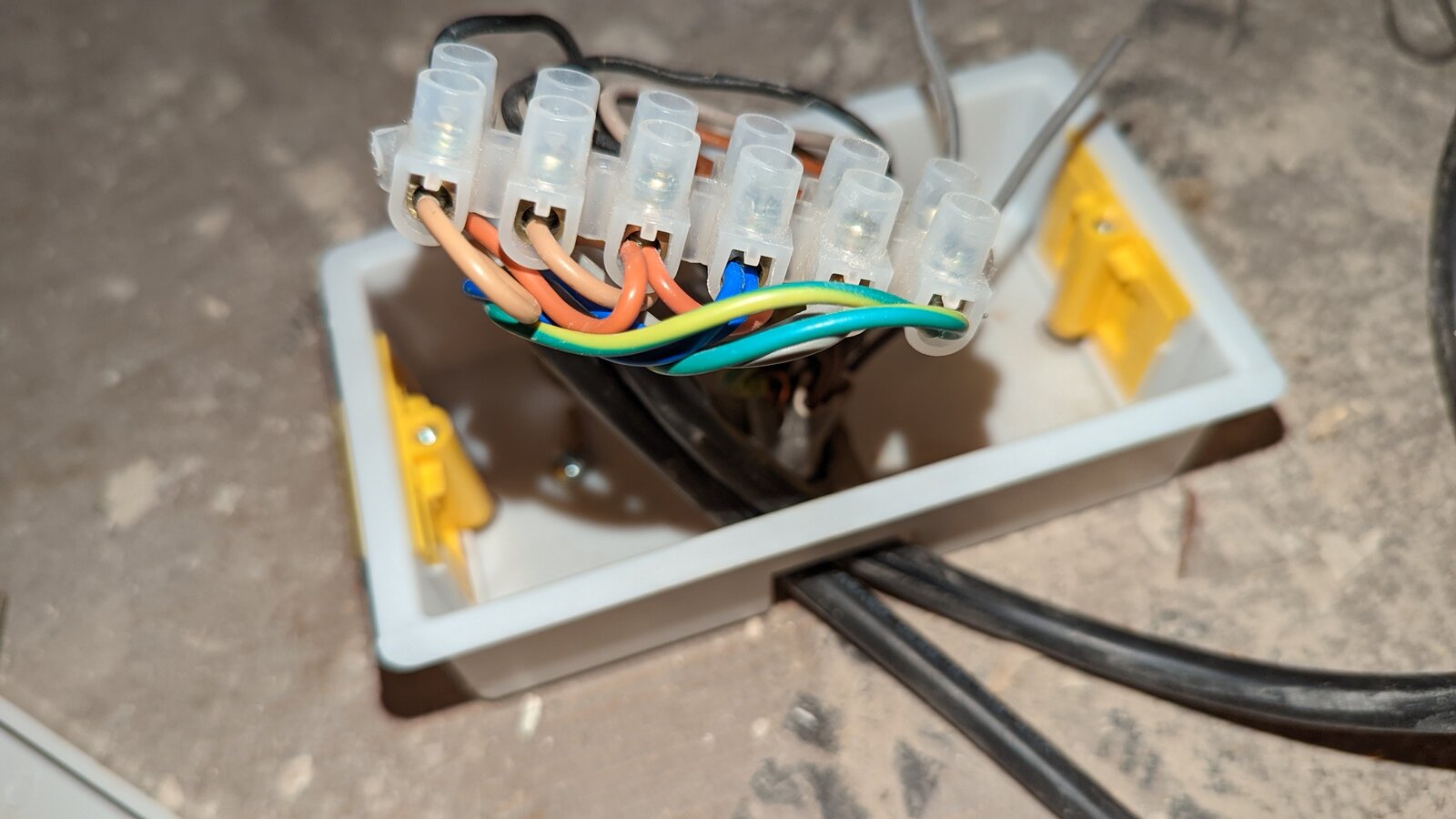

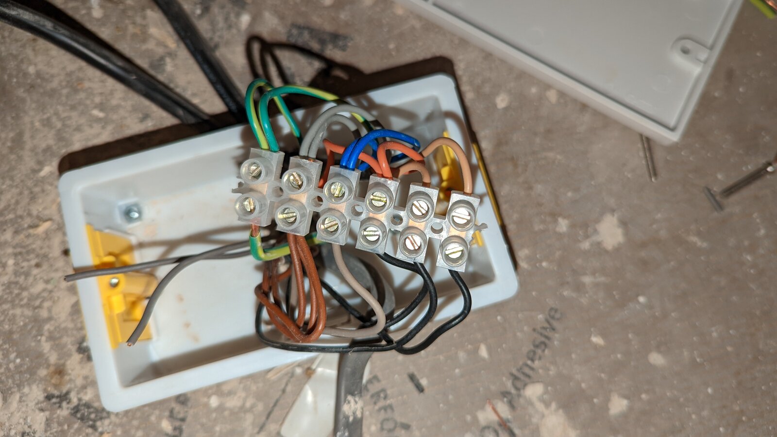

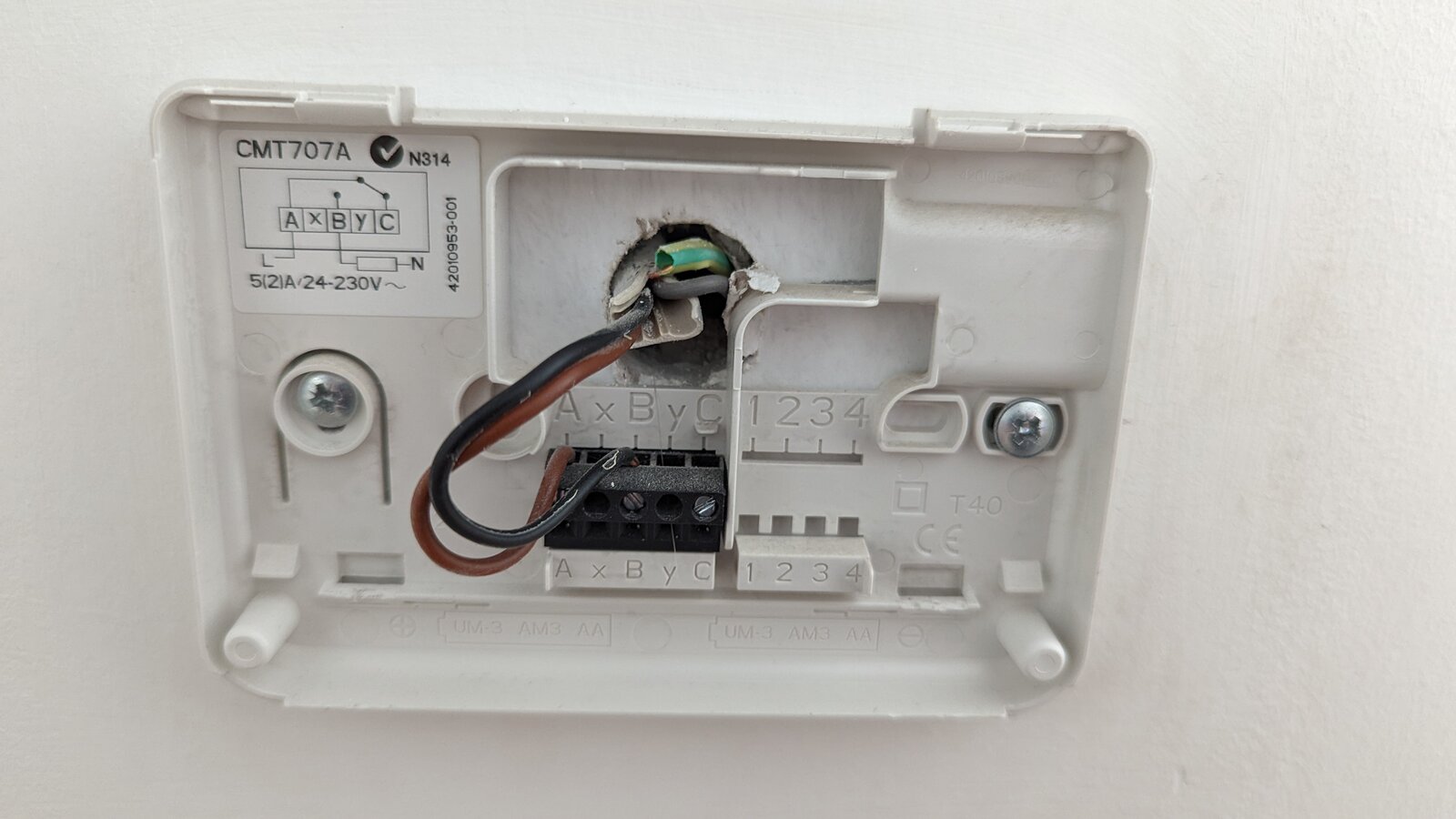

Thanks so much for your help so far. I'm pretty confident when it comes to giving it a go myself. When I get home I'll switch off the power and open the box. The Mrs was in the shower when I took the picture earlier.
Here is the box with the lid off. Not the nearest wiring I've ever seen.

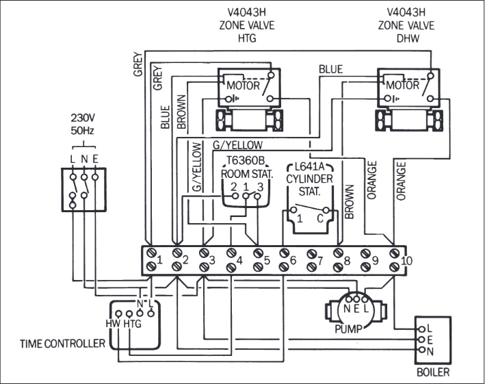

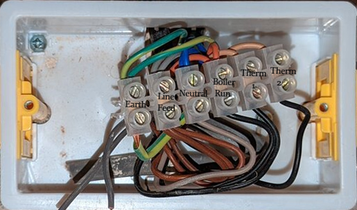

This is what I would think is the wiring, you will need a link line to 2, and 3 Nest will replace the blacks in Therm 1 and Therm 2, if you can work out which brown matches each black removed then that pair can be used for T1 and T2 to power wall thermostat.
Seems nice and easy.
View attachment 259533 This is what I would think is the wiring, you will need a link line to 2, and 3 Nest will replace the blacks in Therm 1 and Therm 2, if you can work out which brown matches each black removed then that pair can be used for T1 and T2 to power wall thermostat.
Wired exactly as you said. Seems to be working perfectly. Thank you for all your help!
