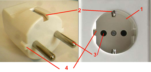

As to my comments about continental 2 pin plugs I was unaware of their earthing facility ... you are never too old to learn
Just one illustration, from Wikipedia (note the boits labelled "2") ...
Kind Regards, John

Thank you John, you have explained the situation without recourse to abuse, unlike someone else. I now understand, especially the 'drop dead tomorrow' as I hadn't considered that scenario !
At my age I cannot live with a twin & earth installation in confined spaces, so would running a separate single cable 'twix the earth connections (junction box & installed socket) be an acceptable solution ?
Thank you John for post #18.
I've often seen those features on a plug, but like many others I suspect not known their purpose
