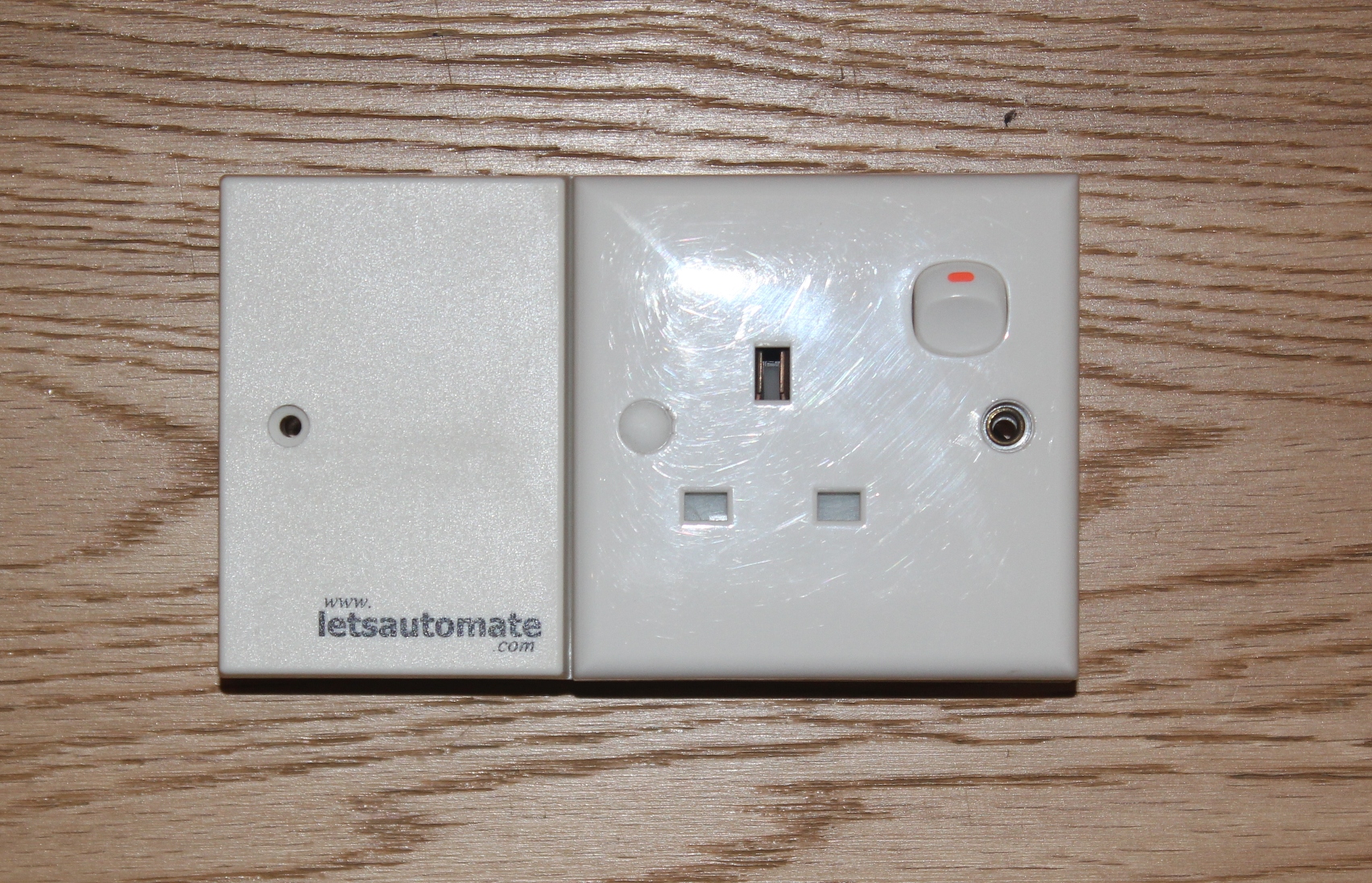

Just found this in my shed, think I may have originally obtained it at my Grandparents. May have also seen a similar socket in their shed.

Will try and grab some more examples of sockets and light swicthes.
Well that's not a standard socket! And I doubt it conforms. What do you do when about earthing the faceplate screws when you fit that to a dryline box?
And as has been covered, plastic switches don't have earth terminals. But I suppose if you're being anal, you could apply the same logic about those screws in a dryline box
Do you mean when fitting that (plastic) accessory to a (plastic) dry-lining box? If so, the need for earthing the faceplate screws wouldn't arise, would it?
