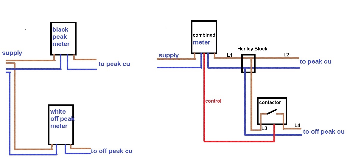

These days all 'off peak' is at the cheaper price and a contactor is, or can be, used to create the power which would have been provided by the white meter.

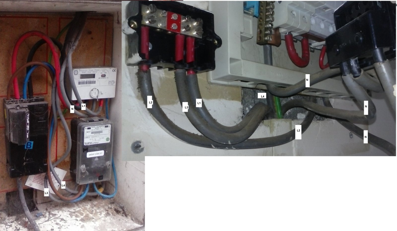

The only image I have available on this PC is not ideal but it may help, I have done a sketch which shows a comparison of this system and the white meter system with corresponding wire designations for explanation.
The control wire is the picture below is blue, the contactor is the clear lid with white labels.
As has already been said, the contactor is not essential to the operation of E7 tariff.View attachment 146164
I can't see what the contactor does in that drawing, apart from holding off the heater out of low peal times. Just a timer on the heaters would do.
The contactor control wire is operated by the grid's timer?

I can't see what the contactor does in that drawing.
It connects the supply (from the meter) to the off-peak CU (hence the storage heaters) only during the off-peak times of day.
Think of it just as a 'time-switch', with the actual 'time information' being provided by the meter.

So even if you have your heating off you are paying to open a contactor.
You are - but since the contactor uses so little power (in comparison with the heating) I suspect that you would struggle to actually notice the very little you would be paying.
A typical contactor coil for such use consumes 5W or less when energised. At 7 hours per day for 365 days per year, that would be about 12 kWh (maybe about £2) per year.
Kind regards, John
First the contactor is energised only during off peak. whether is costs the customer is dependant on the way it's set-up. if you look at the picture, the brown and blue tails from the cut-out are there for control and on the unmetered side. If a contactor were to be fitted in the flat, on the metered side, then the cost of operating it would be by the customer.

This would be at off peak time.
So they pay for the energy to open the contactor.
... whether is costs the customer is dependant on the way it's set-up. if you look at the picture, the brown and blue tails from the cut-out are there for control and on the unmetered side.
Yes, I'd overlooked the fact that the contactor might be activated by unmetered electricity (as used to be the case with time switches). However, as I recently wrote, even if the customer were paying, it would probably be no more than a couple of quid per year.

Indeed but it is not always like this. If the contactor were to be elsewhere in the system (several floors above the meter) which is fairly common for retro fitted systems it will be costing.
