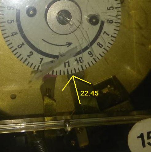

According to the picture you posted, it is different and that neon indicates it is set to 'timed'.

By my reading of the instructions, if the "timed" neon is on, it should supplying the lower immersion. If the "water heater off/timed" switch is moved to "off," I'd expect the "timed" neon to go out and (provided the lower immersion is working) the flashing light on the electricity meter should flash more slowly because the current reduces. The Horstmann timeclock has a 5-day reserve battery and continues to receive power even if water heater is set to "off"
According to the installation guide, the timeclock tappets are inside the cover and not adjustable from outside by the user.
Annoyingly, although the docref is the model shown, the picture seems to be of an earlier model. The document refers to "Regional Electricity Company" so is about 20 years out of date.
See http://horstmann.securemeters.com/files/7914/7487/2182/E7Q-User_GuideS.PDF
I haven't found instructions that show a timer like your picture - the same as Katy's - so don't know if they are the same.

TLC sell the later timer, and have that photo, but their library documents have the older picture, as does the Horstmann website.
Most likely it is the same mechanism.
The product name seems the same.

Looking at the photo in Katy Dibbern, Yesterday at 6:19 PM
the Timed neon is on. This makes me believe that the Horstmann would have been trying to energise the lower element; and if there is little hot water, there is a fault on it.
Perhaps the Boost still works (outside the Timed period).

I deduce that it didn't heat up overnight, so for one of various possible reasons, the bottom element isn't working.
Put the "boost" knob on during the day (it won't work during the hours the "timed" period is set).
Note that the knob is turned ANTI-clockwise, as shown on the arrow.
