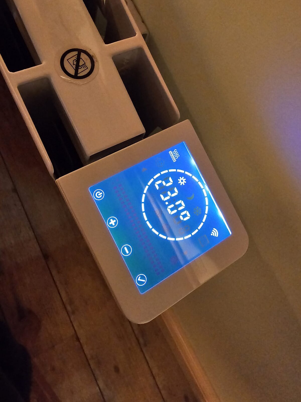

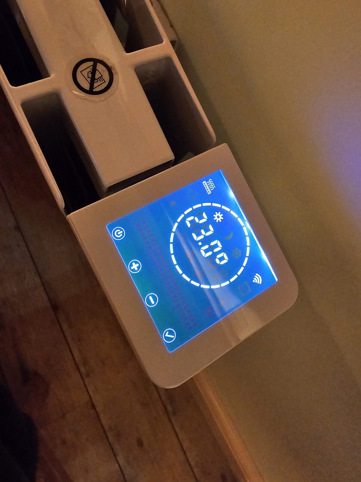

This is the rad I have and it is under guarantee still by 3 months (2 yr).
Everything is working as normal on the control screen. It is calling for heat and is not in any time off mode. The fuse board has not been tripped out. I have switched off for an hour and still no joy.
So it looks like the rad has died.
Does anyone have knowledge of these rads ? Are they reliable or not ?
I will speak to the help team on Monday about it, but I thought I would try get some info about them on here.
This is the control panel on the rad
If it is anything like the old electric panel heaters, and you have been airing or drying clothes on it, the overheat stat might have tripped.
It will be the electronics. Either the relay or the circuit which drives the relay.
Manufacturers locating electronic devices at the top of a heating appliance will always result in failure.

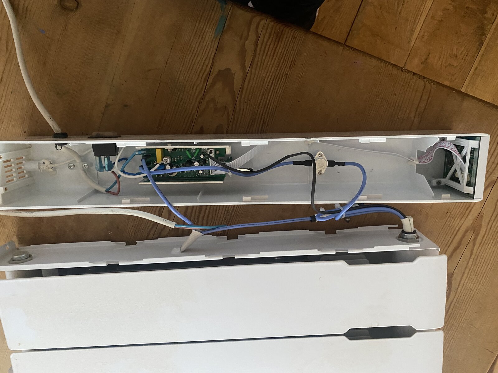

So I have three of these units in my small flat. 2 have now failed and are out of warranty. they've hardly been used and look like new. Did you find anyone that would consider repairing them?
