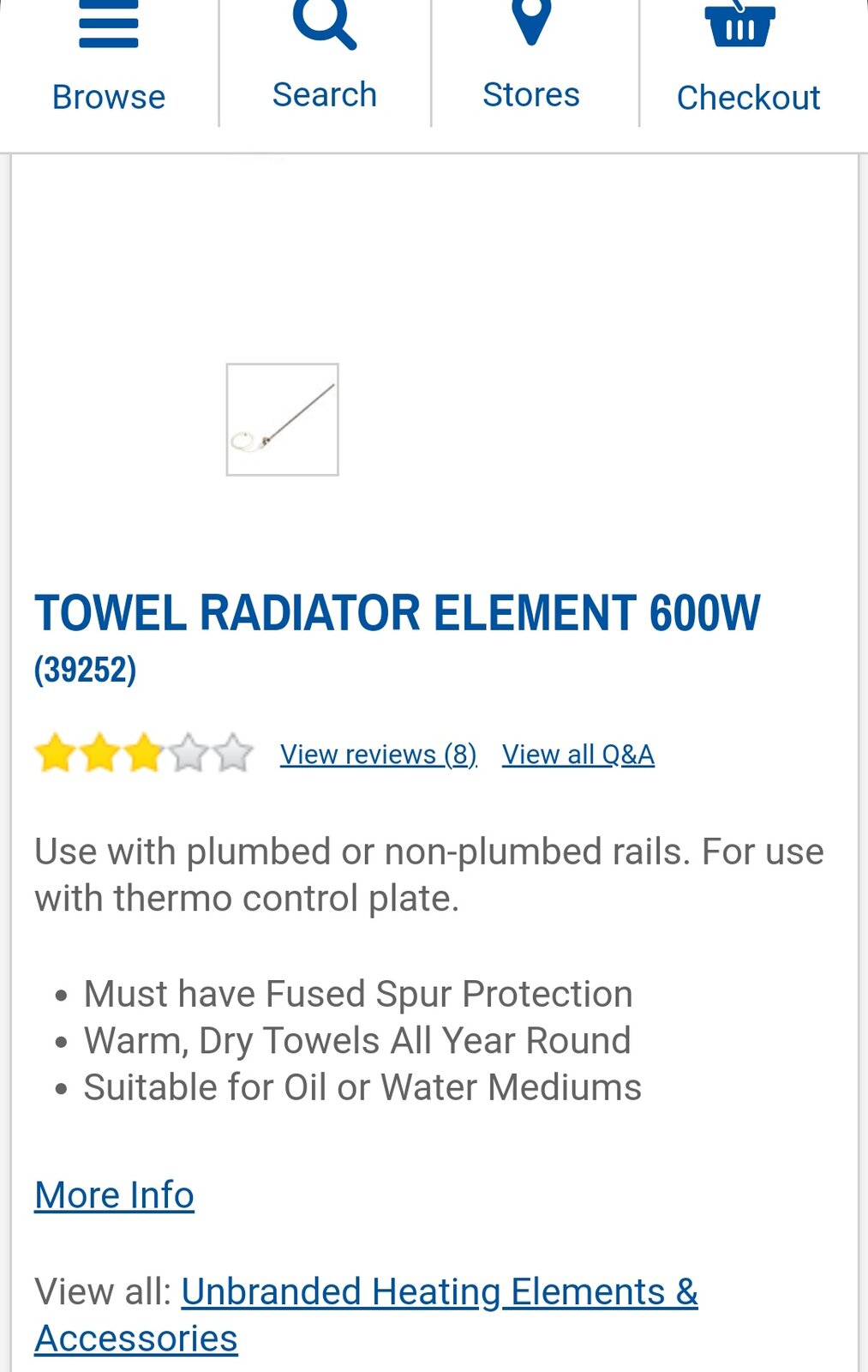

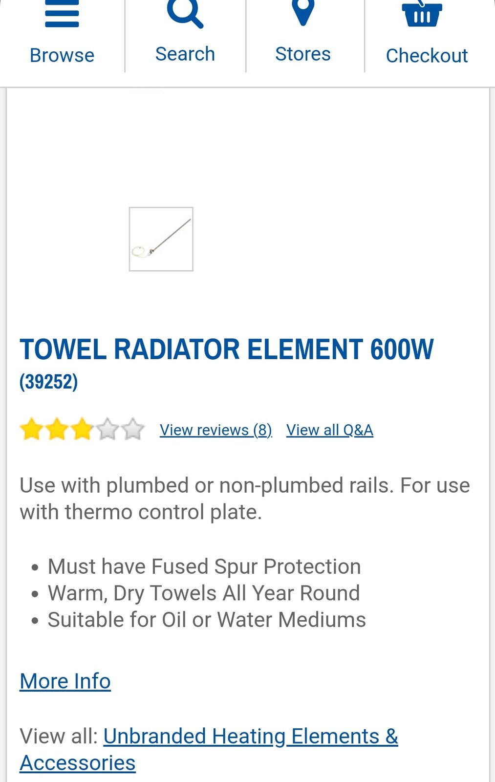

So many suppliers saying having to be wired to a fused spur. Example attached
Thanks to you all for your help and advice, really appreciated.
That is because the product is described as for a towel radiator. These are used in bathrooms. Sockets not permitted in bathrooms, but fused spurs can be ( depending on location).
But it is just an electric element not a radiator. So surely can be fitted to any radiator and doesn't have to be a towel radiator or placed in a bathroom?
Yes. But the makers envisage they will be mostly used in radiators in a bathroom. That’s why they are described
Towel Radiator Element!
