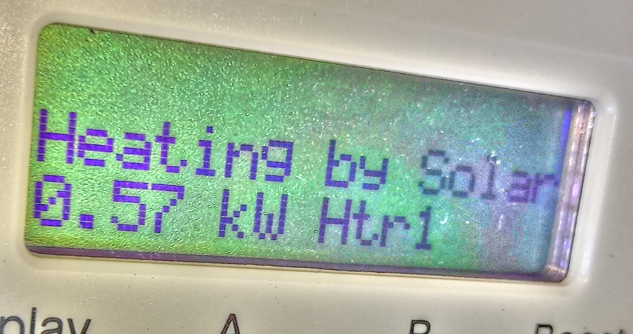

I am sure like many others I assumed heating the DHW would cost a lot with electric, our tank has just the spray on ½ inch of foam they have come with for years, on fitting solar panels I also fitted a device which can use the spare solar, and it has a display Iboost small_tonemapped.jpg the result was realty a surprise, no where near the cost I had assumed was needed to heat my domestic hot water, only used in summer so can't show you a result today, but from memory a weeks DHW heating was around 3 kWh so around £1.

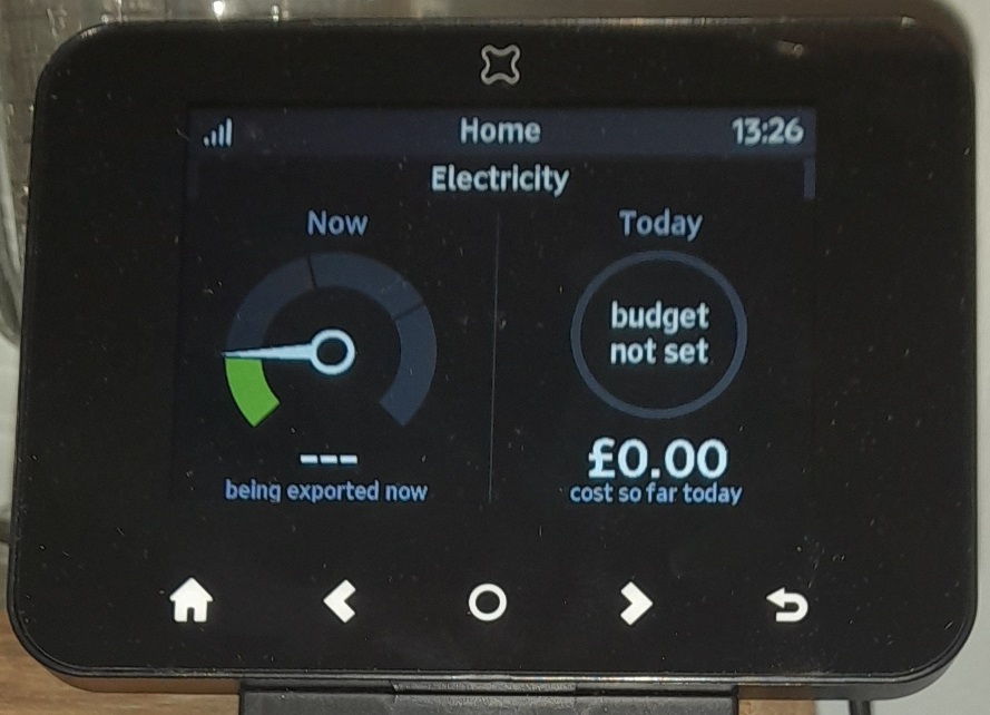

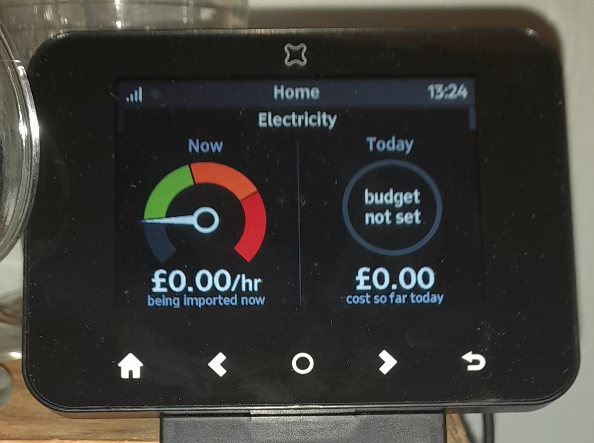

If you look at a freezer it gives Annual Consumption example 200 - 299 kWh this is for a 200 - 299 litres freezer, as it ages it will use more, and the annual consumption is likely over what is stated, so lets for ease say 365 kWh is still not enough to be worth renewing, but 730 kWh is way over, so we measure a days usage, as it happens testing one of mine 1735220598435.png OK my tester is connected to the PC, but it shows me 9.3 kWh for 26 days, so maths shows me 9.3/26x365 = 130 kWh per annum, so well within limits, the IHD (in home display) we get with a smart meter to me is useless, it swaps between Monitor import.jpg and Monitor export 1.jpg all day, as my solar and batteries take care of my daily load, but for those without solar and batteries I am sure it can help.
