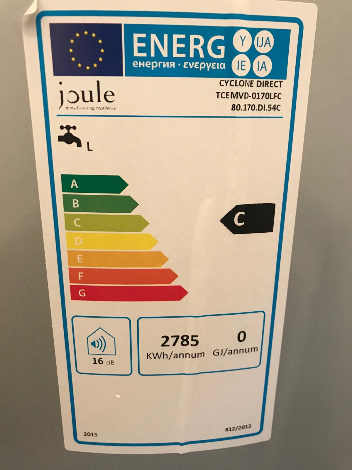

We have a 175l Joule unvented cylinder with a aqua system.( Attached pics with both specs)

We’ve recently moved in a new building- all electric. ..... 2785 kWh/annum
Where did that figure come from?
Forget the house heating and cooking for a moment. I don't know how much hot water you use but, by my reckoning, to heat a (140 litre) tank of water each day from, say 18°C to 62°C would, alone, use roughly that amount of energy (I make it 2,623 kWh/year, ignoring losses).
Kind Regards, John
The figure is written on it and confirmed with a member from Joule team.
Regards,
Andrei S.
Are you talking just about the water heating? If so then, as my calculation demonstrates, that figure seems to be in the right ball park (and is what one would expect of any electrical water heating - since the laws of physics are always the same!).
However, when BAS wrote "This place is going to cost a fortune to run.", I presume that he was referring to the total cost of running your 'all electric' house, not just the water heating, which is presumably but a small part of the total electrical energy consumption.
