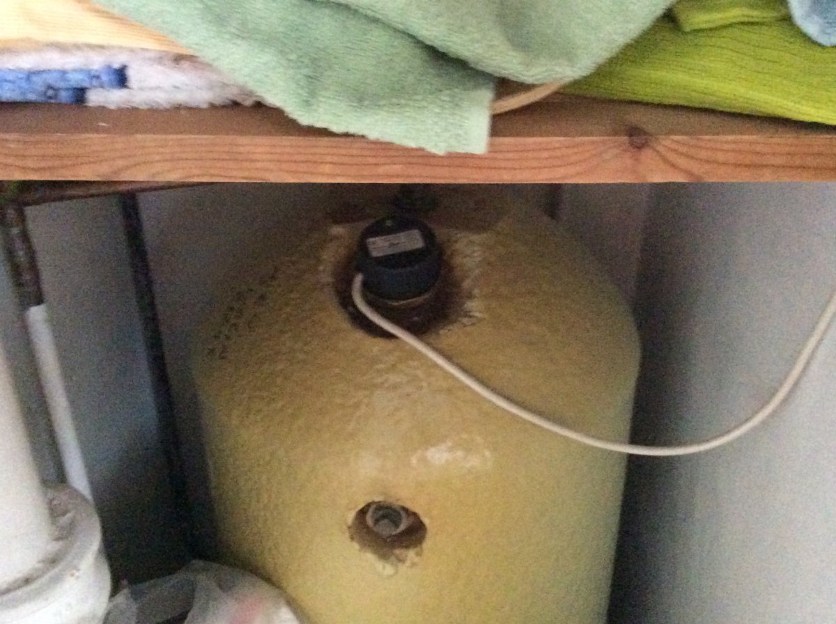

I am using a huge amount of electricity overnight. Presumably because the immersion heater is on all night. Only alternative is to turn it off and then have no hot water in the morning.

Let's see a photo of the immersion heater cap. Is the hot water boiling in the morning?

Not sure if I can get any more in the picture due to door on the pantry cupboard but I'll try later.

It will not be the hot water cylinder unless the immersion thermostat has failed and it is boiling.
That immersion heater has a thermostat. Can you send me a cheque?
