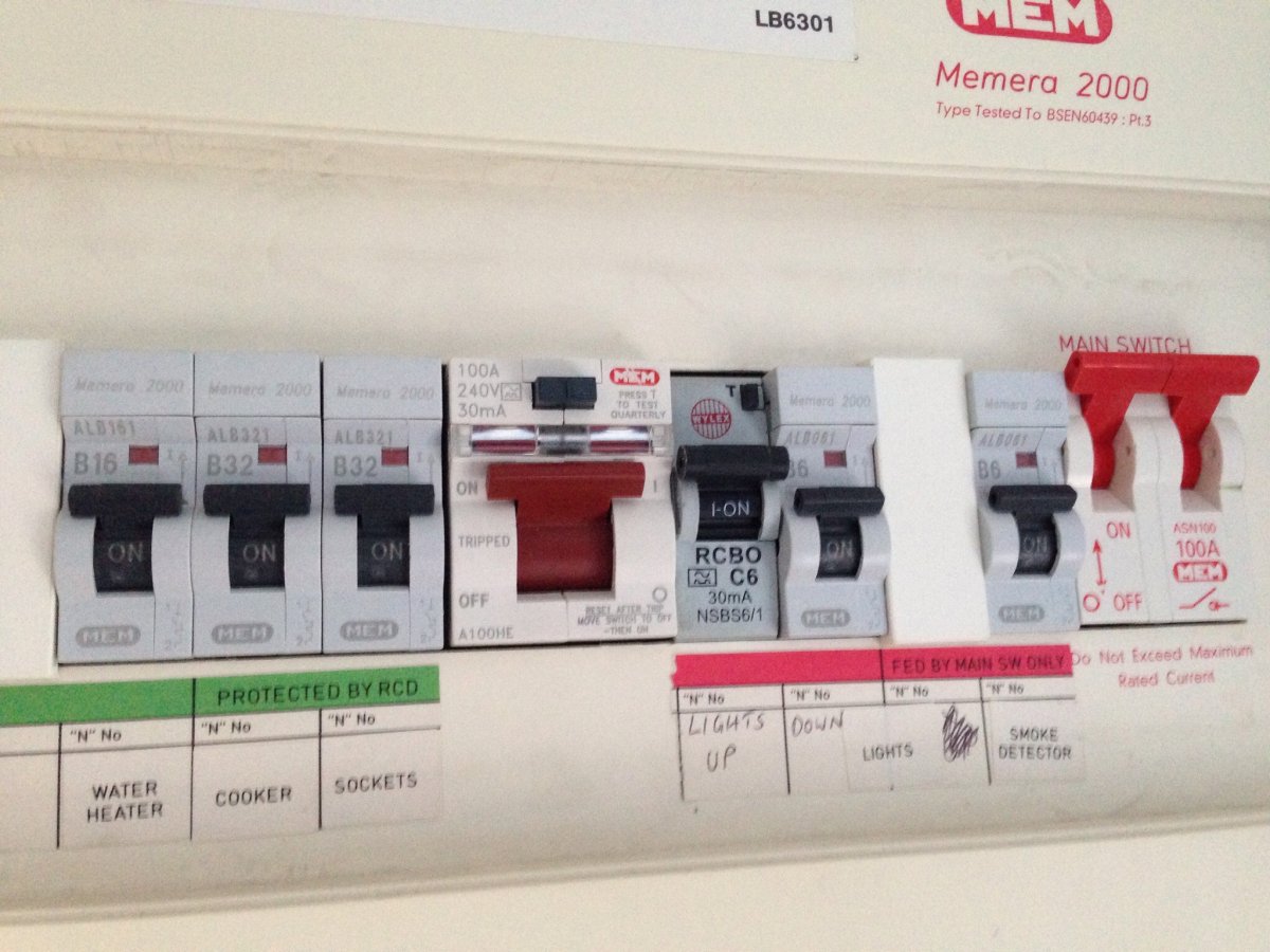

What does this 'main switch' look like - what is written on it, and does it have a 'test button'. A photo, were that possible, would help.

Hi John, I'm not at home at the moment, but can take a photo later if that helps? I just think of it as the master switch in the middle? It has 3 positions - on (up), tripped (middle) and off (down). Yes, it has a 'test' button above it.
Sorry, I know my explanations are a bit rubbish....
All of the other switches are smaller and are just 'on' or 'off', but have labels underneath saying what they are for eg Cooker
That's an RCD.

Fair enough. That's probably an RCD, being used as the 'main switch'. Do I take it that there is just one of those, and that it switches off all the circuits? A photo would certainly confirm things for us.

I'll definitely post a picture as I'm trying to recall exactly what it looked like. There is only one of these switches (but there were two red switches on the RHS?) I was going to say it turns everything else off, but now I think about it, although it turned the TV, kettle, cooker etc off, the lights were still on?

Traditionally lights were not put on the RCD, so what you describe is perfectly to be expected.
As requested, this is my unit. It was the red switch in the middle which 'tripped'. Many thanks
Thanks - as expected then, an RCD. In that case, your mum's over-enthusiastic cleaning could well have caused it to trip - so good luck with the 'drying out'!
